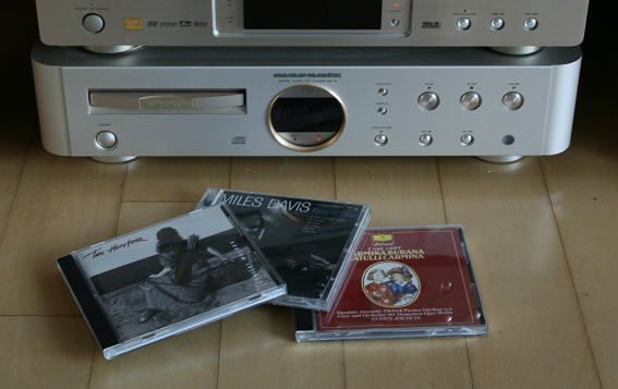

Before I want to see Papa's diy power amps,
here is the music source.
I always turn off the display window light of the cd player
because I get more focused edges of the sounds.
And, here are music CDs that I want to listen:
- jenifer warnes, The Hunter
- Miles Davis, Kind of Blue
- Carl Orff, Carmina Burana

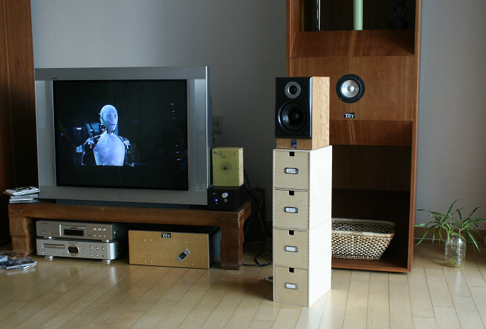

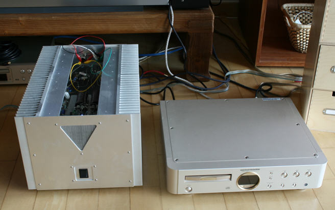

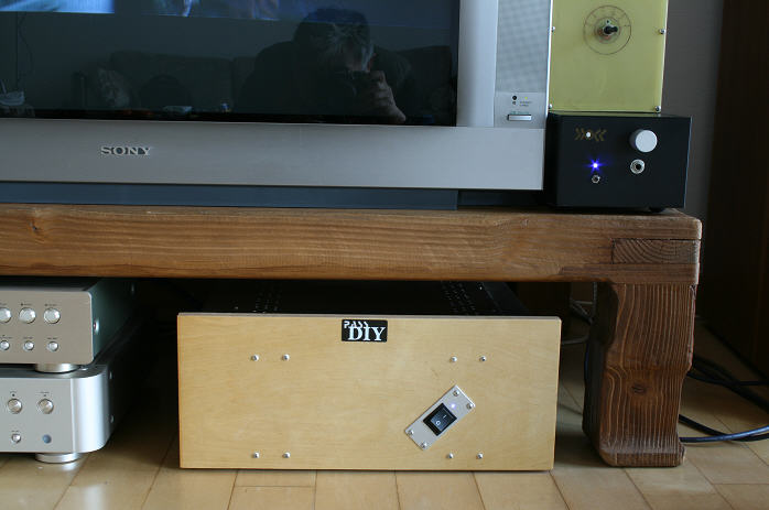

Babo Zen (Papa's Zen5 with input jfets) is connected to the
babies for the first trial. First impression of the sound is that the
size of the babies is small, but the size of sound is big.
I have two differently characterised headphones:
Alessandro (Grado Labs) and Sennheiser HD600.
The sound of the babies has the character of Alessandro.
I could't have serious listening yet. Instead, we tried sound tracks
of DVDs, iRobot, and Lost, first season, episodes 1-4.
Wow! The bass sound is very tight and go down deeply.
The bass sound is much deeper than I expected.
DH (my 1st son) says that the sound is very natural, and
nice.
I biased Babo Zen with about 1.3A, and I expect that its damping
factor must be inbetween 8-20 (I will measure this tomorrow).
Volume knob of the pre was 1/3rd up during the watching the
DVDs. I tried the volume more up without feeling any distortion
of the babies . . . Babo Zen empowers the babies very well.
I don't feel any lack of power.
From the photo, you can see my pre and Babo Zen . . .

The photo shows X-Zen V2. I am listening not with the balanced
input, but with the unbalanced RCA input . . .
