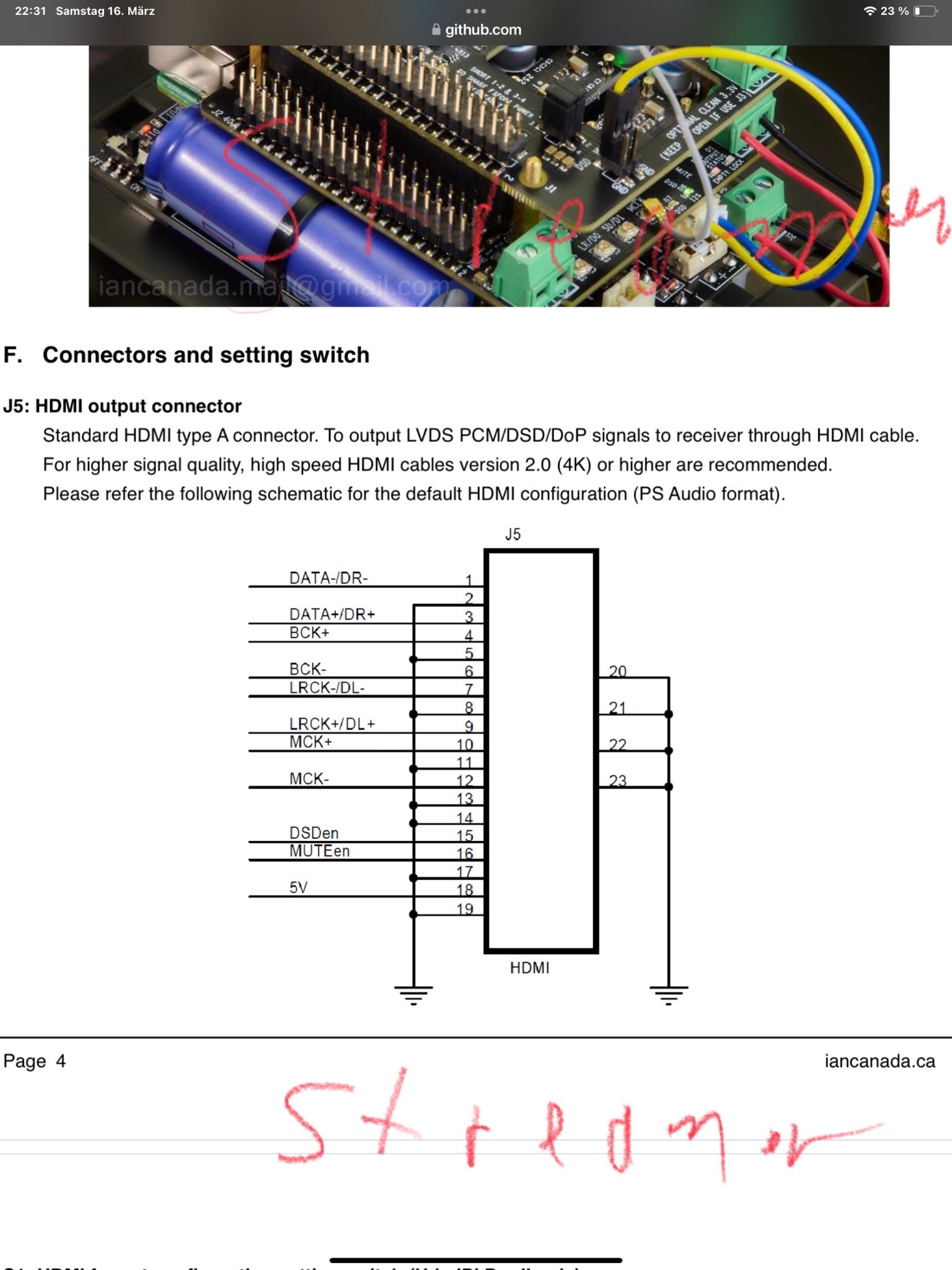

@iancanada any idea if this is possible?5v 3,3v PurePi 1, isolatorPI II and FifoPi Ma.
according to the manual, the isolator must be in master mode, the FifoPi Ma jumpers (on) J4 1-2 and 3-4 to share Paspberry Pi power, in this way the isolator II does not need to have power on J1 5/6 volts.
is it possible to supply the isolator II with 5 volts J1 (or 3.3v) by not connecting the jumpers J4 1-2 and 3-4 of the FifoPi Ma?
ps, I also use the 3.3v clean side FifoPi Ma.

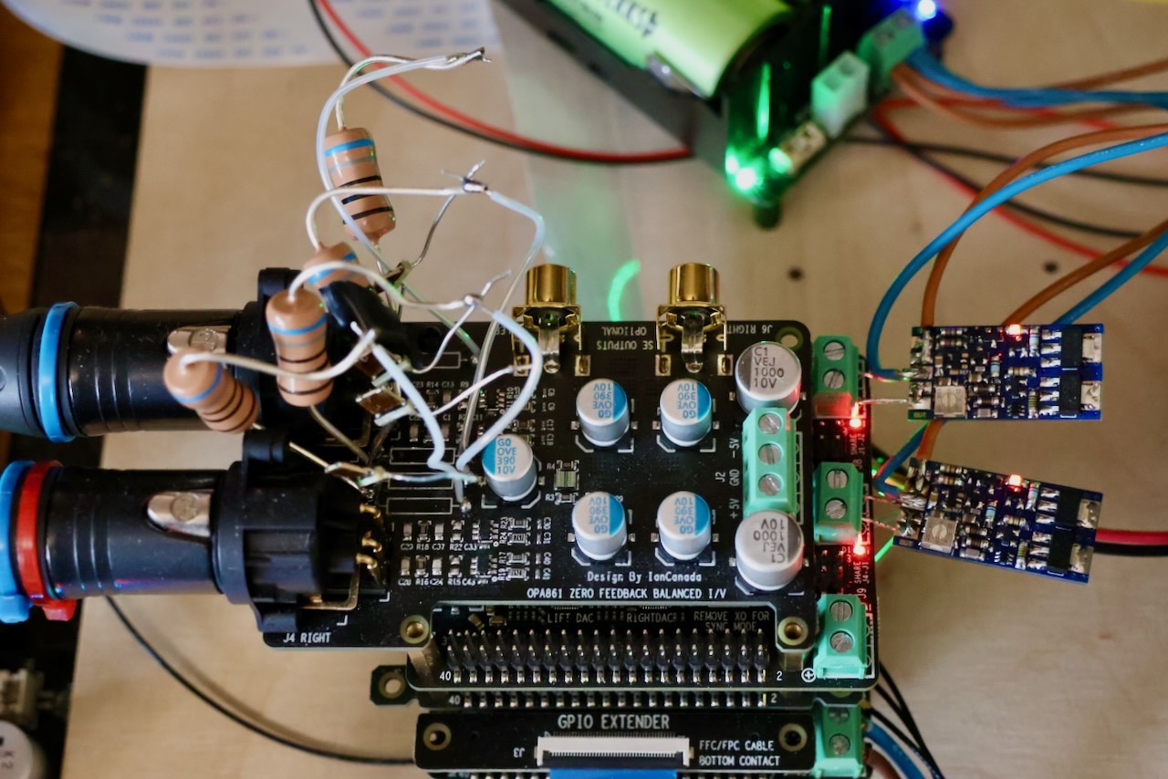

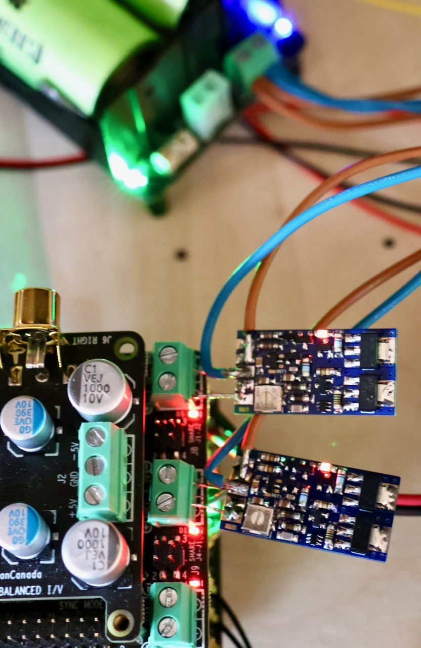

I would like to share my new experience. Untill now I used one UcPure to power both FiFoPi Q7 and DualMono Dac. Yesterday I have provided a separate power supply to DualMono DAC so UcPure only powers FiFoPi Q7 with SC-Pure clocks. This is an improvement. The sound is just more "cultural", like it became less harsh, more delicate.
The new power supply for DualMono is an experiment with LiFePo4 6,6v and two 3,3V discrete voltage regulators for AVCC and DVCC. The VCCA (J4/XO connector) is left without power supply. These regulators seem to work very well. They take very little place and let me isolate the noise between AVCC and DVCC.
The Dual mono on a PurePi Fifo Q7 is more refined but the Protodac sounds good can not beat that sound at the low price and simplicity maybe others that built both can voice their experience.@Gabster 2000 Would you consider the ProtoDAC instead of the "Dualmono DAC + OPA861" combo as another alternative on top of the FifoPi Q7?
I completely agree I share your opinion. The Dual mono on a PurePi Fifo Q7 is more refined but the Protodac sounds good can not beat that sound at the low price and simplicity maybe others that built both can voice their experience.@pkonstantinidis In my opinion ProtoDAC is not on the same level as Ian's Dualmono DAC + OPA861. I have a ProtoDac with Vishay TX2575 Metal Foil resistors for I/V, Jantzen Audio Superior Z-Cap as decupling output caps. In direct comparison to dualmono, it sounds worse. I would say "mudded". Still, a big surprise how it sounds, being so simple and cheap. Well, maybe not cheap anymore in my case because of Visahy and Jantzen, but I wanted to check if ProtoDac upgraded with better parts could replace Ian's Dac. And the answer for me is NO.
I am also curious what @Gabster 2000 thinks
As a ProtoDAC user, I am very happy with the sound I can ear. For sure, Dual DAC from Ian is a next step. Right now, the setup is :

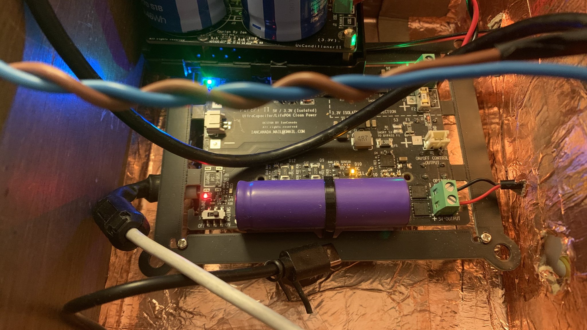

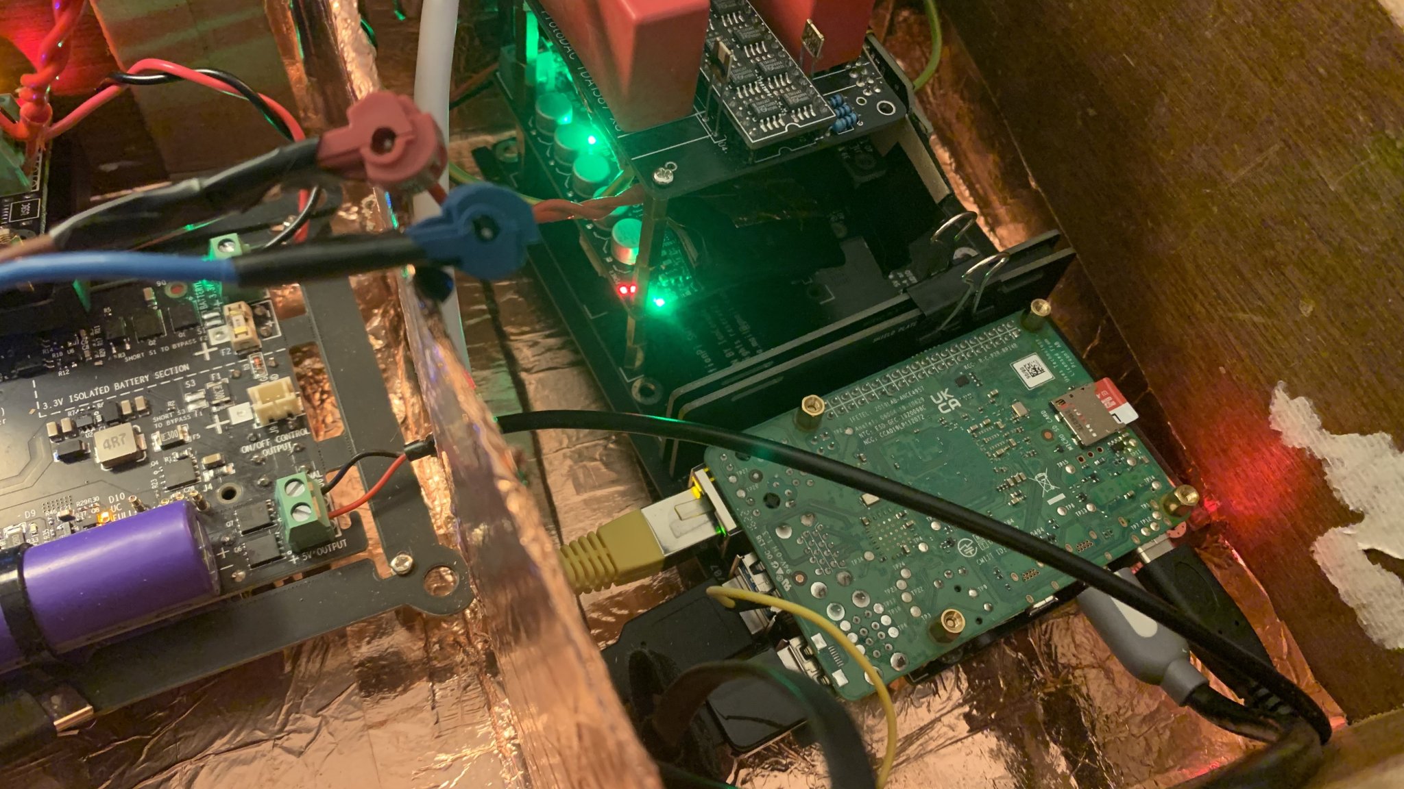

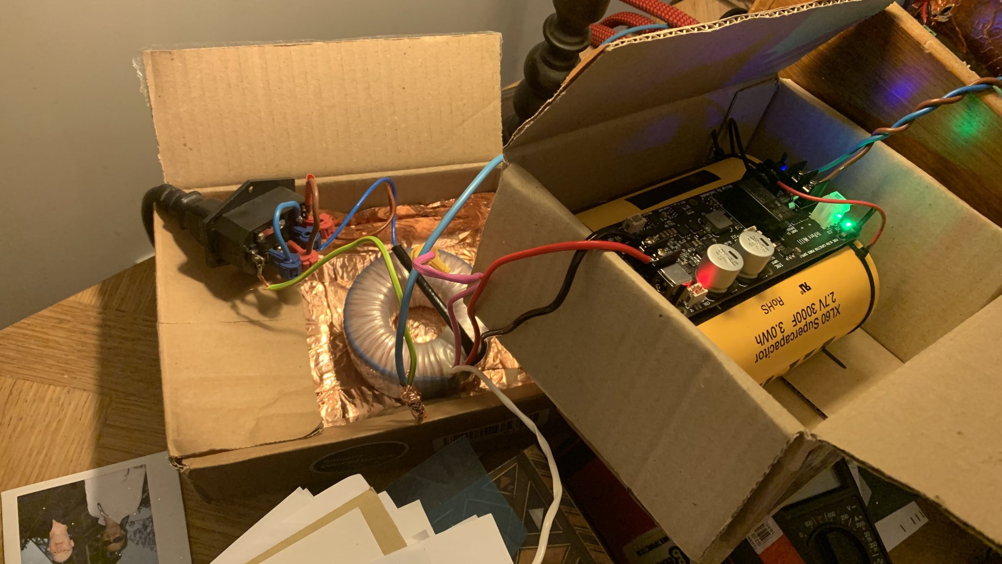

PurePi 5V UC to RPI (PurePi still powered with Apple charger)
PurePi LifePO4 with UCconditionner 3.3V to Q7 clean side (2 UC Pure have to be plugged)
Transformer to UcPure 5V to power ProtoDAC
Next steps : Toroidy Transfo (x2) : 1 for UcPure to ProtoDAC and 1 for UCPure (x2) to PurePi

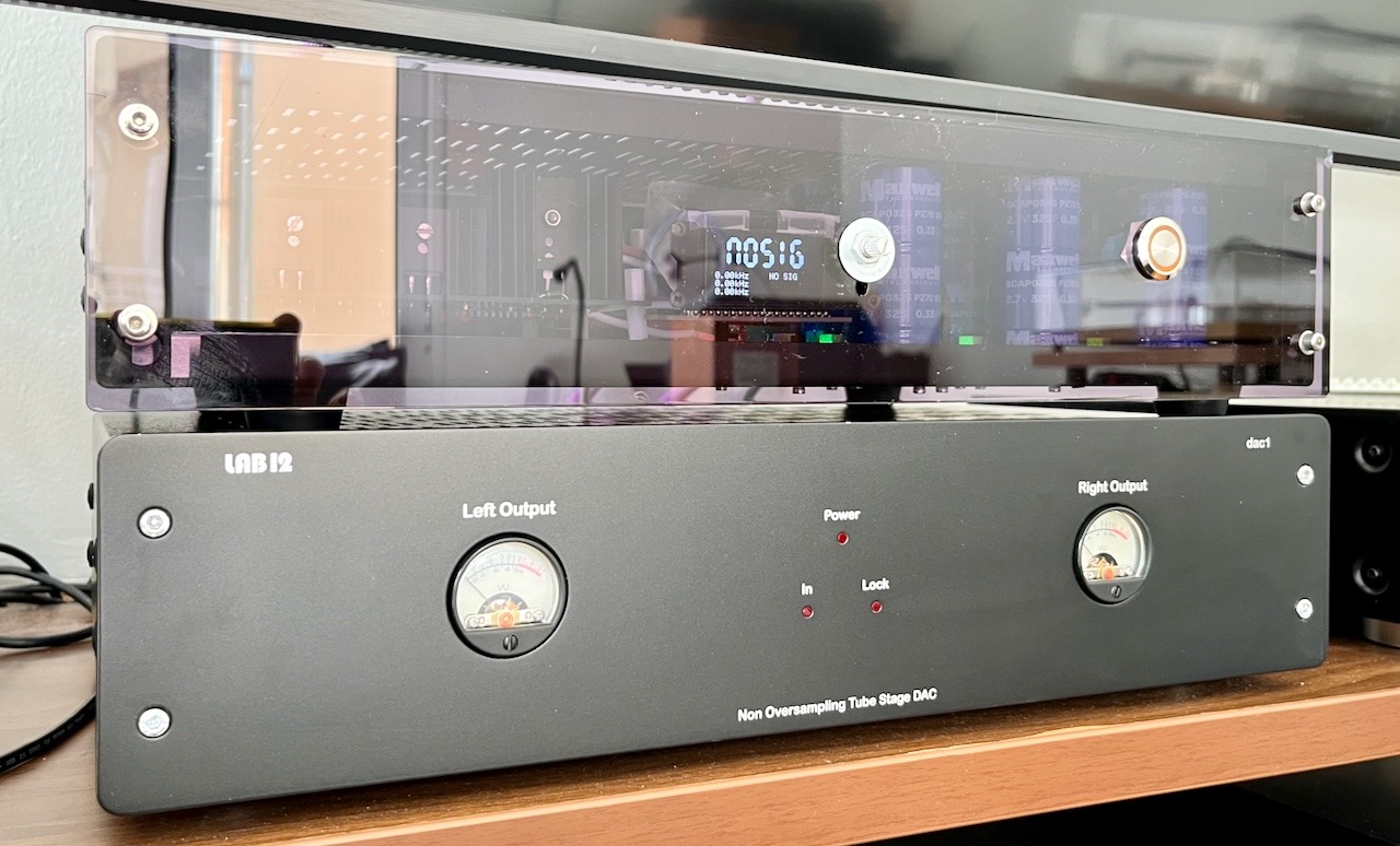

Looks great. I'm a big lab12 fan and almost bought the dac1 and didn't. I have a very nice DAC but I'm still finding I'm not getting the warmth I love...how would you rate the dac1?I wanted to be able to see the MonitorPi Pro and therefore I replaced the front face of my streamer case with a semi-transparent one. I then used the GPIO extension to move the MonitorPi Pro on the front face.
Now I can also see the various lights of the streamer internals like a Christmas tree -))). My previous, black front face was completely opaque.
I'm considering building a ank kit to get some tube and nos...or just buy the dac1
@Superchunk I happen to be friends with Stratos Vichos, the owner and chief designer of LAB12. I own quite a lot of his gear (DAC1 SE, Suono power amp, Gordian filter). And I have also heard some other Lab12, which Stratos has loaned me. All is great and a terrific value for money.
My DAC1 is the previous model. It sounds very, very… analogue. The newer model, the DAC1 Reference, sounds even better (I’ve had it in my system for more than a week). I would doubt that a DIY tube DAC could beat the DAC1 Reference.
The combination of Ian’s streamer with the Lab12 DAC1 is sublime.
Stratos is a wonderful designer and I've been singing his praises all over the internet for years. I have the suono which I've added 10x the capacitance to, and the pre1 which I've recently replaced with an allnic, but I won't get rid of the pre1. It's with me for life just like the suono.
I'll probably just buy the dac1 reference...I think I need my digital front end to sound a little more analogue.

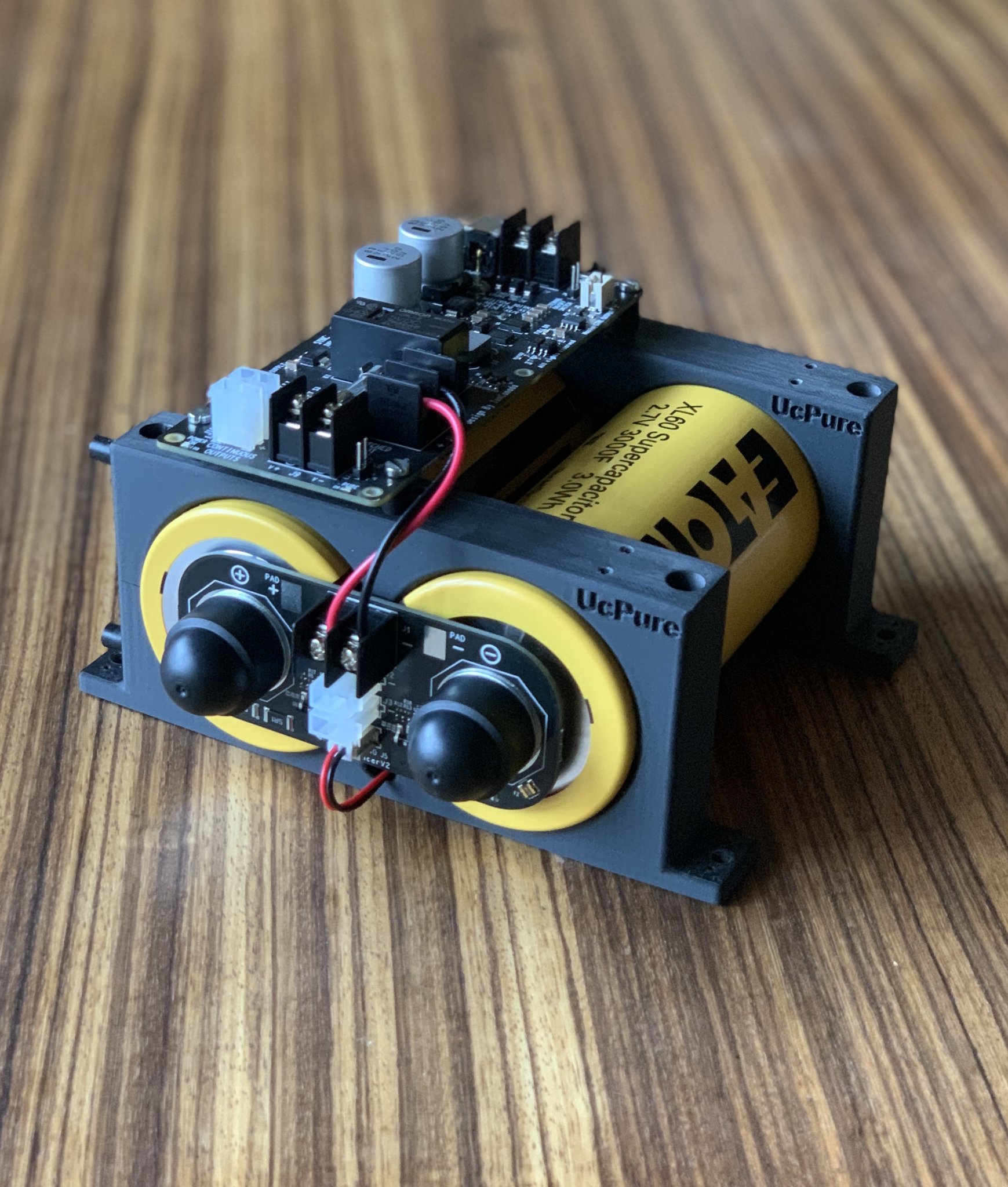

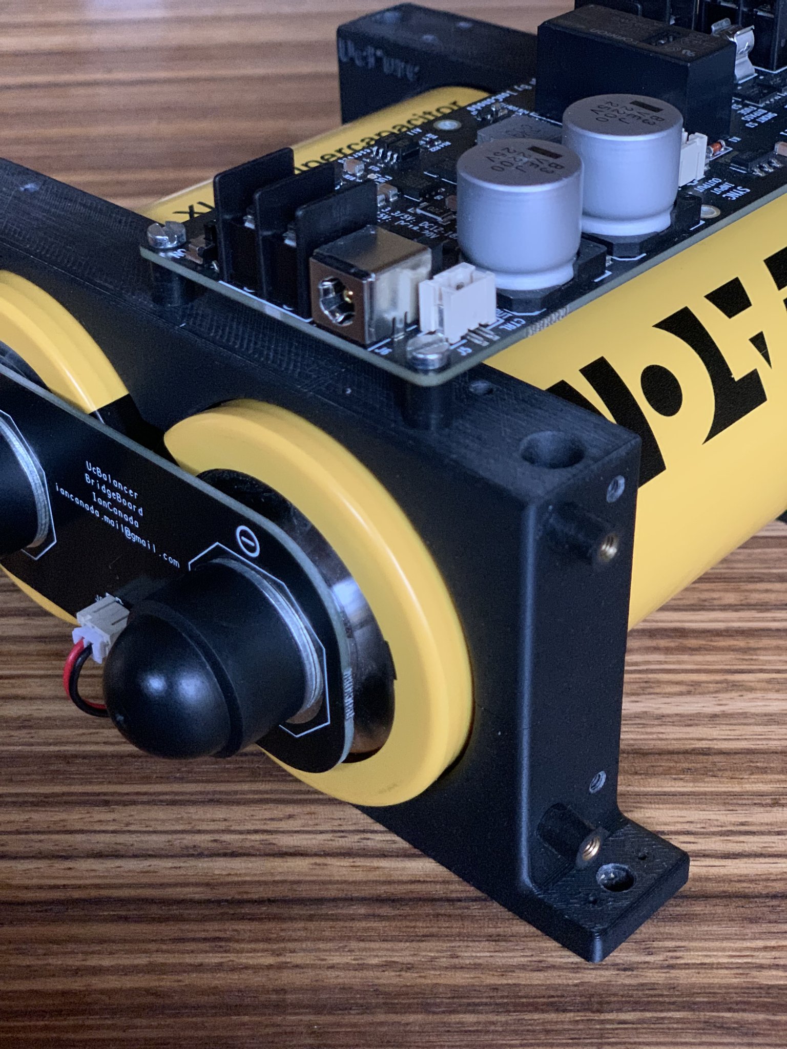

Hi @miklau, how is v 1.3 coming along?Finished version 1.2 of the UcPure holder. Small changes with a bigger base, larger flanges and holes for the wire to the balanced board were made. Not all was really necessary, so and updated and slightly narrowed V1.3 is in the making.
I am using some small M3 vibrating dampers under the PCB. M3 Dampers
They are actually really great and much softer than expected providing some movement and hopefully absorbs some vibration. Does it matter to improve SQ? Don’t know🙂
Still a great fit with 4 pieces for the UcPure.
I’ll expect to use them under my StationPi as well.
would you be open to making a pair for two UcPure 5v that I'm putting together?
As I'm new to this forum, I can't message you privately, so please pop me a message on this, if you're ok with it of course
Stefano
