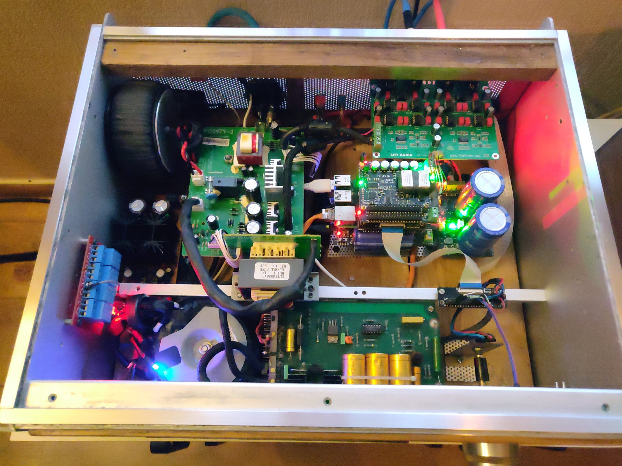

aluminum strips are ready and around it.
maybe shield the transformers once, it's fine for now.

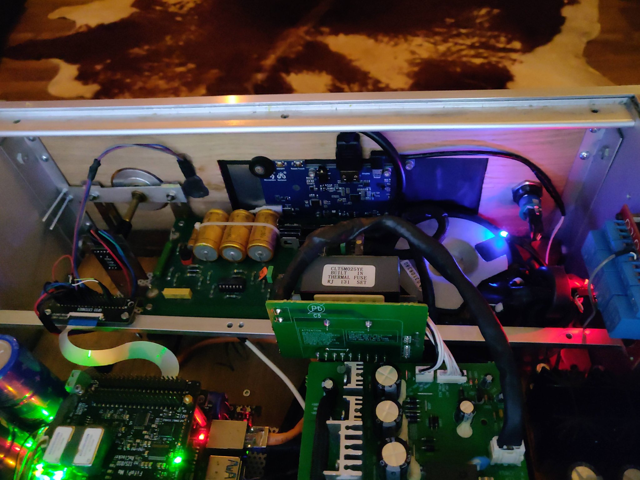

Just trying to remember your setup, but did you not use a 9v AC supply for your linearPi+UcCon. combo configured in 5V?
This voltage would easy my build because I then could use a single transformer, so just asking. Ian actually recommend 6v AC in the troubleshooting blog at his website.
@SimonJ Was it not you that have this experience regarding the use of 6v instead of 9v due to a blown fuse?
Anybody else had issues with blown fuses used with the 9v AC input?
Regards Mikkel
Regards Mikkel
Hi,Anybody else had issues with blown fuses used with the 9v AC input?
nope, 9V AC it works ok,
I have several LinearPi old and new MK2, and they have always worked on 9V with UcConditioners, never had a fuse blow.
I had an issue with a fuse blowing when the voltage was above 6V. The fuse would blow at the end of charging UcCond, and just after it turned the "conditioning" LED ON. Interestingly I have several such setups and the one that was generating the problem was LinearPi v1. The rest are LinearPi II and same as zabloc - no problem for several months.

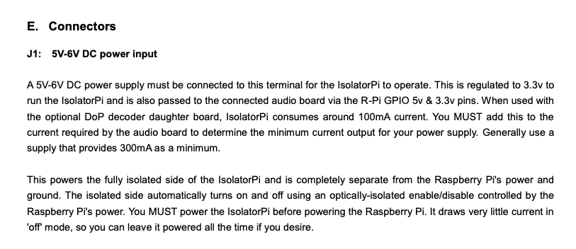

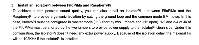

I hope I have clarified how my setup is. 😉
5v 3,3v PurePi 1, isolatorPI II and FifoPi Ma.
according to the manual, the isolator must be in master mode, the FifoPi Ma jumpers (on) J4 1-2 and 3-4 to share Paspberry Pi power, in this way the isolator II does not need to have power on J1 5/6 volts.
is it possible to supply the isolator II with 5 volts J1 (or 3.3v) by not connecting the jumpers J4 1-2 and 3-4 of the FifoPi Ma?
ps, I also use the 3.3v clean side FifoPi Ma.
