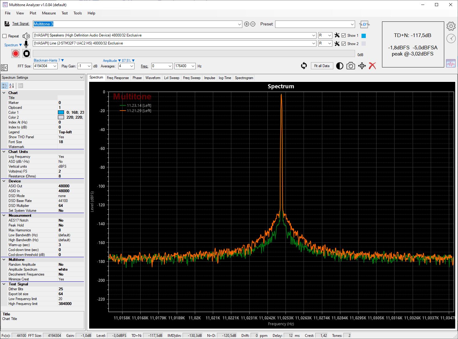

In measuring phase noise at DAC output ADC is the limitation. But even with existing ADCs it is possible to see differences in phase noise of DAC chips. Here is a measurement of AK4493 (green) and ES9038Q2M (orange) both using the same clock and having very similar Vref and output circuit. Note that the x-scale is +/-10Hz to visualize the difference. ADC in this case was ES9822PRO.

As I see it, it just showing THD+N mainly. Anyway of presenting the same way phase noise of clocks are done?In measuring phase noise at DAC output ADC is the limitation. But even with existing ADCs it is possible to see differences in phase noise of DAC chips. Here is a measurement of AK4493 (green) and ES9038Q2M (orange) both using the same clock and having very similar Vref and output circuit. Note that the x-scale is +/-10Hz to visualize the difference. ADC in this case was ES9822PRO.
Where do you see THD in that? The input signal is fs/4 (11025Hz) so 2nd harmonic is not exactly on that scale. It shows close-in phase noise which includes both phase modulated (mostly clock induced) and amplitude modulated noise (mostly from Vref). Why do you think clock noise would be any different?

Well, I am not really convinced by the diy measurement system that you have cobbled up. For all you know the USB side output is jittery to start with going into the DAC (how is the clock to this device?)
Show me a proper test using an instrument grade phase noise analyser like how clock tests are done. Unless otherwise advised I will be siding with those who have done listening tests. Anyone here found little or no benefits with upgrading to premium clocks?

If you believe there is something wrong with my measurement setup you are free to repeat the measurement using your own devices. Who knows, maybe they have less jitter. But proper instruments are of no use if you don't even understand what is being measured.Well, I am not really convinced by the diy measurement system that you have cobbled up. For all you know the USB side output is jittery to start with going into the DAC (how is the clock to this device?)

That type of power spectral measurement doesn't seem especially useful for explaining or correlating with stereo imaging. First off there are two channels, and the phase noise has an effect in the time domain with complex music signals. Why don't you demodulate the phase noise for each channel? That might actually be a start at finding a useful measurement.
