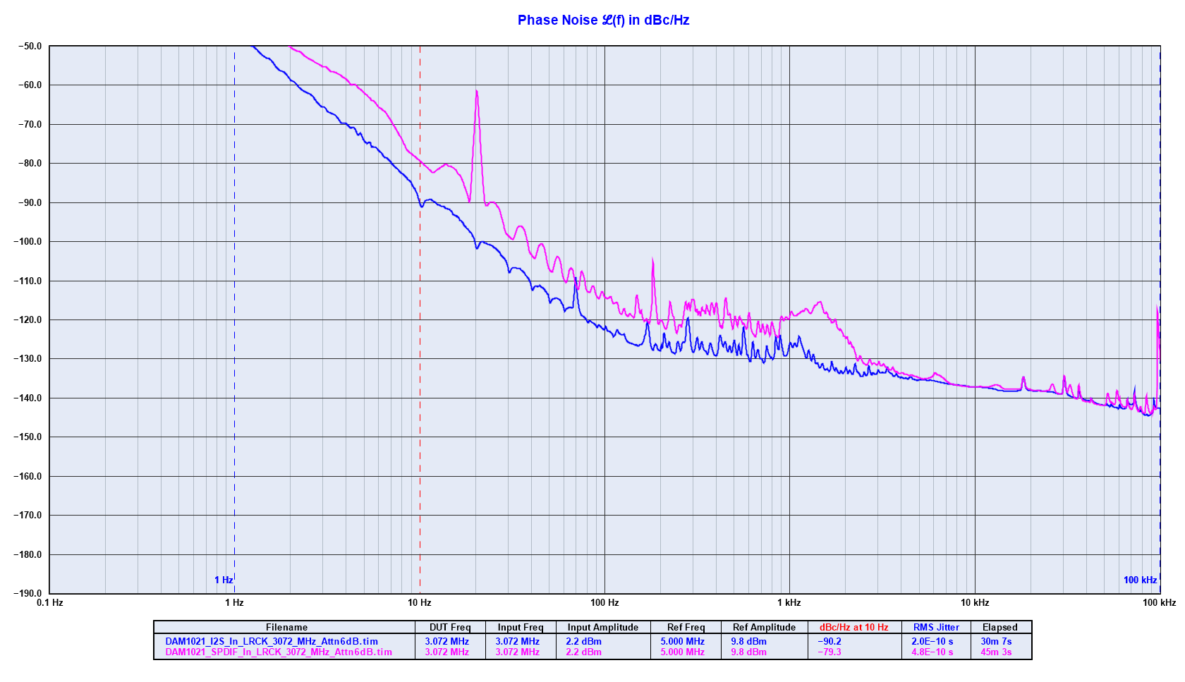

Just received another phase noise plot, this time described as, "phase noise of the LRCK signal of a DAM1021 DAC." Just a reminder that LRCK is the frame clock for PCM. For a NOS dac it is what clocks out the audio waveform.
May I politely correct your statement: NOS has nothing to do with LRCK clocking out the audio waveform. It is depending on DAC chip (or type).Just a reminder that LRCK is the frame clock for PCM. For a NOS dac it is what clocks out the audio waveform.
BTW these phase noise plots seem familiar. Are you sure you are not acting as a proxy to a banned member?Just received another phase noise plot
I post what I find interesting for the discussion at hand.
I will keep an open mind about this and investigate further, thank you for your efforts!If you believe there is something wrong with my measurement setup you are free to repeat the measurement using your own devices. Who knows, maybe they have less jitter. But proper instruments are of no use if you don't even understand what is being measured.
Please see page 15 of the attachment on phase noise....investigate further,...
The noise skirt measurement recently proffered shows the conflation of two types of noise as depicted in the frequency domain. How are the two sources being separated so we know how much of it is phase noise? Also, FFT is an integral transform. As such there is an averaging effect. Mere power spectra does not show us what phase noise is doing in the time domain exactly. Nor does it show us how phase noise is affecting the two channels that are required for production of the stereo illusion. Looking at conflated, averaged noise for one channel is meaningless relative to perception of imaging in the sound stage. Unless of course, someone would like to explain in detail how to correlate the two in a meaningful way.
Also, please see page 17 of Bob Adam's presentation. If we are talking about DSD vs PCM, then jitter/phase-noise has a different relative importance because of the step size.

As I said before the noise shown in my graph contains both phase modulated and amplitude modulated noise. These together are referred to as phase noise which may be quite confusing. Yes, amplitude modulated noise will most probably be dominant but that was my point. Clock induced phase modulated noise has less impact and according to studies amplitude modulated noise is more offendingTalked to a few RF testers here and they also agree FFT measurements to figure out phase noise performance are not reliable. Amplitude noise will mask or cause errors.

All this applies to clock phase noise measurements as well. However that is not even a measurement of what you actually hear when listening to dacs.Mere power spectra does not show us what phase noise is doing in the time domain exactly. Nor does it show us how phase noise is affecting the two channels that are required for production of the stereo illusion. Looking at conflated, averaged noise for one channel is meaningless relative to perception of imaging in the sound stage. Unless of course, someone would like to explain in detail how to correlate the two in a meaningful way.
e.g. if Fs is 44.1k pcm the why is LRCK (Input Freq) showing 3MHz instead for this test?Just received another phase noise plot, this time described as, "phase noise of the LRCK signal of a DAM1021 DAC." Just a reminder that LRCK is the frame clock for PCM. For a NOS dac it is what clocks out the audio waveform.
I stand corrected on how this particular dac works. IIUC it does upsample so that LRCK is roughly 2.8/3MHz. That is frame rate at which the data word changes.e.g. if Fs is 44.1k pcm the why is LRCK (Input Freq) showing 3MHz instead for this test?

Even with phase noise demodulator you cannot escape the fact that amplitude modulated noise is most probably dominating. And I seriously doubt demodulated phase noise of dac output would show anything close to the huge differences seen in clock phase noise measurements.
Audibility of clock phase noise at dac output is certainly questionable with even run-of-the-mill clocks and the law of diminishing returns applies here as well. Regarding your current hypothesis about soundstage effects there are various other sources for those as well. And I doubt many recording studios have SOA clocks for AD stage so according to your hypothesis the soundstage is already ruined at recording phase. Besides very few recordings have a proper soundstage to begin with. E.g. in classical music recordings close miking is often used which results in very strange effects such as high and low strings of solo violin having different location in soundstage.
There are amplitude demodulators and phase demodulators. They usually have some degree of rejection for the wrong type of modulation.
No, you misunderstood, but I'll rephrase my 1st sentence: Even with phase demodulator you cannot escape the fact that amplitude modulated noise is most probably dominating in phase noise.
In the time domain, phase noise is timing error. Amplitude noise is amplitude error. For amplitude to affect time, there has to be mode conversion?
