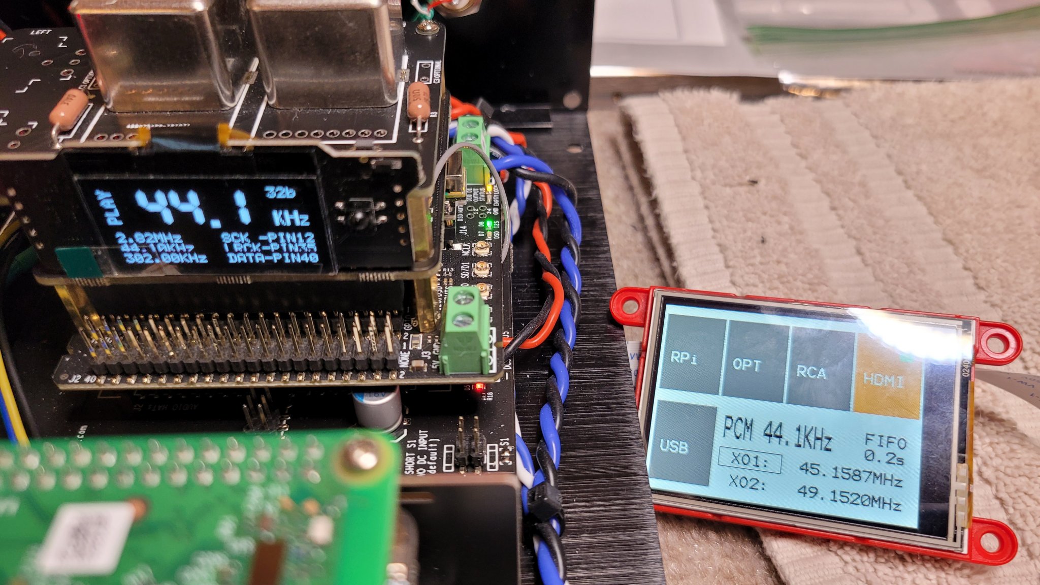

Ian,
I'm having a mild brain fart. Please remind me how to get the FiFo data to show up on the 4D Systems screen. I've had it working, but I've been doing so much testing and configuring on 2 different systems, that I've lost track of some basics. 🙂 (my older brain syndrome). I have the 4-pin control cable plugged together from the FifoPi Q7 to the StationPi Pro, and both ESS and MonitorPi installed. I thought that's what was needed.
Edit: If I remove the ESS Controller it shows, but then nothing plays.
Edit 2: The documentation (page 7) of the StationPi Pro shows it displayed. I'm assuming something was playing for that pic.

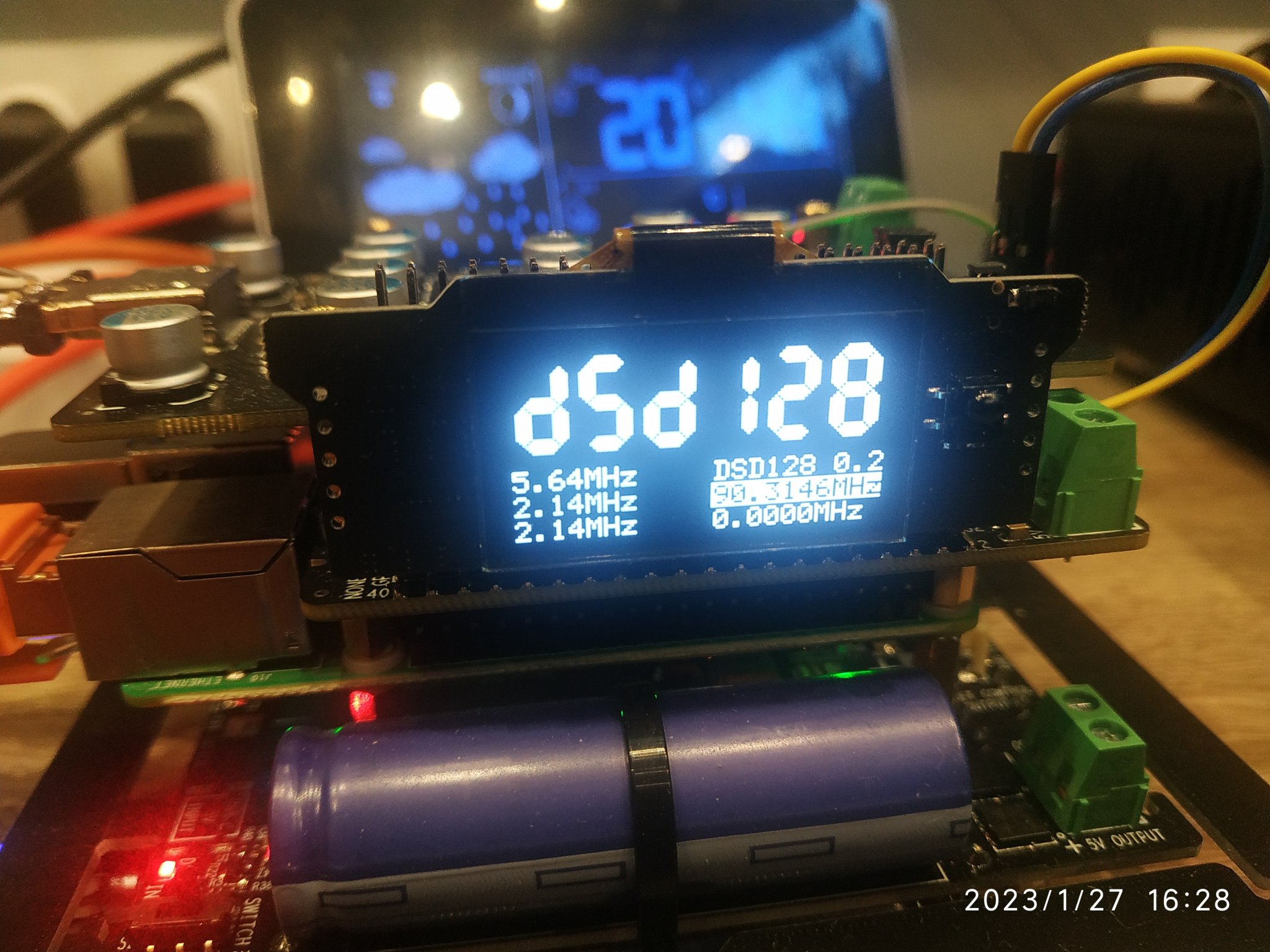

Dear Ian!

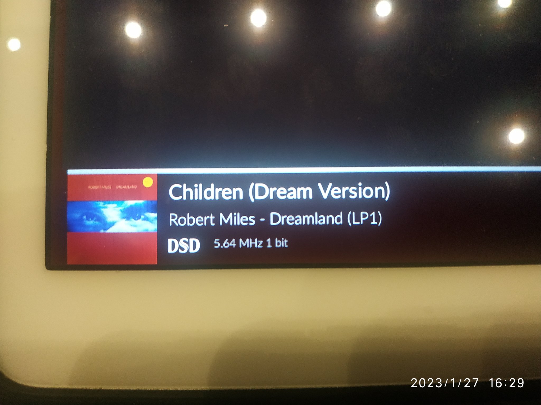

Thanks for the quick response. Unfortunately, it does not work at all with a normal straight HDMI cable. However, I missed the point in my previous post that when tested with the cross (1.3-7.9) cable, the DSD128 sounds perfectly when played with Volumio, only there is a problem when playing from Tidal. (I immediately changed the oscillators from the factory to 90 and 98 MHz Accusilicon oscillators when I bought the FiFoPi Q7/HdmiPiPro) It seems that there is only a problem below a certain quality or bitrate. Right now a Robert Miles (DSD128) album is playing perfectly as I write this 🙂

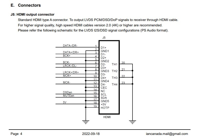

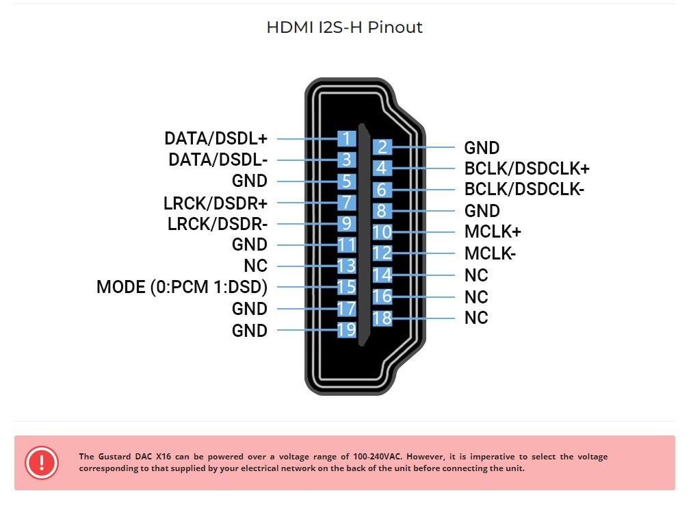

I forgot to attach the pin assignment of the I2S input of the Gustard X16 to the previous post (as well as the output of the HdmiPiPro).

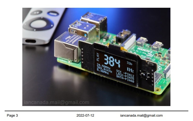

If I have one more question, it's in the MonitorPi manual
in one of the pictures you can see a remote control, is it an AppleTv remote control? In principle, the MonitorPi has an infrared receiver. Why? What can be said? Thank you in advance for your answer!

@maxximnode
Seems that the Gustard DAC doesn't compatible with PS audio I2S over HDMI format.
The problems are:
1. 1-3 Reversed
2. 7-9 Reversed
If the DAC isn't capable of setting the format, I would suggest you open a HDMI cable, and then to reverse the 4 wires. It's better than making a HDMI cable.
DSD left and right channels are also reversed, but there is no way to fix this issue by the HDMI cable. It's a design problem.
Many other DACs are working great with HdmiPiPro. Please read the user's manual for details.
https://github.com/iancanada/DocumentDownload/blob/master/HDMIpi/HdmiPiPro/HdmiPiProManual.pdf
