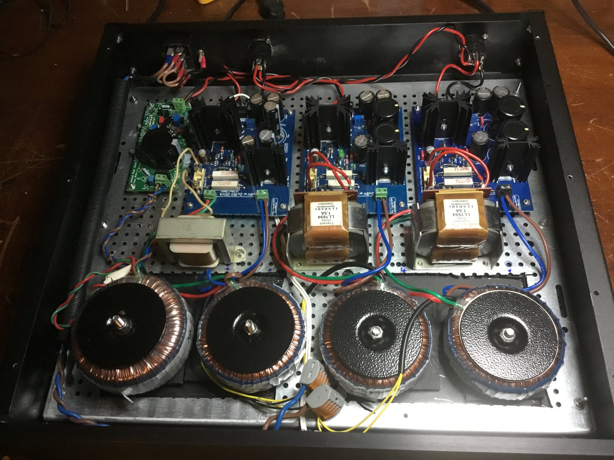

Thx, dddac it is, with four dac boards. Psu is from doede, with bigger trafos and chokes from Lundahl and Hammond.

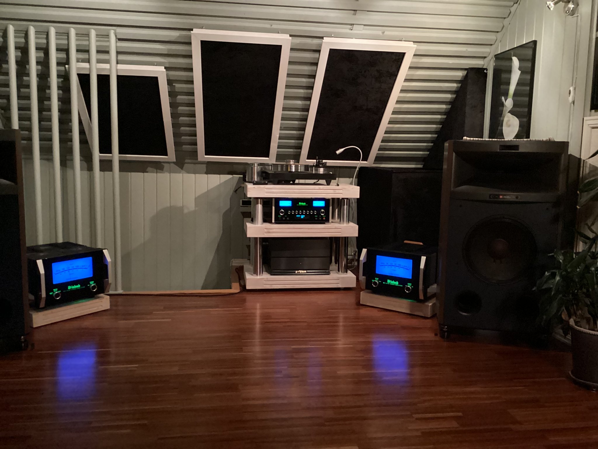

Not sure what you mean with «link the mc amps»? It’s two monoblocks ( 1.2kw) and Mc52 preamp.
Source is Aurender N100h, and diy turntable with Jelco 850L Mk-II.
Dddac psu on pic.

Love the big Mac’s. Have tried many amps, but theese are here to stay. They have full control over my jbl 4365’s, and I like to describe them as an iron fist in a cotton glove.
