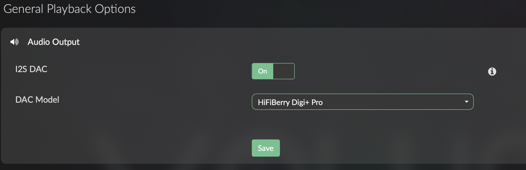

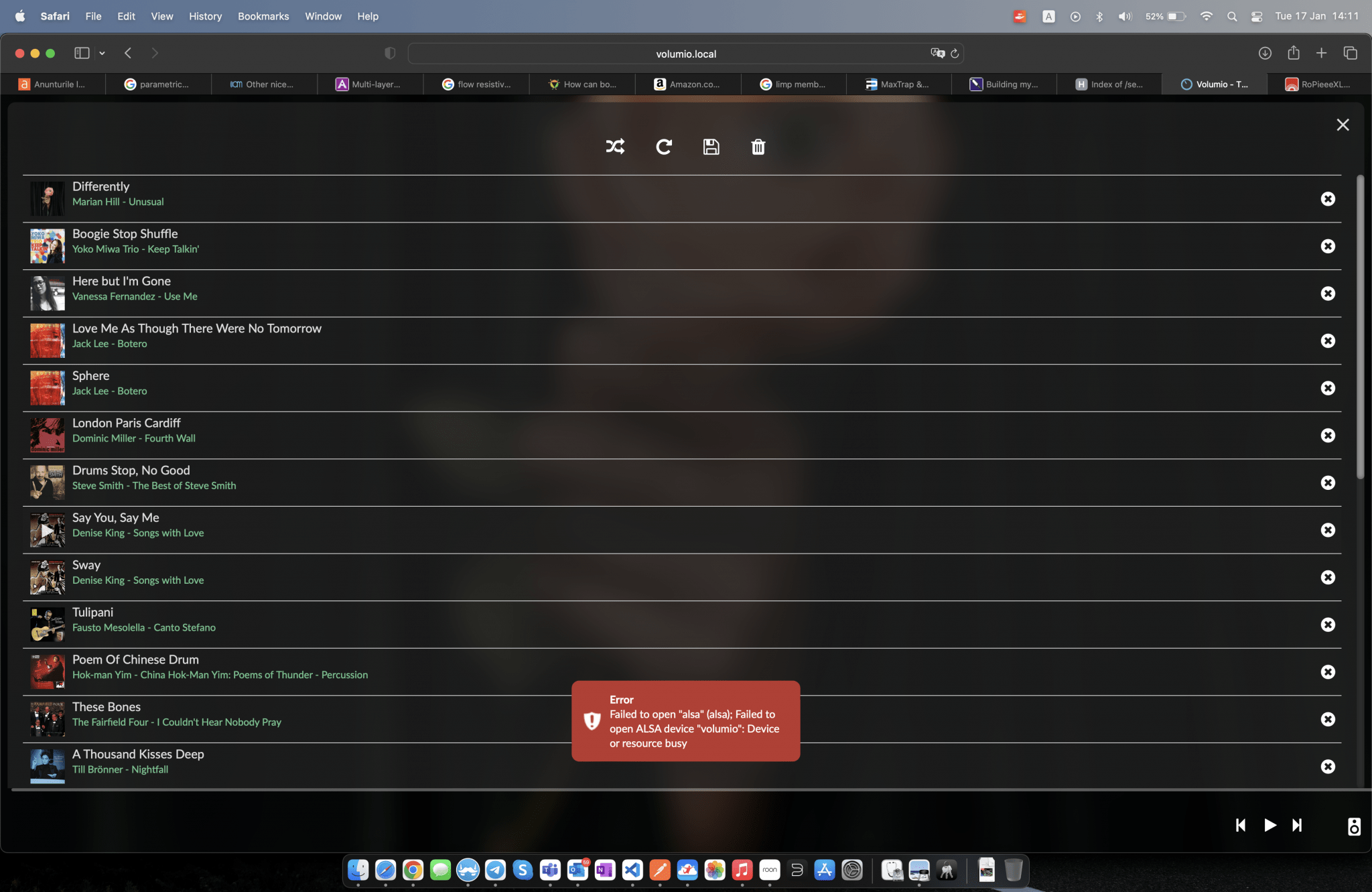

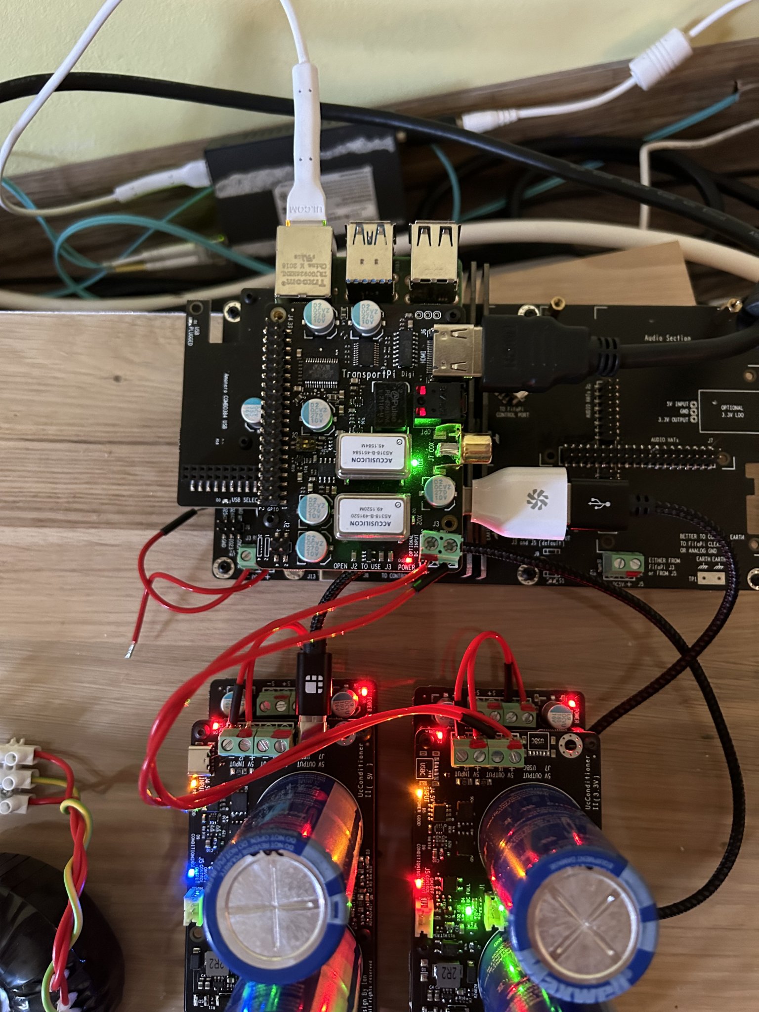

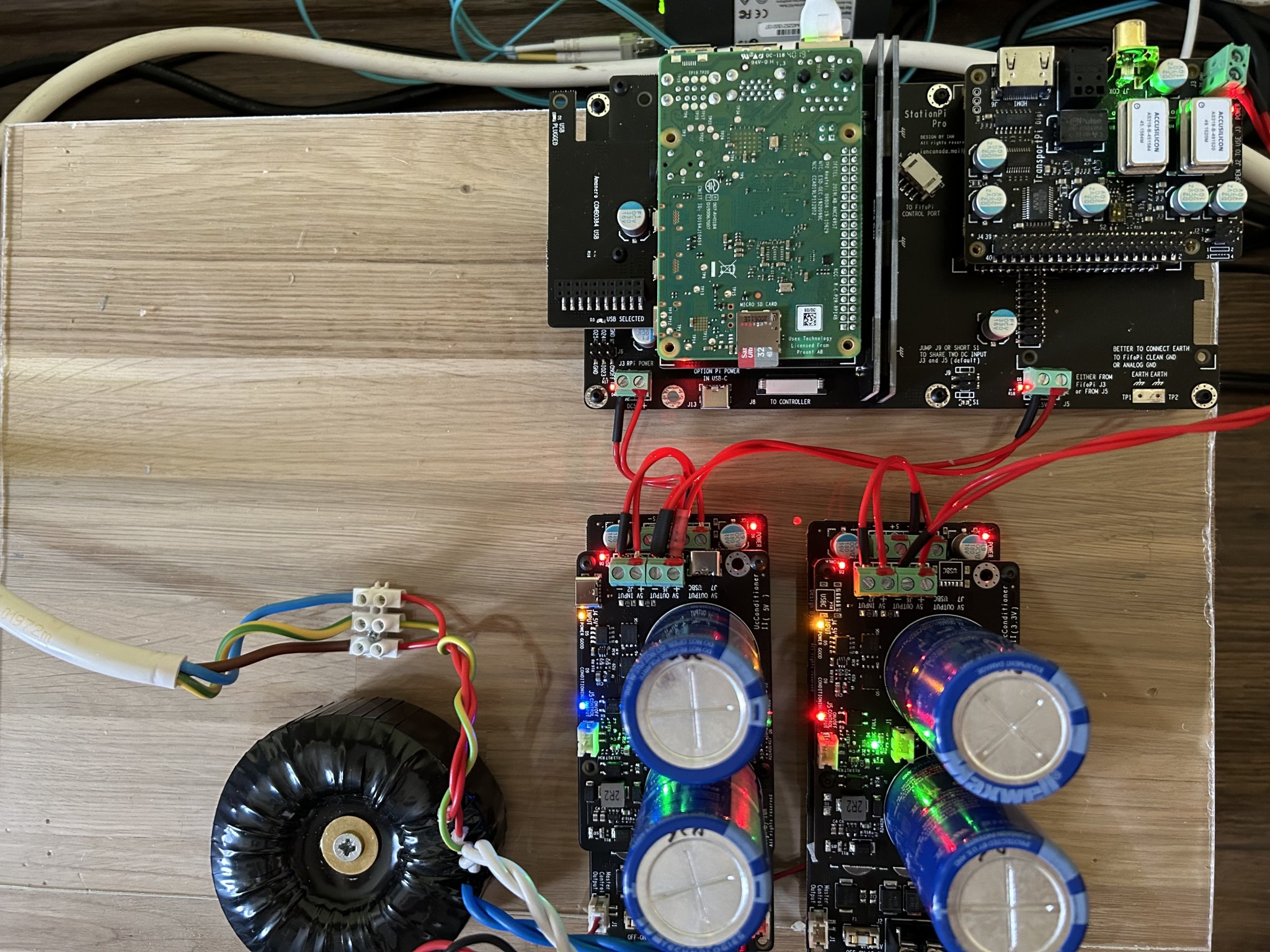

Hi Ian,
So I've tried with Volumio today and the behaviour of the hardware is the same as originally reported while using RoPieeeXL. Sometimes it gives an error (Failed to open ALSA device Volumio. Device or resource busy), other times it just doesn't do anything when I hit play. This is when the RPI and transport digi are mounted on the Station Pi. I've attached pictures to show the setup.
I've made sure the hat is inserted correctly in the GPIO port on the station and also that under the hat there is no accidental touch with the GPIO pins.
The audio output configuration was I2S enabled and selected HiFiBerry Digi+ Pro. I've also tried Generic I2S dac but still no luck (I thought who knows).
Reset to factory settings, flash the sd card again, reboots between changing settings and so on.
What I've also tried again is Volumio, RoPieeeXL and DietPi with the transport digi mounted on the RPI correctly. Everything works perfectly like this.
J14 on station pi has no jumper (default) as I only have RPI installed, on the daughter board.
I'm out of ideas.

@zangalucian
I see the issue and have a solution for you.
TransportPiDigi works in master mode, but StationPiPro works in SYNC mode (unless you remove the daughter board). So they can not work together.
If you really want this configuration, please use the new released #35C fully finished StationPi SMT
https://github.com/iancanada/DocumentDownload
Ian
Haha it was right there in my face, I didn't pay enough attention to the documentation 🙂 Thanks very much for pointing it out Ian.
No I don't absolutely really want this configuration, just wanted to use it until I buy the next level transport and reclock modules. But since I got into the Ian Canada transport/dac game and I like it very much (very good performance with for the money), I might aswell do the upgrade sooner and order FifoPi Q7, Transport Pi Mk2 and a MonitorPi from Audiophonics.
I'll have to power both Fifo and Transport from the same 3.3v UcConditioner until I decide what I want to do next. I think it should provide enough performance, better than the TransportPiDigi.
Do you have any suggestions?
Thanks again!
