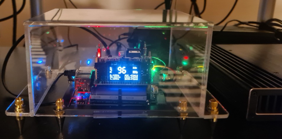

I am using TransportPi MK2 with FifoQ3 to feed my Hypex fusion amps a good digital signal.
Any chance on a TransportPi MKx version with AES output?
The Hypex have only a spdif rca input. But they do have a AES input.
