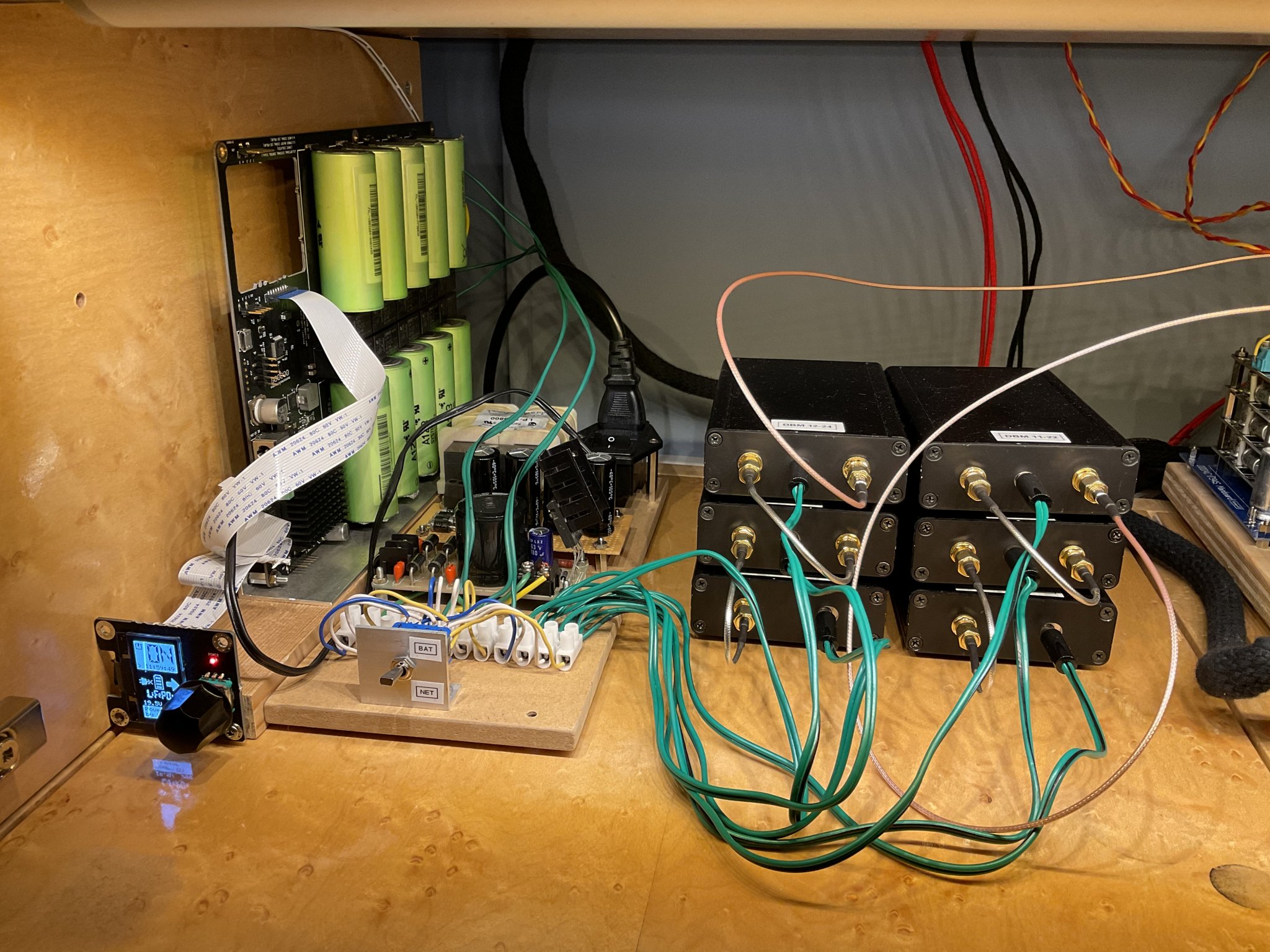

I use the D3 boards from RyanJ on this forum.Very nice set up!!
What kind of pcb's are you using for the TDA1541A?
What is the power supply you use for the DRIXO?I use the D3 boards from RyanJ on this forum.
Thanks Ian,@Supersurfer
Your TDA1541 DAX looks very cool! Congratulations!
Are the two mono block TDA1541 in parallel for each channel?
How do you like the sound by comparing with other R-2R DACs?
The I2S signal from the fifopi/reclocker is transferred into simultanous mode and also an inverted signal is created; for each channel a stereo dac chip is used in balanced mode (this cancels out all common mode and ground noise) and the IV dac output is connected directly to a Sowter IV transformer.
I use 2 stereo dac chips per channel in parallel; 4 in total.
This is the most musical involving dac I have ever built and heard, while also being very resolving, detailed and analog sounding.
It betters all the other TDA1541A dacs I built, all dddacs I built, and now it is residing next to the awesome new ladder dac from Andrea and it still is more musical involving.
I made a power supply with mosfet rectification, Black Gate non polar capacitors and Sparkos labs regulation. I also experimented with other types like LT regulators, battery supplies and a new class D power supply. But this one is the best performer of them all.What is the power supply you use for the DRIXO?

No, my reasoning is that a clock is a very stable load for a power supply and a shunt regulators main advantage will therefore not be needed. A serial regulator would be preferable due to the high power supply rejection rate they can deliver (the Sparkos has -125dB psrr) this is needed when you want the low phase noise of the clock not to be masked by ps noise.Thanks,
Do you try to feed the DRIXO with a Reflektor-D or UltraBib?
The question is to know,Why a regulator is better than a battery (A123)known to be low noise.No, my reasoning is that a clock is a very stable load for a power supply and a shunt regulators main advantage will therefore not be needed. A serial regulator would be preferable due to the high power supply rejection rate they can deliver (the Sparkos has -125dB psrr) this is needed when you want the low phase noise of the clock not to be masked by ps noise.
I tried the A123 batteries, they were not the best ps for the clocks. Batteries have chemical noise, they are not more silent than line power. And another thing of importance; clocks need to be turned on constantly for best performance, this is in conflict with the loading cycle the batteries need.The question is to know,Why a regulator is better than a battery (A123)known to be low noise.
@Supersurfer, there used to be a post on DIYAUDIO showing the noise level of Lipofe cells to be below -150dB, which obliterates most active regs.
