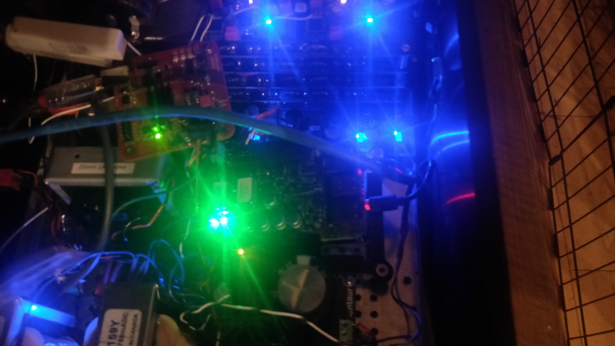

I have an XMOS USB card installed on the RPi daughter board. That (XMOS) seemed to work okay during some testing using my other StationPi Pro board. My plan was to use the XMOS card for USB input and the ReceiverPi for Toslink input. I have not tested the ReceiverPi on the audio side, hence the question. So, the ReceiverPi won't work on the StationPi Pro audio side?
Edit: I guess I've had a misunderstanding on where some of the other input boards need to go - the RPi side or the Audio side. I now see after another review of the ReceiverPi docs that indeed it should go on the RPi side. However, are you still saying that if I were to get the ReceiverPi Pro, it would work in the Audio side stack, or would it still need to be under the RPi on the RPi side? I guess I don't care where it need to go as long as it's the correction implementation of it with the whole system.
On a related topic we've discussed before... Will a HiFiBerry DAC work (or benefit from) with new FifoMA?

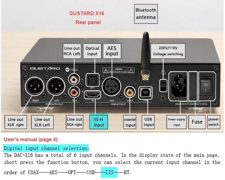

Hi All!
My problem is, the q7 with hdmiPi Pro not working my Gustard x16.
My TransportPoDigi working fine with it.
Unfortunately Gustard havent i2s options.
The assembly was done according to the manual and the Volumio play the music fine, just There is no music.
Thank you in advance for your help.

Hi All!
Gustard X16 has an I2S input: it corresponds to the HDMI port, which has a custom pinout.
You therefore need an HDMI cable like this (plan2 choice):
https://aliexpress.com/item/1005003502160941.html
Which X16 input are you using now?
