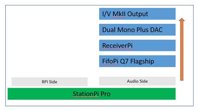

@Ian,
I'm finally getting to use some of your other boards with my StationPi Pro board. I ran out of vertical height with my first design enclosure, but now I have plenty of room for stacking. 🙂 Just want to confirm that the image below represents the proper order of building up the audio side with various boards - with everything stacked on top of the FiFoPi board. At least that's what I've noticed with many of the images in your documentation.
@redjr@Ian,
ReceiverPi need to be installed to the Pi side under the daughter board. It would be better to use ReceiverPi Pro for StationPi Pro.
Ian
