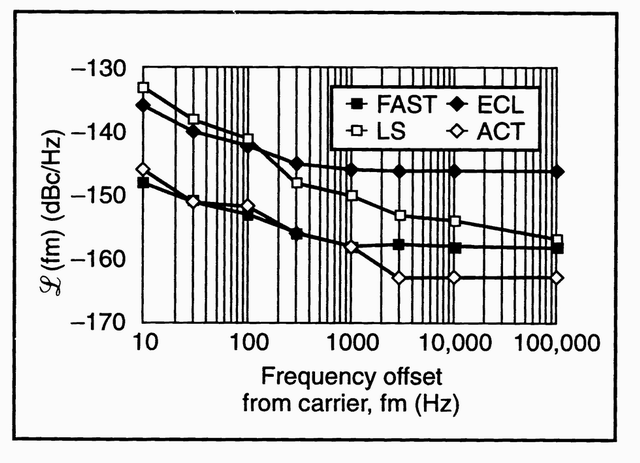

Hi Ian, jitter data is from much documents and some friends, some of them were at my site (now hacked)
In attach phase noise plot from McClure Residual phase noise in digital frequency dividers
24MHz/4
as you see for old LS series Phase jitter is only 0.12pS RMS:) but all this is very dependent from PSU noise (for CMOS devices especially)
24MHz/4

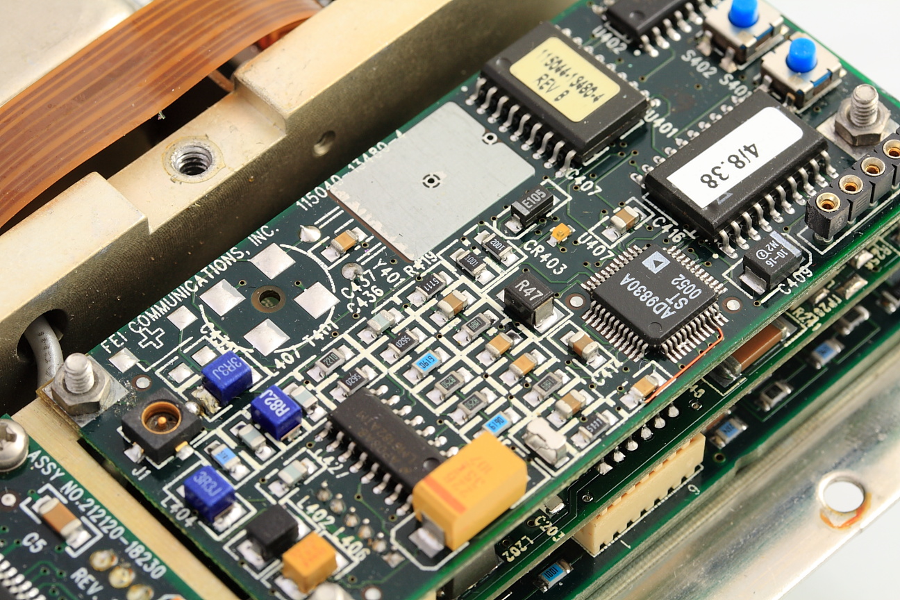

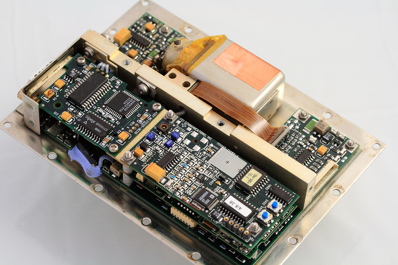

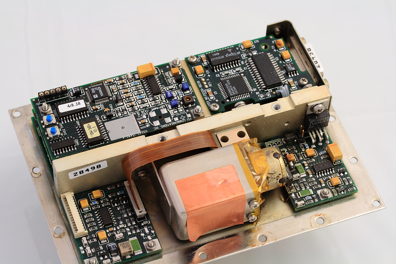

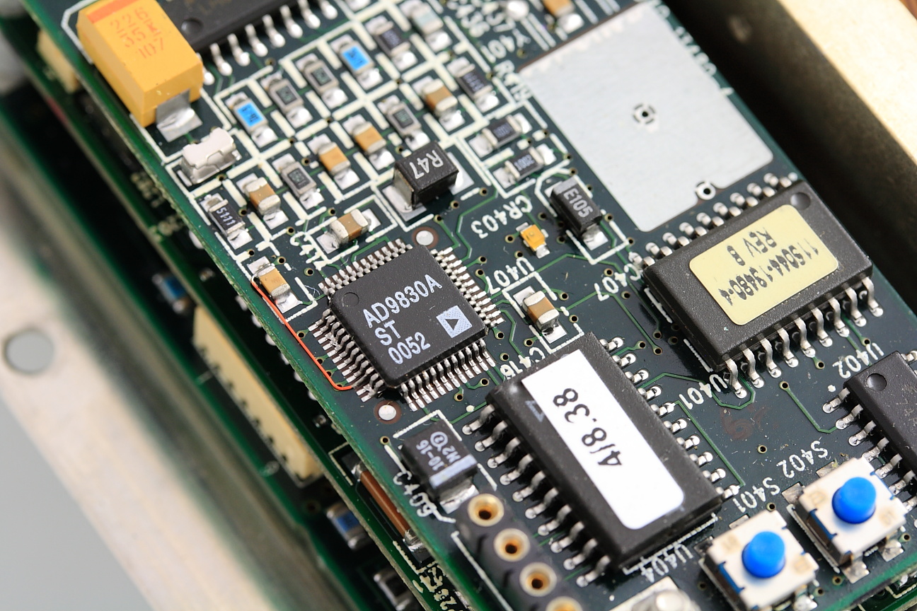

Just attach some pictures of my FE-5680A for you to reference. The frequency was re-programmed to 11.289600MHz. We can see the ADI DDS solution inside. The AD9830 has a 10bit with roughly 50Mhz MCLK and a sine look-up table. It generate the sine clock just as the similar way as a DAC in CD player does. Did anybody see the real output waveform of the AD9830 generating a frequency just around 1/4 Fs? The LPF became a quite significant thing in this case.
I did try this rubidium clock on my CD transport but the result was not as good as I thought. Sine to square converter was another issue. Of course it has perfect frequency stability, but it dosn't mean the low jitter perfermance. It seems the actual performance was not as good as the phase noise plot from the FE-5680 PDF file. I don't know why.

Joined 2004
I suspect the problem is the spurs in the phase noise plot for the DDS. The time nuts discuss this and there are issues enough to make them less interesting to the software defined radio guys. Newer DDS's are better but the math may make it quite hard to solve. A PLL can work fine but it would have a very slow lock time if its good. My GPSDO takes a day to lock and continues to get better for as much as a month. Most audiophiles are not that patient unless its a tube breaking in.
You might set up a PLL to phase lock with a long time constant a VXCO to the FE-5680A. But it would make little difference over the VXCO free running. Also the FE-5680A may have some significant EMI. Here is some lifted discussion on DDS with a snaky sounding element that would sell a lot of high end stuff but probably just serve to make things more complex than they need to be (from the Time Nuts mail list):
