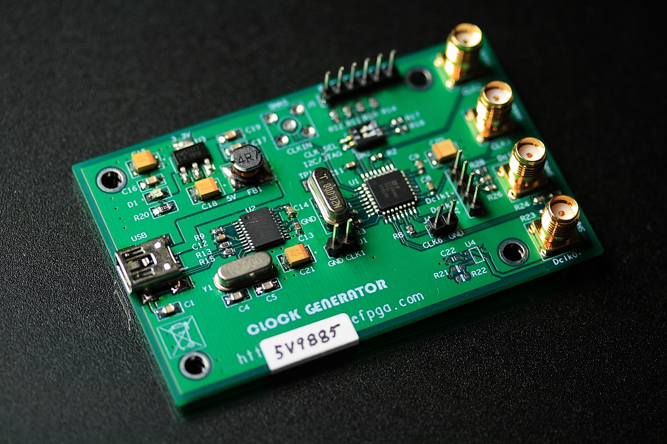

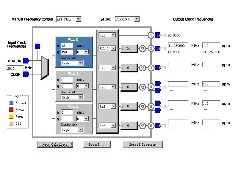

I just came across having an IDT 5V9885 clock generator board for my previous FPGA projects. This clock board is not suitable for digital audio application because it comes with 200ps peak-to-peak period jitter; it was developed originally for FPGA design verification because it has three internal programmable PLLs. The only reason I want to use it was because on chip it integrated a programmable spread spectrum generation function, which means I could generate the ‘know’ jitter by programming the SSC.
The first step I did was programming the 5V9885 to generate an 11.2986MHz clock without SSC from CLK2 and connected it into my system by replacing the clock board I had before. Again, I use battery power this 5V9885 board to exclude the influence of the power supply. It sounds OK, same level as the analog output quality of a hundred bucks DVD player and worse than the direct I2S and MCLK output from DIR9001.
And then, I programmed the SSC to generate the same frequency clock but with +-200ps period jitter with 2KHz modulation. When I turned it on, I was totally shocked. The sound was so bad; I never thought my B&W 804 speakers could sound horrible like that. Everything was mixed up at background and I couldn’t distinguish the positions of the singer and the instruments. It was noisy and without any details. I lost the focus, lost the depth, lost the 3D feelings. After a while, I got a bit sick and my ears were very uncomfortable. So I stopped this research which I thought I could go deeper. When I switched it back to DIR9001, I found it still sound bad. I started to suspect something wrong with my system. But finally I realize it was something wrong with my listening and it didn’t recover until hours later.

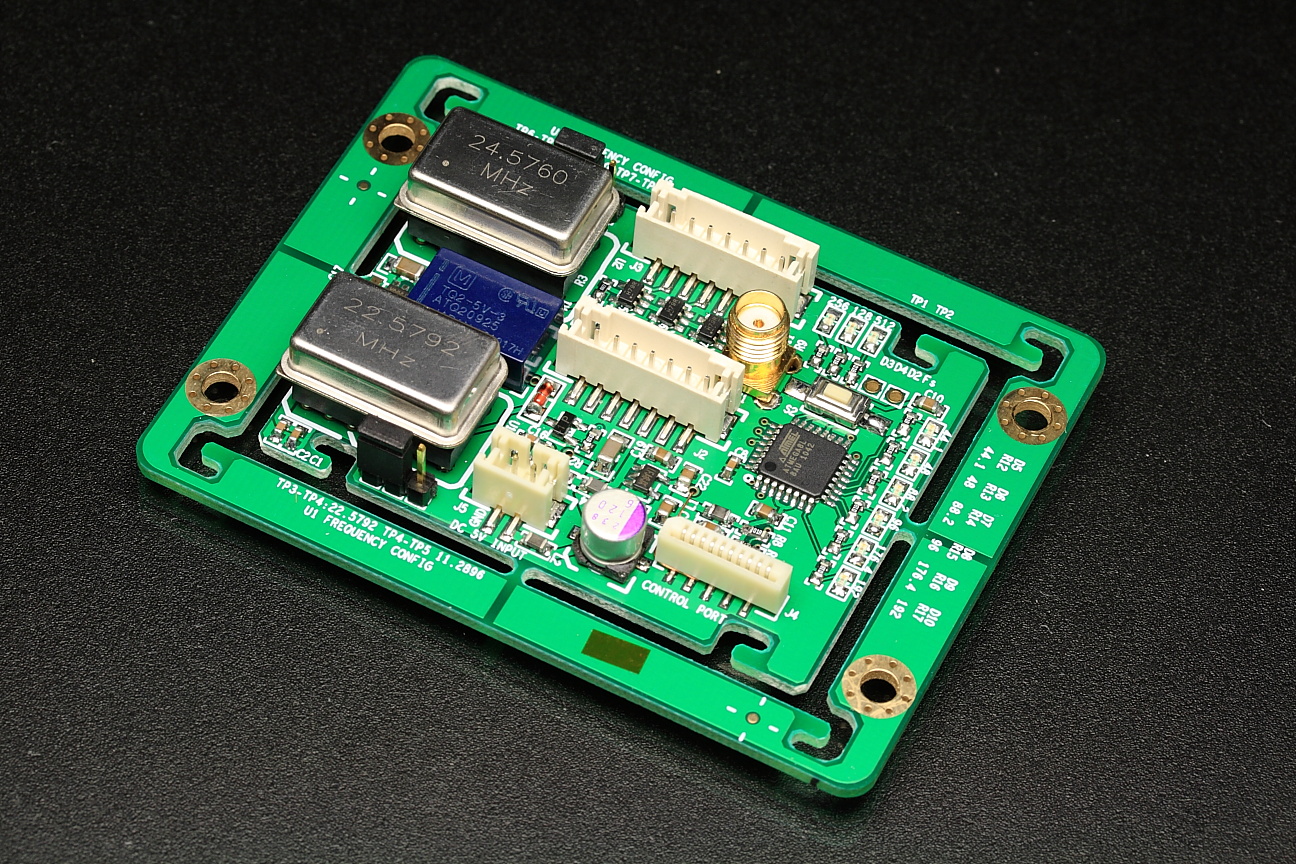

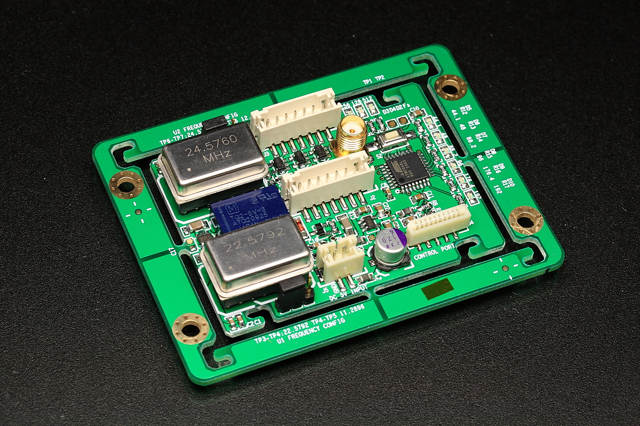

Hi guys, I’m coming back.

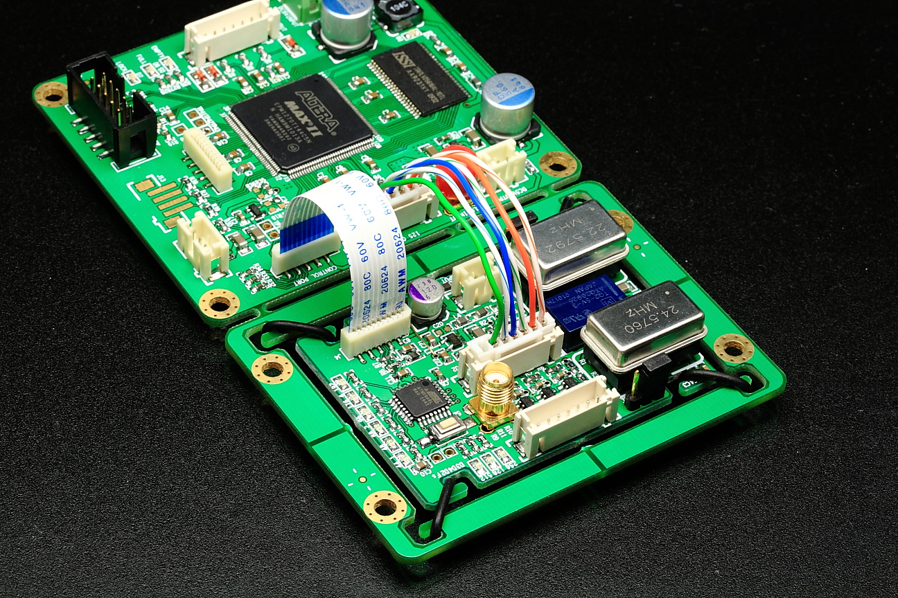

I just could be able to show you the first clock board I designed for this FIFO project: the Double XO Clock Board. Please see the attached pictures.
The features are as below:
1. Frequency supported
44.1KHz 16bit (24bit/32bit ready)
48KHz 16bit (24bit/32bit ready)
88.2KHz 16bit/24bit (32bit ready)
96KHz 16bit/24bit (32bit ready)
176.4KHz 16bit/24bit/32bit
192KHz 16bit/24bit/32bit
2. Switching the MCLK and *Fs automatically according to the input I2S stream;
3. XO options for the socket U1:
11.2896MHz (go 44.1K and 88.2K)
Or, 22.5792MHz (go 44.1K, 88.2K and 176.4K)
14Pin or 9Pin standard XO with 3.3V Vcc
XO options for the socket U2:
12.2880MHz (go 48K and 96K)
Or, 24.5760MHz (go 48K, 96K and 192K)
4. Re-clock function was equipped on board;
5. Manual frequency switching button for optional standalone working mode;
6. Output the MCLK and I2S signals directly without passing through FIFO;
7. Implement a relay for frequency switching to avoid any additive jitter from buffering the MCLK;
8. Frequency settings will be saved and applied automatically at next power up.

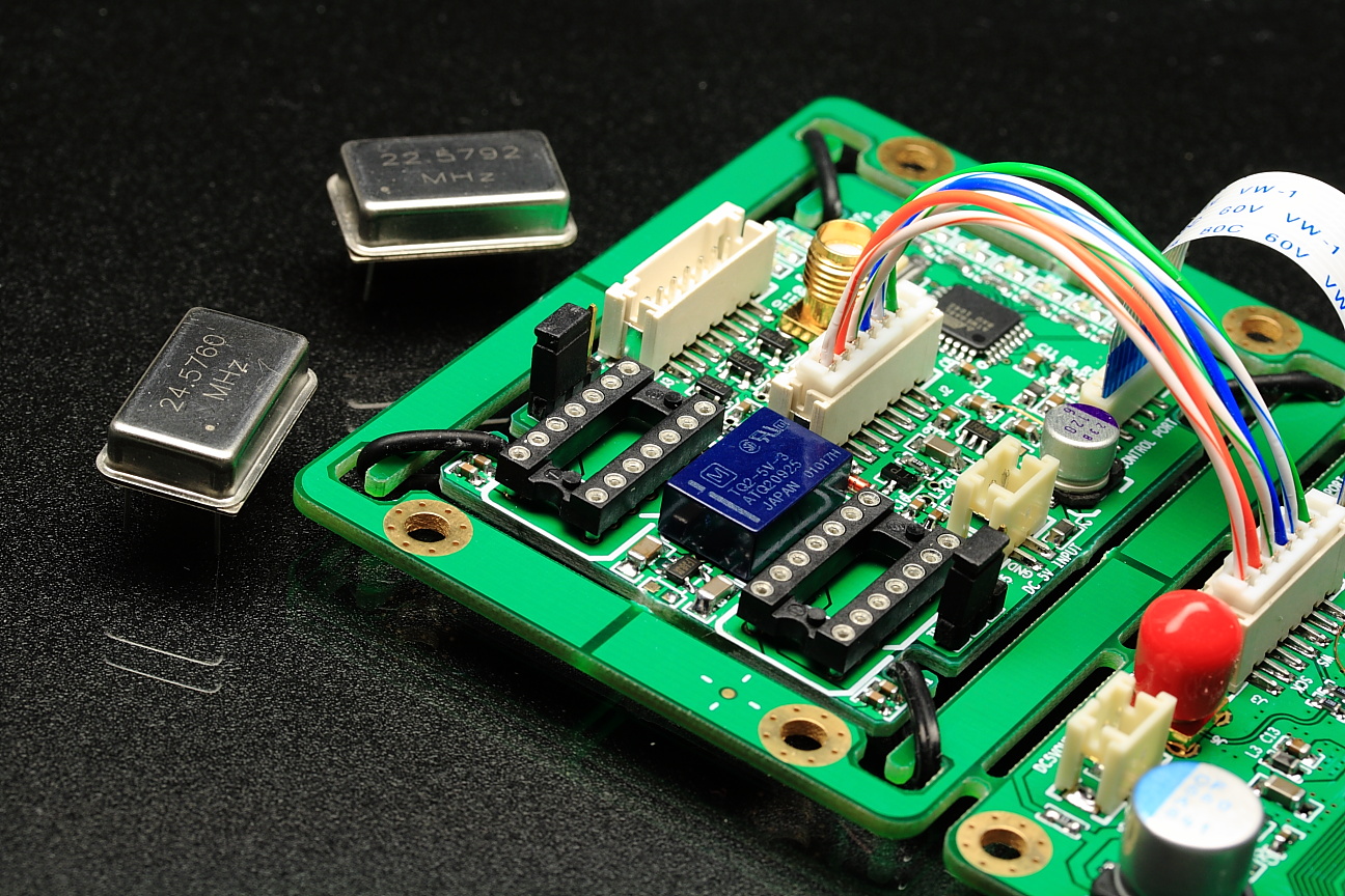

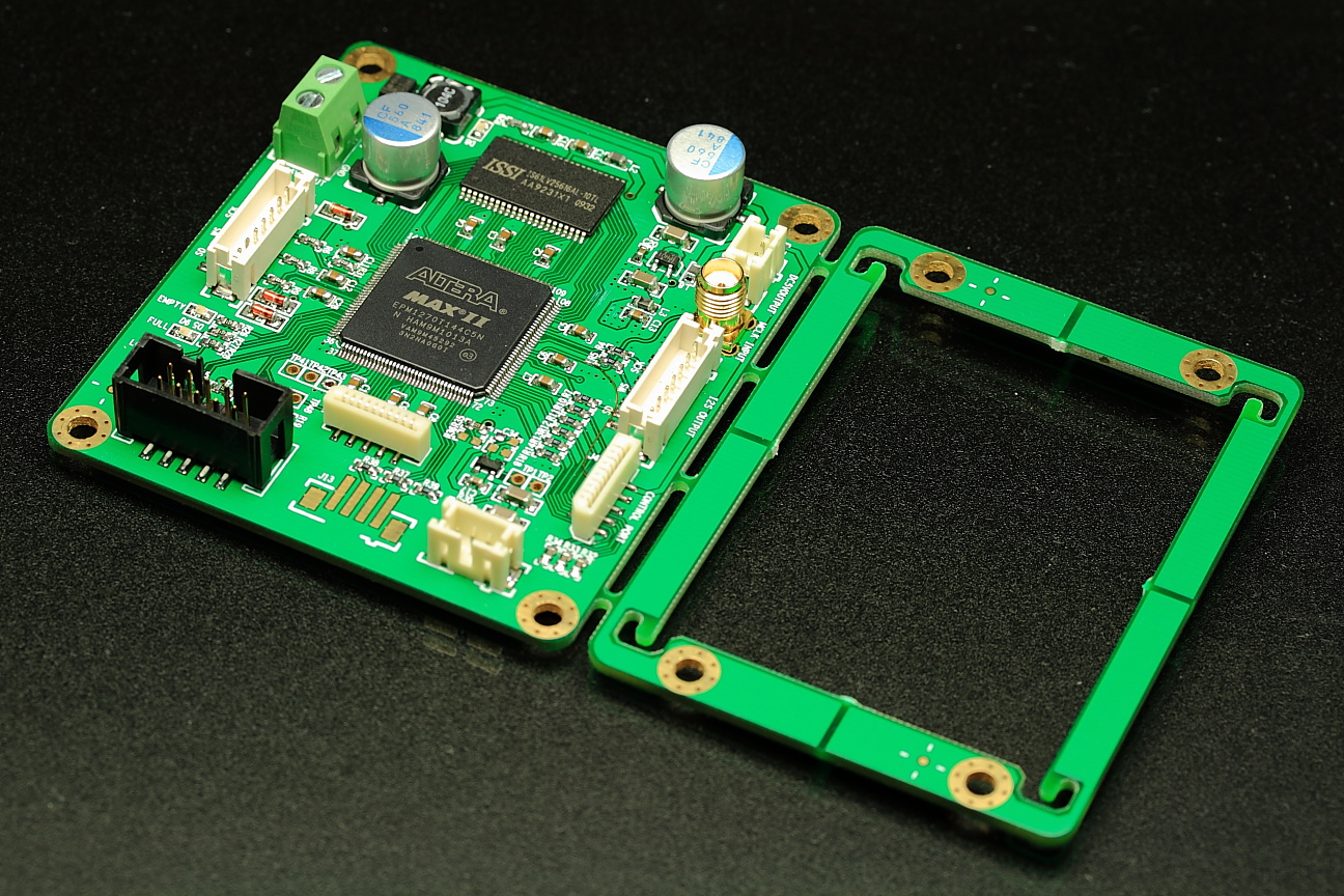

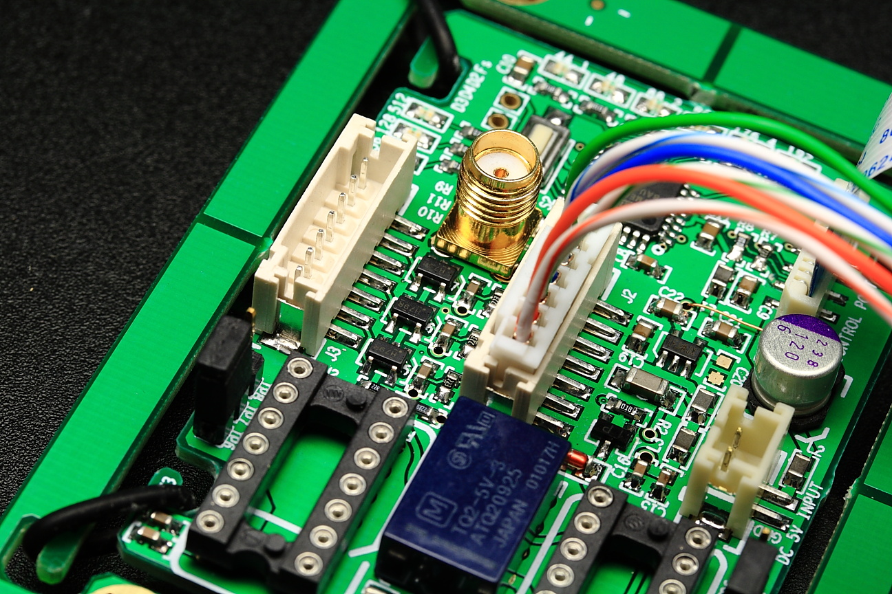

The FIFO board was designed having an optional frame connected which is compatible with the frame on the clock board(this idea just make the FIFO board could be easily integrated with different clock solution). We can pick up the clock board from its original frame by a side cutter, and hook it up to the FIFO board by four rubber rings to make them linked together as a whole piece; or, we could cut the frame from the FIFO board and make the FIFO and the clock board located separately. It’s quite flexible at this point. The purpose of using those rubber rings is to reduce the mechanical vibration which could also introduce the jitter into the XO output.
Interface with the FIFO board, basically only a 10 pin FFC cable is needed. If we want to use the re-clock function on the clock board, an additional I2S bridge cable will be connected. That’s all, nothing else, very easy.
This double XO clock board has a frequency management MCU. During normal operation, this MCU will run at deep sleep mode, or power down mode. In this mode, all of the clocks, include CPU clock, IO clock and watchdog clock, are stopped. That means the MCU do not generate any EMI noise at this time. When the frequency detecting logic on the FIFO board found input I2S frequency was changed, it will wake up the MCU by pulling down the interrupt line, and at same time silence the I2S output. After the wakeup, the MCU will set a new MCLK frequency as well as the *Fs according to the information provided by the FIFO board. Once the new frequency was set and confirmed good, the MCU will back to the deep sleep mode again.
There are nine LEDs on this clock board. Six of them are Fs frequency indicator to indicate six working Fs frequency (form 44.1 KHz to 192 KHz); Three of them are the *Fs indicator to indicate 128,256 or 512 *Fs.
This clock board, together with the FIFO board, are working very well with my system. The frequency switching function was amazing. For example, I’m playing a 44.1K APE by the foobar2000 player, and then I open a 96 KHz 24 bit APE file. The lock LED on the FIFO board will start flashing and the empty LED will turn on, after a while(around 2 seconds), I can hear a little click from the relay, and then the lock LED go solid, empty led turned off, the LEDs on the clock board new indicate 96Khz and 256Fs, and then the music starts. Very cool.
Again, both of the FIFO board and the clock board do not influence the sound quality (of cause they are bit perfect), what really decide the sound quality are the XOs which the clock board is equipped with. So, next step, the most important thing for me is looking for better clocks.
Enjoy the pictures. Ian

It looks like you took great effort to design the clock board. I do have a few comments:Hi guys, I’m coming back.
1) The clock switching based on input signal sample rate change should be instantaneous. Other than the time waiting for the incoming signal to be stable (to verify the sample rate change), there should be no need to wait for 2 seconds. Clearing the FIFO? The old data should be discarded anyway.
2) The CPLD should be able to generate all the control signals used to switch the oscillators. Having an MCU is nice but I don't see the necessity.
3) Using a relay to switch between clocks may not be a good idea. For starters, it is not glitch-free. That's probably why you use a separate controller because you need to reset the CPLD after the clock switching. Second, the regular relay is not suitable for clock switching. You would need the ones rated for GHz signals just to get the impedance control right - and they are not cheap.
I designed a similar product several years ago, the Pace-Car.
Hi Steve,
Thank you so much for sharing your design experience. I took a look at your website. You did some innovative products, very impressed. It seems we achieve the similar target by different direction. I roughly understand your method, very smart idea, I like it.
My solution is more direct, just a standard big enough FIFO with I2S interface. I noticed the ‘under/over run’ issue, so I developed a smart FIFO logic inside the FPGA, in most of the cases, it does not ‘under/over run’ neither, even having a long playlist from a computer based player.
Totally agree with you on the point of power supply. Yes, I found the clock circuit is very sensitive to the EMI noise introduced by the power supply.
My project is still undergoing and I’m gonna try different clock solutions later on. Thank you so much for the offer, just hope I could have chance try your famous Ultraclock meanwhile. I’ll take into consideration. Regards. Ian
Hi Simmconn, Thank you so much for those comments. Appreciate. But at some of points, I’m afraid I couldn’t 100% agree with you. I think it was mainly because we keep the different idea on the I2S FIFO project design. I’d like to discuss with you.
If you took a close look at the pictures, you may find out, at the clock section, I have different design idea. My design idea on the clock board is kind of open concept. My FIFO board could not only compatible with the different XOs on this double XO clock board, but also expend different clock/timing solutions come together with different clock boards, such as PLL, DDS, synthesizer and other technologies. To achieve this function, I need set up a protocol between the FIFO and the clock board. According to same protocol, the MCU on different clock boards could perform the solution independent frequency management. That means, if I have a new clock technology five years later, I still could design a clock board at that time and make it working very well with today’s FIFO platform, because the protocol keeps no change. This advantage will show obviously on my subsequence clock board design. Comparing with the benefit it brought, that MCU is worth it. To keeping bring the ‘fun’, I’ll design series of clock boards, this is only the first one.
On the other hand, my I2S FIFO is working at slave mode; the clock board is the master device with highest priority. All of signals are generated by the clock board at finial stage in order to get the better jitter performance. I don’t think using a slave device to dominate the master frequency control is a good idea. Sorry, at this point, I couldn’t agree with you.
Talking about the relay, I couldn’t find anything more suitable for this double XO configuration other than it, unless you power and run the two XOs at same time which is the way I don’t like. Comparing with FPGA and other logic switching circuit, to switch between clocks, the relay almost introduces no additive jitter. That was the reason I use it. Yes you are right, some of the relays may not suitable for switching the clock, but not include the one I selected. You may notice the good high frequency performance from the insertion loss plot I attached (below 0.1dB at 20 Mhz, below 0.8dB at 1 GHz). Regarding to the impedance match, of course, the dedicated RF relay comes with better performance. But how much we could gain from it? Just let me figure it out. The RF relay could be considered as a half inch cable which we could hookup the source terminate resistor Rs before, while, the non-RF relay could be considered as a half inch lead which we have to hookup the Rs after. The only difference in between is without or with that half inch of additional lead on the XO output pin. For the MCLK up to 24.5760 Mhz with 1-3ns raising/falling time, I don’t see that half inch will make big difference on the output jitter performance. But anyway, if have chance, I’d like to try the RF relay to confirm this matter.
About the switching time, thank you for the noticing. I may have some idea to make it shorter. The only thing I have to compromise with is the frequencies detection accuracy which may influence the performance of the synthesizer based clock board I might design later on. Fortunately, Fs changing only happen at the moment when people switching the source but not the moment when it was playing.
Just hope you could re-start your project. I believe different idea may suitable for different platform. Ian
