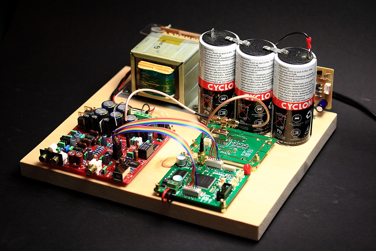

The FIFO playing test
Finally, it starts playing and it sounds correct. The FIFO concept is working!
I2S FIFO configuration:
I just have a spare AD1955 DAC board. It has onboard I2S input and output ports which could be very easy to interfaced with my FIFO. Those ports were designed originally for the DSP, but in its normal setup, the I2S bus was bypassed by jumpers. Both input and output ports of the I2S on the FIFO are the 7pin connectors, 4 of 7 pins are GND between the signals to reduce the crosstalk.
The DAC has a coaxial SPDIF input, the DIR chip is BB DIR9001.
The FIFO was driven directly by an external OSC (11.2896MHz for 44.1KHz with MCLK 256*Fs), as well as the MCLK input of the AD1955. And now you can see this OSC become the secondary clock of the new clock domain and has nothing to do with the MCLK generated by the DIR9001.
I use batteries to power the OSC and the FIFO. The CYCLON battery is my favorite. Batteries usually come with less noise and much better performance to power the clock related circuits which are very sensitive to the noise from the power supply.
The system setup:

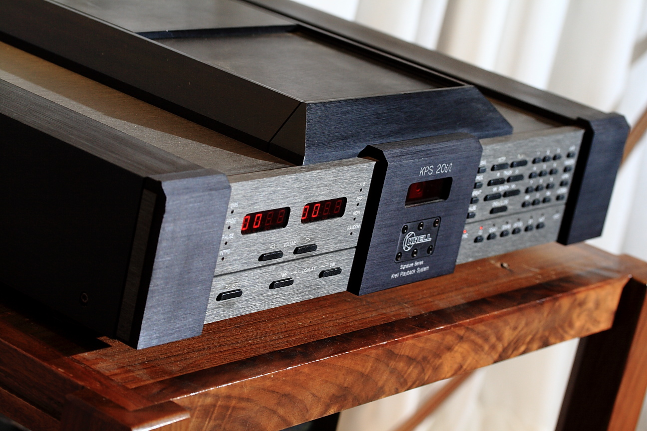

Source: KRELL KPS 20i/L CD transport & MAGNAVOX CD player
Testing result:
1. It sounds correct, just confirmed the bit perfect test I did before;
2. When I switched the SPDIF cable from KRELL KPS 20i/L CD transport to MAGNAVOX CD player, it sounds same no any audible difference, the FIFO concept is working!
3. When I bypassed I2S signals on the AD1955 board, and let them come directly from DIR9001, it sounds different;
4. The delay was around 0.5 to 1s and not that obviously. It just feels like a bit slow on the button of the CD player. I could hardly notice it in most of the cases;
5. FIFO didn’t overflow during the entire test.
Since the FIFO board is working, now we already have a platform to taste the different clock oscillators. So, the next step I’m gonna do some test connected to the clock.
looking good Ian, i too prefer batteries for clock and also use them for powering the analogue sections of the dac (3v3 for AVCC L/R and 1v2 for analogue reference) but I use LiFeP04 by A123. what battery chemistry are the Cyclon?

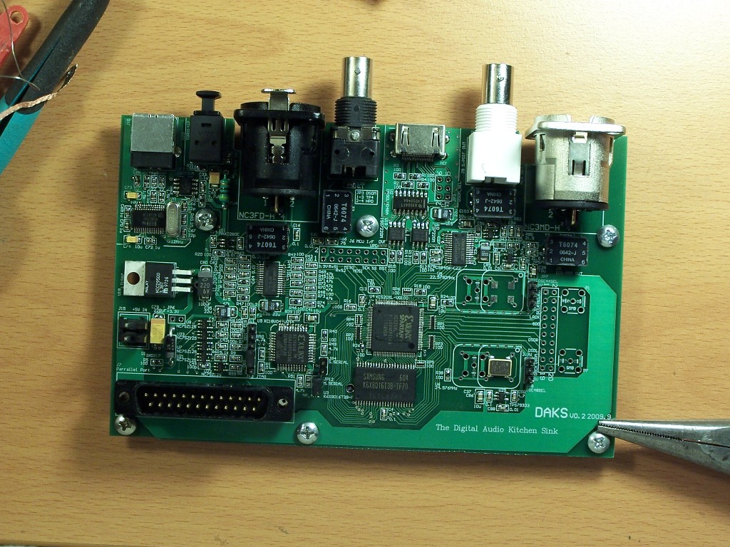

I started a similar project in the summer of '09. The basic idea was very similar, only that the I/O peripherals have more varieties. Instead of I2S I/O, I also added S/PDIF I/O (via BNC and XLR), isolated USB input and an LVDS I2S input over HDMI cable compatible with the PS Audio spec. I was able to get a few 1MB (8Mbit) SRAM (those are not cheap if you buy new) for a slightly deeper FIFO depth. I used an old FPGA that is large enough for the logic. The actual FIFO depth is determined by measuring the clock frequency difference between the incoming signal and the local reference clock, such that the minimum amount of FIFO is used to reduce latency. In addition to PCM, the logic also supports DSD64 (in a 176.4KHz/16bit PCM container when transported via S/PDIF or I2S).
Soon I found that the FPGA I picked does not have the ideal clock resources I need, and the logic resource is not enough for future expansion. I had to abandon the board that I spent quite some time to layout, fab and assemble, let alone the cost of the parts. The core logic is not complicated, but I want to add more 'fun' to it.
Then I turned to a low-cost FPGA development board, the Digilent NEXYS. It has almost all I need for a digital audio front-end: a 500k Gate FPGA with DCM and multipliers, 8MB(64Mbit) PSRAM (DRAM+controller that works like an SRAM), 32Mbit NOR flash and a USB 2.0 high-speed device controller. The I/Os are more than enough for the audio application. A character LCD interface with the switches and push buttons make a reasonably good UI.
A more elaborate plan was laid out: turn the all-hardware design into an embedded system. A PicoBlaze CPU was added for user control and status indication on the LCD. It opens a can of worms and I quickly realized that the software is the most time-consuming part of this project. In this new platform, I was also able to add S/PDIF receiver and transmitter logic such that I'm no longer limited by the features of the off-the-shelf S/PDIF Tx/Rx ICs. A firmware was developed for the USB 2.0 device controller for USB audio class device that is capable of Hi-res.
Again, it wasn't long before I realized that the old architecture has become the bottleneck of this system. I can do a lot more on this platform: A 32-bit CPU with enough performance to run software FLAC decoding, an SDIO interface that enables solid-state player function, oversampling and decimation filters using the FPGA multipliers, etc, etc.
Unfortunately, while I was going full-steam with this project, I was interrupted by a business trip, followed by a serious personal incident that almost knocked out all my interest in this project.
I guess that's it. If you have plenty of time and ambition, think big, or soon you'll find yourself being trapped in a small PLD, a small PCB, or an architecture that is just enough to do what you thought of at the beginning.
It wasn't a bad idea to sell a few boards while you make new ones, though. That'll encourage you to move forward but could also slow you down with the support responsibilities. It depends. Good luck!
(Attached is the 'discontinued' board, only one was made)
