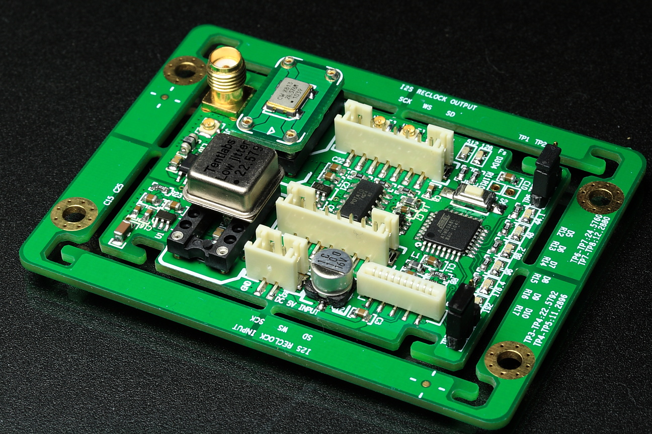

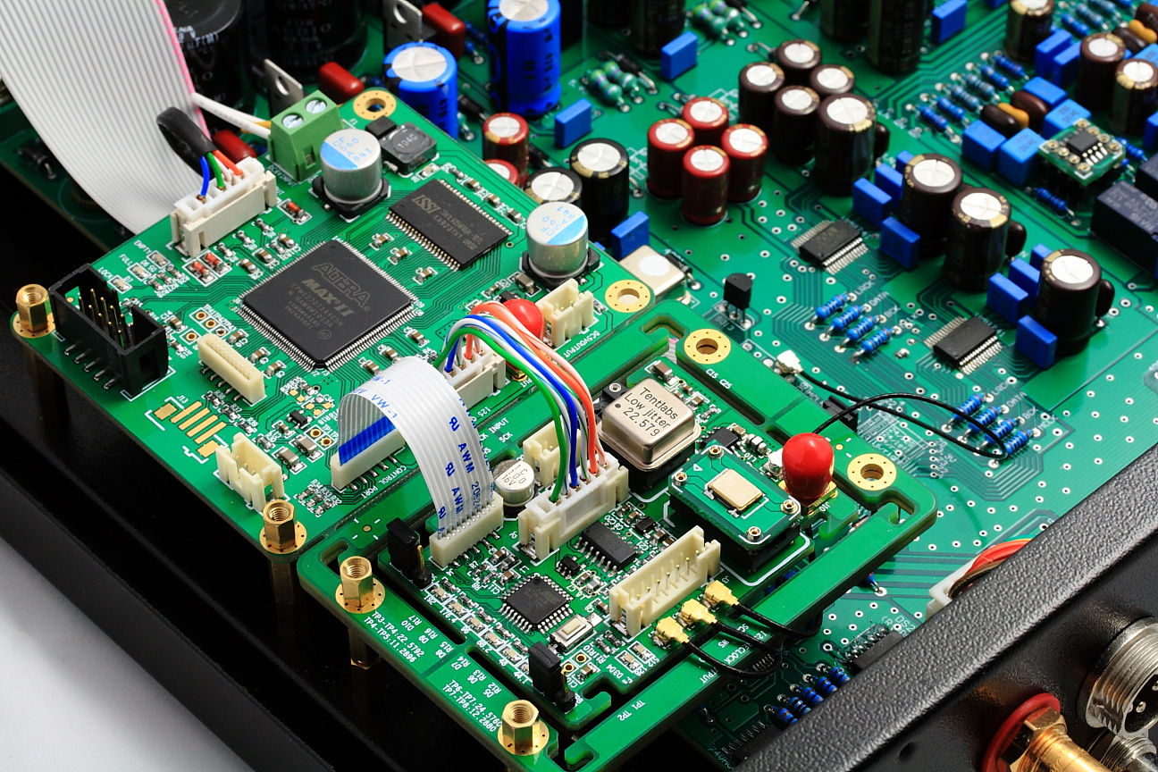

My second clock board: Double XO Clock MK2
I just finished assembling and testing my double XO clock board MK2 last weekend. I have to say, comparing with previous one, the new clock board is better. The new design has the following highlighted features:

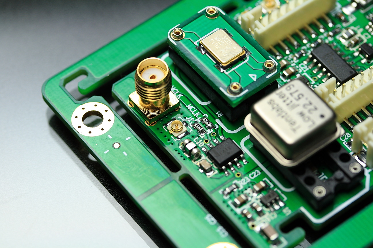

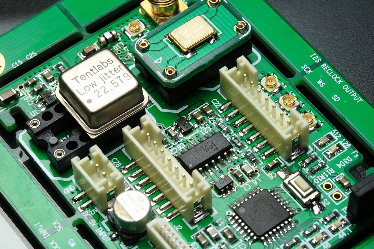

1. Equipped with dedicated clock fan-out buffers switching between the two oscillators and distributing clock signals point to point. The fan-out buffer comes with only 29fs additive jitter which is unbelievable. I attached the phase noise plot of this buffer just for reference.
2. Powering two oscillators at same time with 9uV RMS low noise high PSRR LDO and independent EMI suppression filters.
3. Re-clocking the I2S signals with 600MHz Potato low noise GHz PO74G74, which is the fastest flip-flop with LVCMOS/LVTTL output I could find out so far. Although OS and DS DACs are not that sensitive to the jitter from I2S signals because their internal logic are synchronized with MCLK, but NOS DACs are! It seems that my TDA1541 NOS DAC will benefit a lot from this low jitter I2S re-clock circuit.
4. Switching the clock instantly once the Fs being changed.

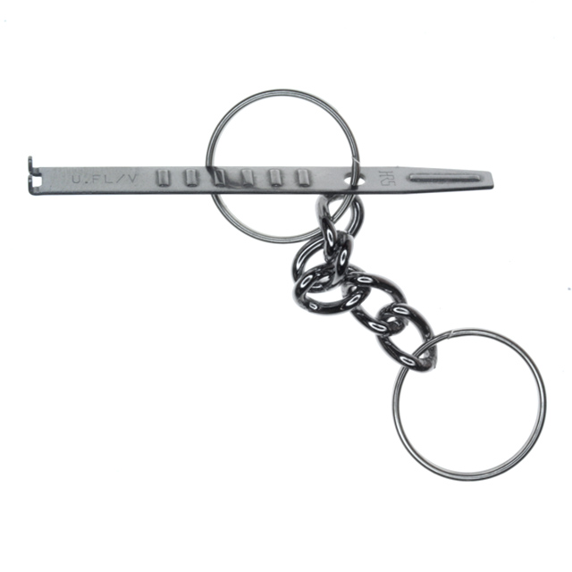

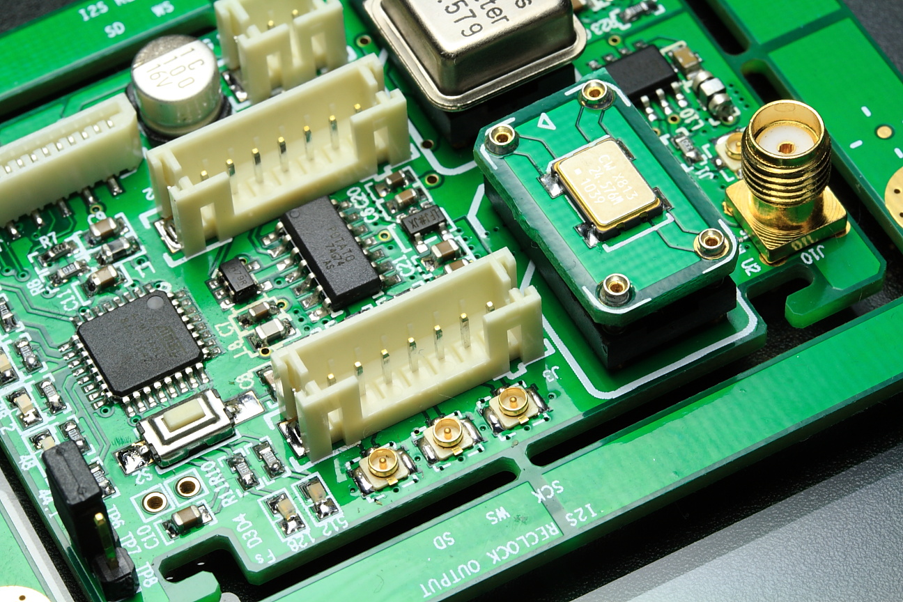

5. Introducing 6GHz U.FL RF connectors and cables into the new clock board for MCLK and I2S output signals.
I really love those U.FL connectors and cables! They are compact, reliable, soft and very easy to assemble. Now I could get rid of the big SMA connectors as well as its inflexible cables (however, I left an optional SMA position which could be suitable for both SMA and U.FL connector just in case I need it sometime). Actually, the U.FL and IPX is almost the same thing and they are 100% compatible from each other. They have different name just because of the patent. Both of them show very good performance during my test. The U.FL cables could be easily sourced from Digikey, while the customized length cables can be ordered directly from the IPX manufacturer’s website.
Another advantage is that the U.FL connector is a kind of very small SMT component; it’s very easy being soldered directly to the signal pad and the GND plate underneath on a DAC PCB without any flying wires. And furthermore, with those 50 ohm RF cables and source impedance matching, the quality of the I2S signals get much improved.
I didn’t select the W.FL connectors and cables, because they are too small and a bit harder to assemble. Special tool is needed to pull out the U.FL cable from the connector. Otherwise, both of the cable socket and the fingernail might be broken. That tool is available from digikey, but DIY a one is not a difficult job.

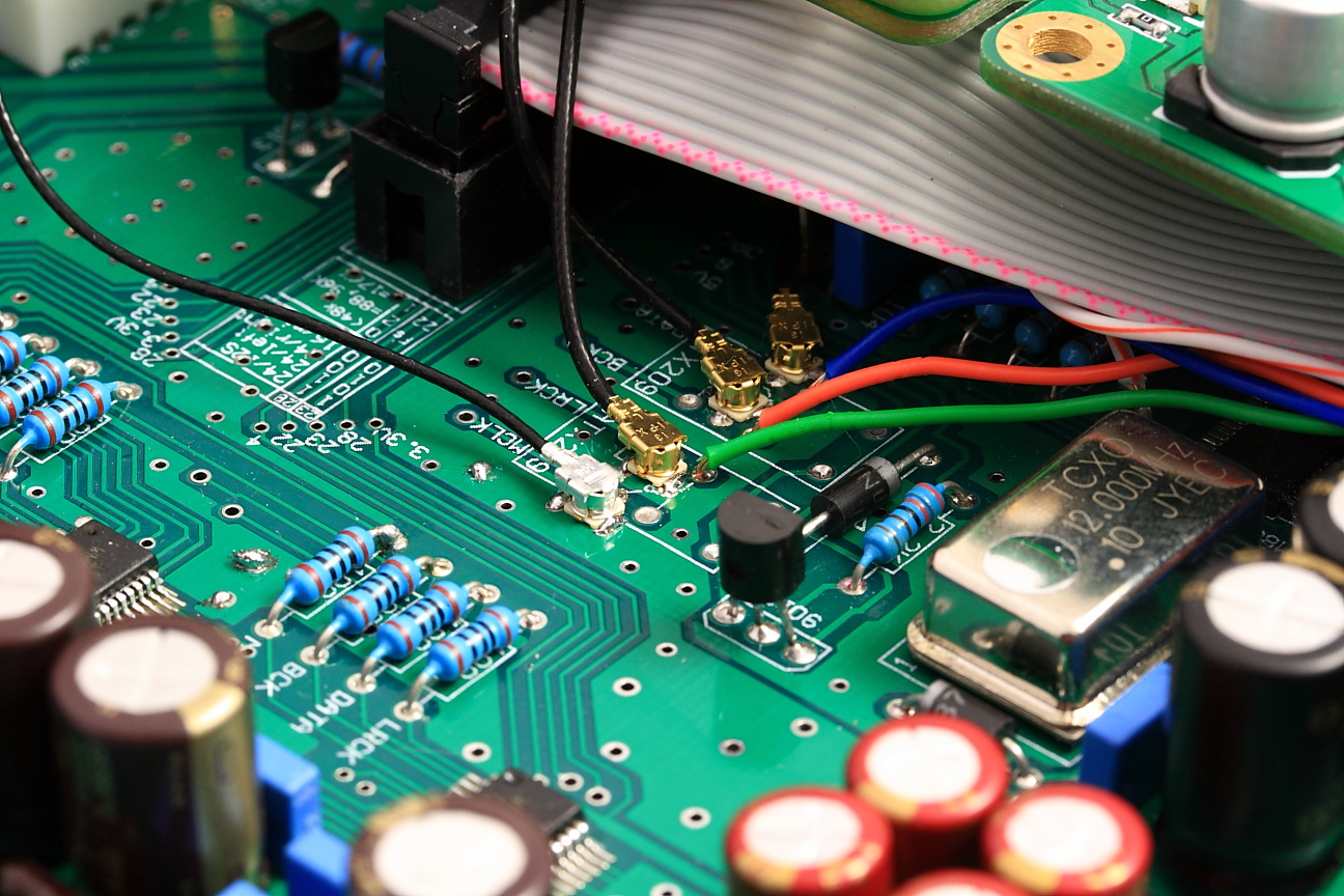

I attached the pictures of the new hookup between the FIFO, double XO MK2 clock board and the WM8741 DAC. It looks better because of those U.FL connectors and cables.
Now, I'm using the balanced output of the WM8741 DAC and replacing the Op Amps with OPA1612. It sounds better. I collected quite a few clock oscillators so far from different sources, but my dream clock is still keeping absence.

Hi Ian,
Very nicely done board!
I was a bit skeptical about the o-ring suspension design for the clock board, until I saw something similar in an HP 8662A signal generator, which has been used as a low phase-noise reference for many years. I was working on a fix-upper for the past two weeks. Very solid machine. My unit is apparently aged and has multiple problems. But it is fun to work on and eventually bring it back to life (and to spec later).

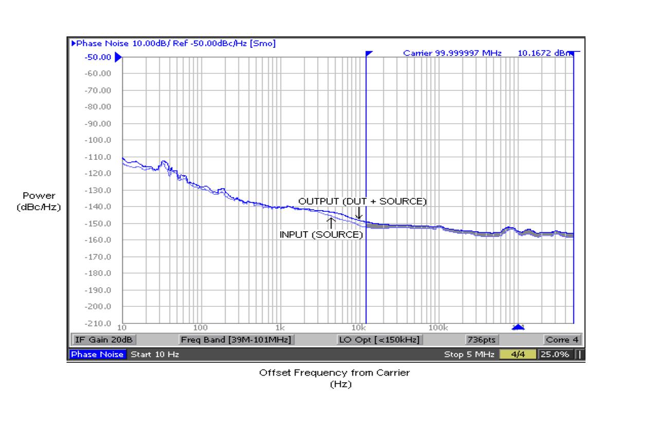

How nice to have such a plot! How did you obtain this ? Did you measure it by yourself? Which instrument did they use?1. ... I attached the phase noise plot of this buffer just for reference.
Hi Bunpei,
I hope I had that oscillator, if so, that would be one of my dream oscs 🙂.
This phase noise plot was originally from the manufacturer of the clock fanout buffer . There are two curves, one of them is for the input clock and the other one is for the output clock from the fanout buffer . The second one is very close to the first, that indicates the additive jitter of the fanout buffer is very small (29fs). Usually they use equipments like Agilent E5052A making this kind of measurement. Ian

What are you using for the clock buffer?
Making a measurement of the phase noise is not trivial but is not too hard to do with pretty available stuff. For a buffer you only need one oscillator, a suitable rf mixer and a good fft. Its tedious to setup and calibrate. For an audio system its easier to look at the spurious outputs on the audio outputs, less hardware is needed and it will show the effects of everything in the chain.

Hi Ian,
I was a bit skeptical about the o-ring suspension design for the clock board, until I saw something similar in an HP 8662A signal generator, which has been used as a low phase-noise reference for many years.BR,

Thanks simmconn,
Did you fix up your super oscillator? Please just let me know what it sounds like 🙂.
At least two things are sensitive to the mechanical vibration. One is the crystal inside the XO and the other is the MLCC due to its piezoelectric effect. So, theoretically the rubber ring works for isolating that vibration. But, by how much, I didn't confirm.
Ian
