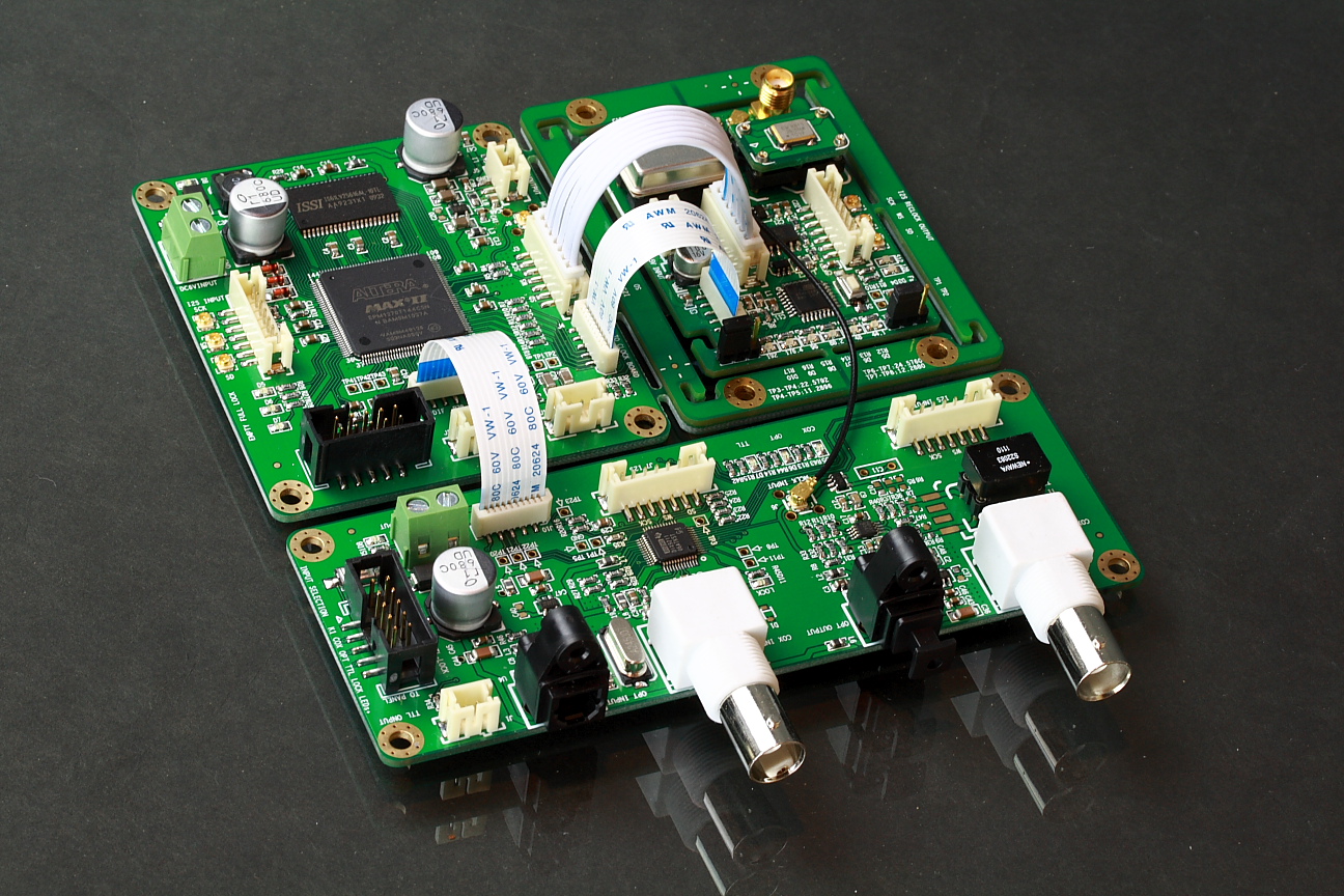

S/PDIF interface board for I2S FIFO project

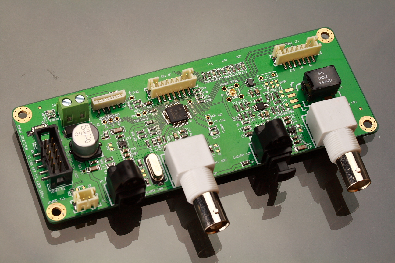

To extend the applications of the FIFO project to the fields other than building or modding a DAC, I need an S/PDIF interface board. So, I designed this one. Working together with the I2S FIFO board and the clock board, it becomes an S/PDIF FIFO.

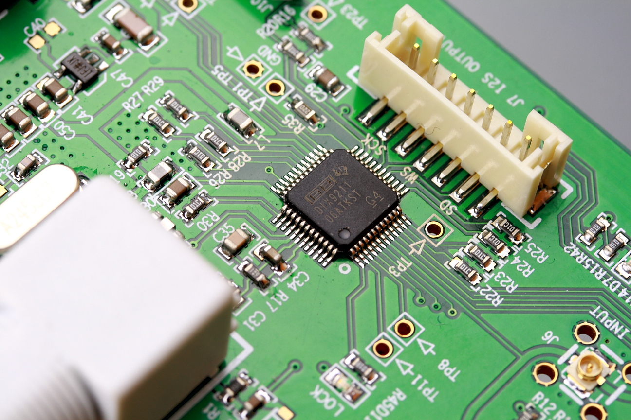

I use TI/BB new generation 216 KHz digital audio interfaces DIX9211 as the S/PDIF transceiver. Actually I built both DIX9211 and WM8805 evaluation boards in advance and did very carefully test before I made the decision. DIX9211 shows bit more stable on coaxial input running at 192 KHz, and it support 176.4 KHz more directly. Importantly, within DIX9211, the DIR and DIT are independent from each other. They have separate I2S ports and MCLK input and output, as well as the channel status buffers, which are the very basic requirements for an asynchronous S/PDIF FIFO. I’m very happy with the performance of DIX9211 so far, although the price is double.

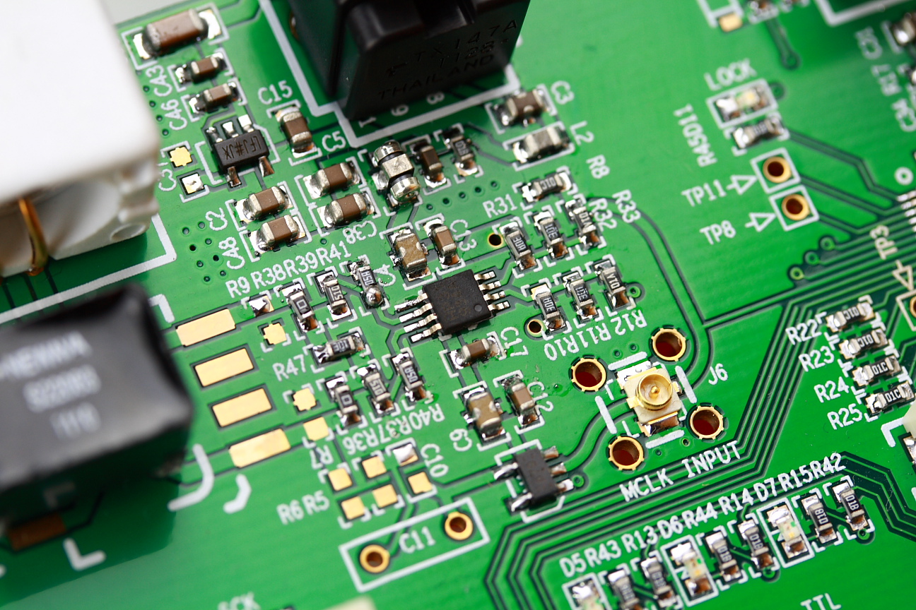

S/PDIF driver is another very significant issue. People usually use CMOS driver such as 74HCU04 doing this kind of job. Functionally, there is no any problem. But I don’t think normal COMS buffers are suitable for low jitter application. Because the bi-phase mark code is mixed with both clock and date, it is very sensitive to the additive jitter along the transmission chain (that’s why the cable and the transformer could be heard). I use a balanced LVPECL driver driving the digital audio transformer into coaxial cable. The sound improved obviously than the CMOS driver, as well as the waveform after 5 feet cable with 75 ohm termination. I will give more details together with schematics and waveforms about this new S/PDIF driver solution later on. To eliminate the additive jitter generated by DIX9211 itself, S/PDIF signal need to be re-clock directly at finial stage by the MCLK from clock board.

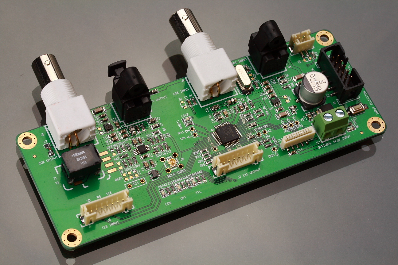

The features of the this S/PDIF interface board are as below:
1. Three S/PDIF inputs: coaxial, optical and TTL, could be switched by a button;
2. Two S/PDIF outputs: coaxial and optical;
3. Support Fs (both input and output): 44.1 kHz/16bit(24bit ready), 48 kHz/16bit(24bit ready), 88.2 kHz/24bit, 96 kHz/24bit, 176.4 kHz/24bit, 192 kHz/24bit;
4. I2S FIFO interface;
5. MCLK input port to clock board with dedicated 50 ohm U.FL connector;
6. Low jitter LVPECL S/PDIF driver;
7. S/PDIF source LED indicators;
8. Lock indicator LED;
9. Front panel interface port available for all the LEDs and control button
Working with the FIFO board and clock board, 3 hours bit perfect loop test was passed with up to 192Khz/24 bit setup and for both coaxial and optical connection;
Please reference to the attached pictures. Please note, in the pictures, the FIFO board is already the second edition with S/PDIF board interface, optional U.FL I2S input and bug free.

Do the BNC connectors offer advantages over standard RCA?
Hi 454Casull,
S/PDIF should be treated as RF signal and BNC usually comes with better impedance matching performance than the RCA, says 75 ohm. So, I think that would be one of the advantages.
RCA S/PDIF cables still work if we add BNC/RCA adapters over the BNC connector, I did this way during the functional testing.
Have a good night.
Ian
The digital transmission of BNC refers to AES at 24Bit/48KHz while RCA refers to S/PDIF at 20Bit/48KHz. [Reference] Some people have talked to me that the jitter of BNC is at the minimum in comparing to AES/EBU(Balanced) or S/PDIF. I have not see any research paper to support. In my practical listening test, I personally cannot hear any difference between BNC and RCA connection.
Isn't this important only for video applications?
Impedance matching is very important for all high frequency RF signal transmission as well as clock signal. It's not for video 'only' 🙂. Actually S/PDIF signal is not a audio signal. It's kind of bi-phase mark code and should be look upon as a clock signal. If we don't have good impedance matching, the reflecting signal will be added over the clock and introducing more jitter. Ian

Thanks simmconn,
The S/PDIF interface board is a very flexible design. Basically, on board, it has a DIR and a DIT which are independent from each other. You can use it as a S/PDIF receiver and feed the I2S signal directly to the DAC form the clock board, which might the way you want; or,you can loop the I2S to the S/PDIF board and make it working as a S/PDIF FIFO; and or, your can make it doing both at same time.
Including the S/PDIF receiver and transmitter into FPGA design is a smrt idea. But my considerations in this project are:
1. Actually I can do this, but the problem is I need more logic cells and other resourses. That means I have to use larger CPLD/FPGA than the CPLD I'm useing now. The DIX9211 is just an $5 chip,the cost would be less then enlarging the CPLD/FPGA;
2. My design idea is kind of open concept. I need to keep the S/PDIF board independent from the FIFO and clock board, in case somebody else want to use their own S/PDIF interface solution, or just don't use it at all;
3. Use a commercial IC like DIX9211 is safer for this project, at least it guaranteed fully tested by the group from TI/BB.
