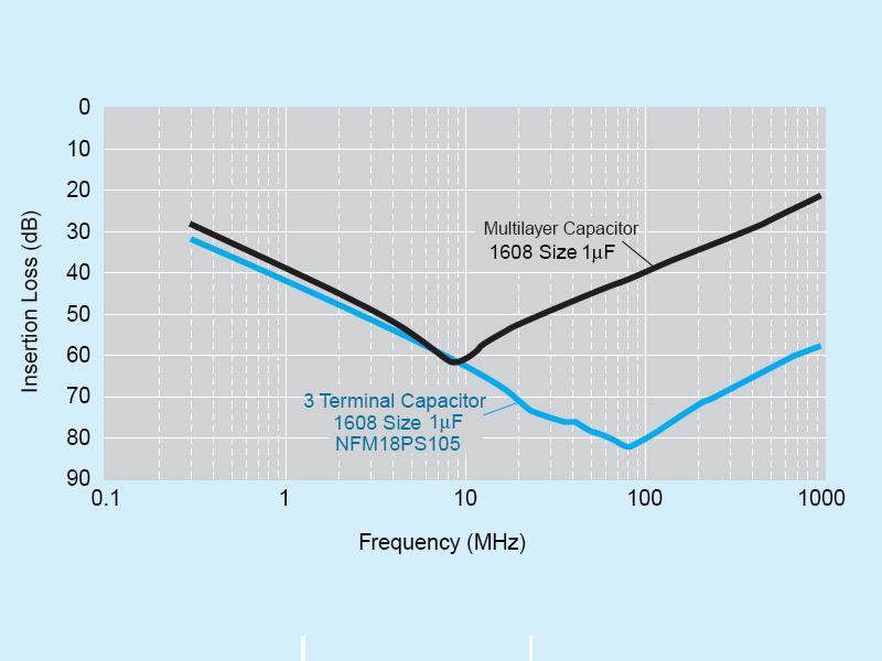

are C4 and C9 some sort of capacitor network? they appear to have 4 terminations
Very glad you noticed that. It's NFM filter from Murate. Somebody call it three terminal capacitor. Very good noise suppression performance. Much better than the normal decoupling capacitors due to its smart construction( 20dB in difference at 20MHz, and 40dB at 100Mhz). Highly recommended for clock power supply. You can find more details from http://www.murata.com/products/catalog/pdf/c31e.pdf
well thats really interesting!! quite apt too, because i was actually just thinking about how i might get rid of the HF out of band fundamental in 'the wire' switching psu just for completeness.
I think i might ad a few to my DK order to have a play; thanks for that.

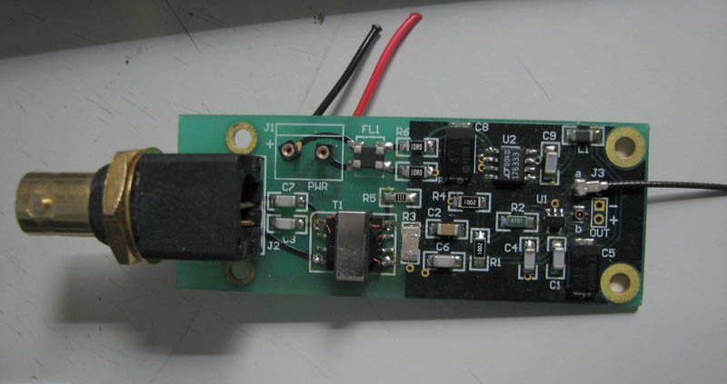

SPDIF Driver and digital transformer selection
SPDIF driver and the digital transformer are very significant for a SDPIF FIFO because they will introduce additive jitter after secondary clock.
To reduce that additive jitter, I use a 3GHz balanced LVPECL flip-flop, MC100EP31 as the SPDIF driver and re-clock logic.

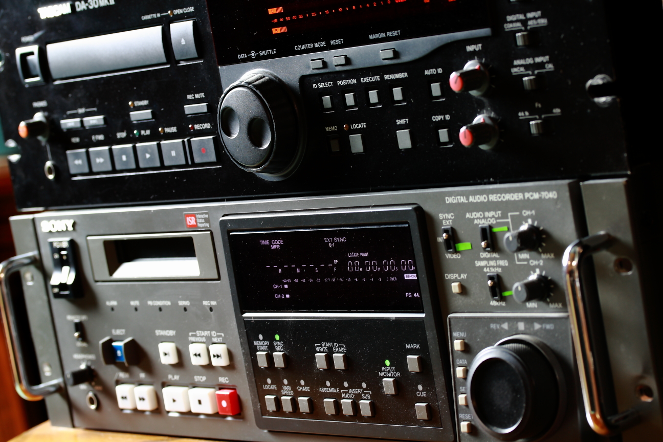

I did the listening test by making use of PCM-7040 as a DAC, which was the top of the line broadcast grade DAT flagship from SONY and it's very sensitive to the SPDIF input, each different driver and transformer could be heard. Obviously, with the same set up, LVPECL driver sounds better than the traditional 74HCU04 CMOS driver.
Three SPDIF transformers were tested. They are Pulse PE65612, Newava S22083 and Newava S22160. Each of them sounds slightly different. The PE61612 is good, S22083 bit better. But the one I love the most is the S22160, which comes with more liquid and more musical.
I attached the driver schematics and the SPDIF signal waveform (after 5 feet coaxial cable with 75 ohm termination) for reference.
This test is still undergoing, I will try some other kinds of low jitter SPDIF driver and will select the best one to use finally.

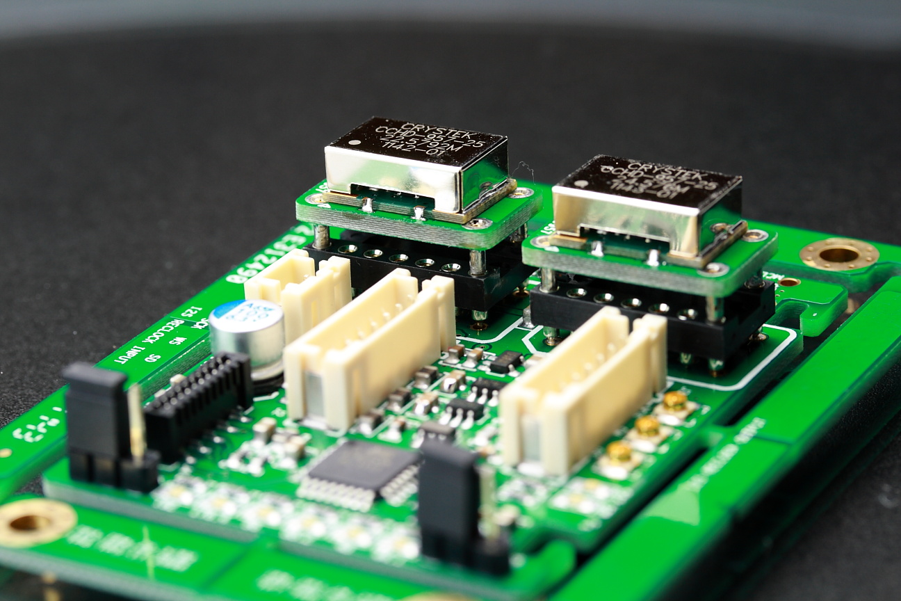

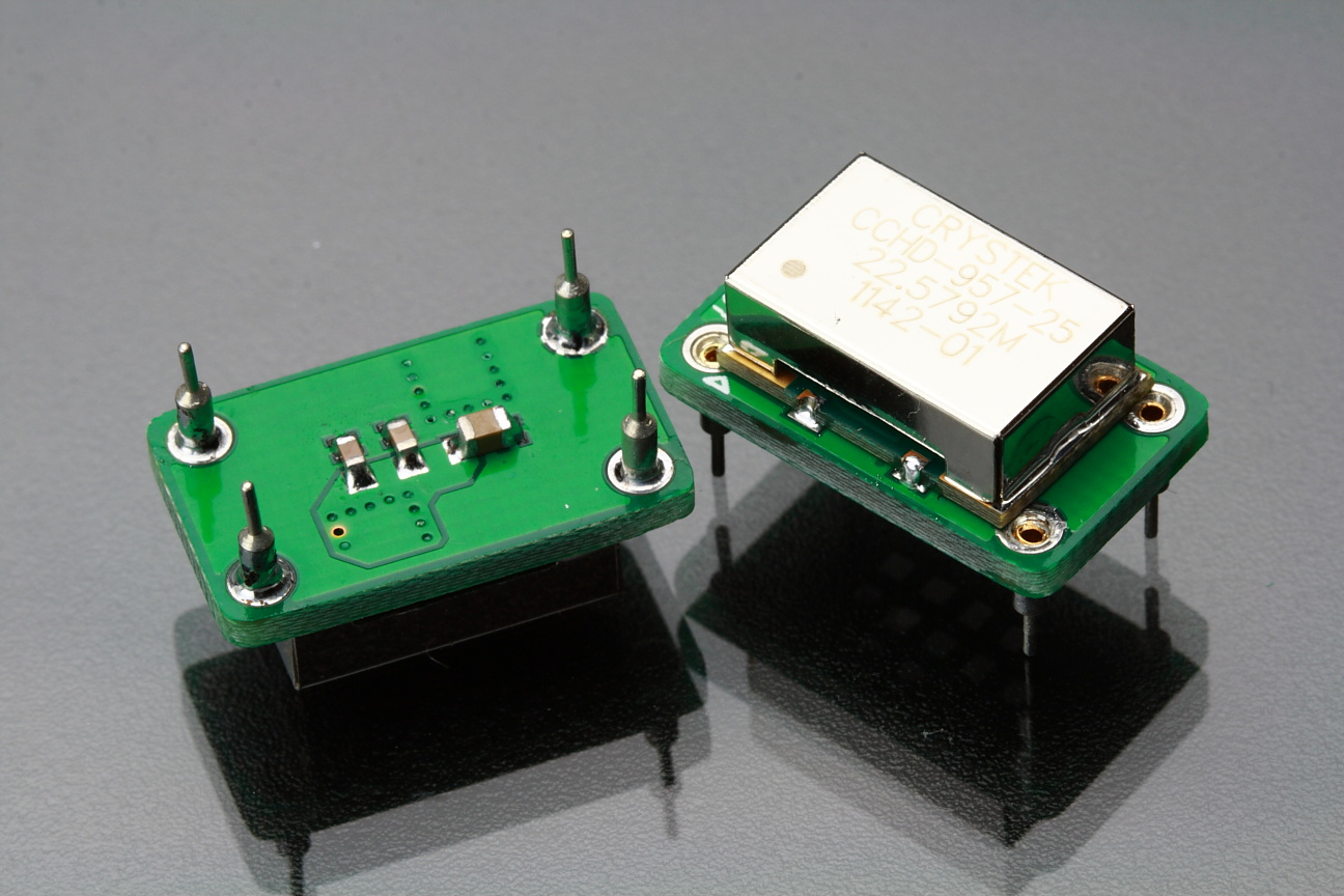

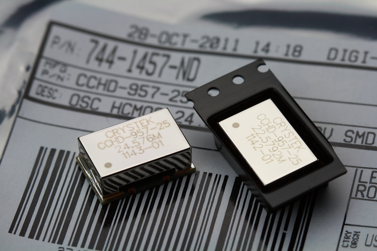

Crystek CCHD-957 low phase noise oscillator and the adapter
Crystek CCHD-957 family oscillators were designed especially for high definition audio applications. From the specification, they have pretty impressed low phase noise performance.
I got the backorder from Digikey two weeks ago. It took me two month! But both Digikey and Mouser keep in stock now.

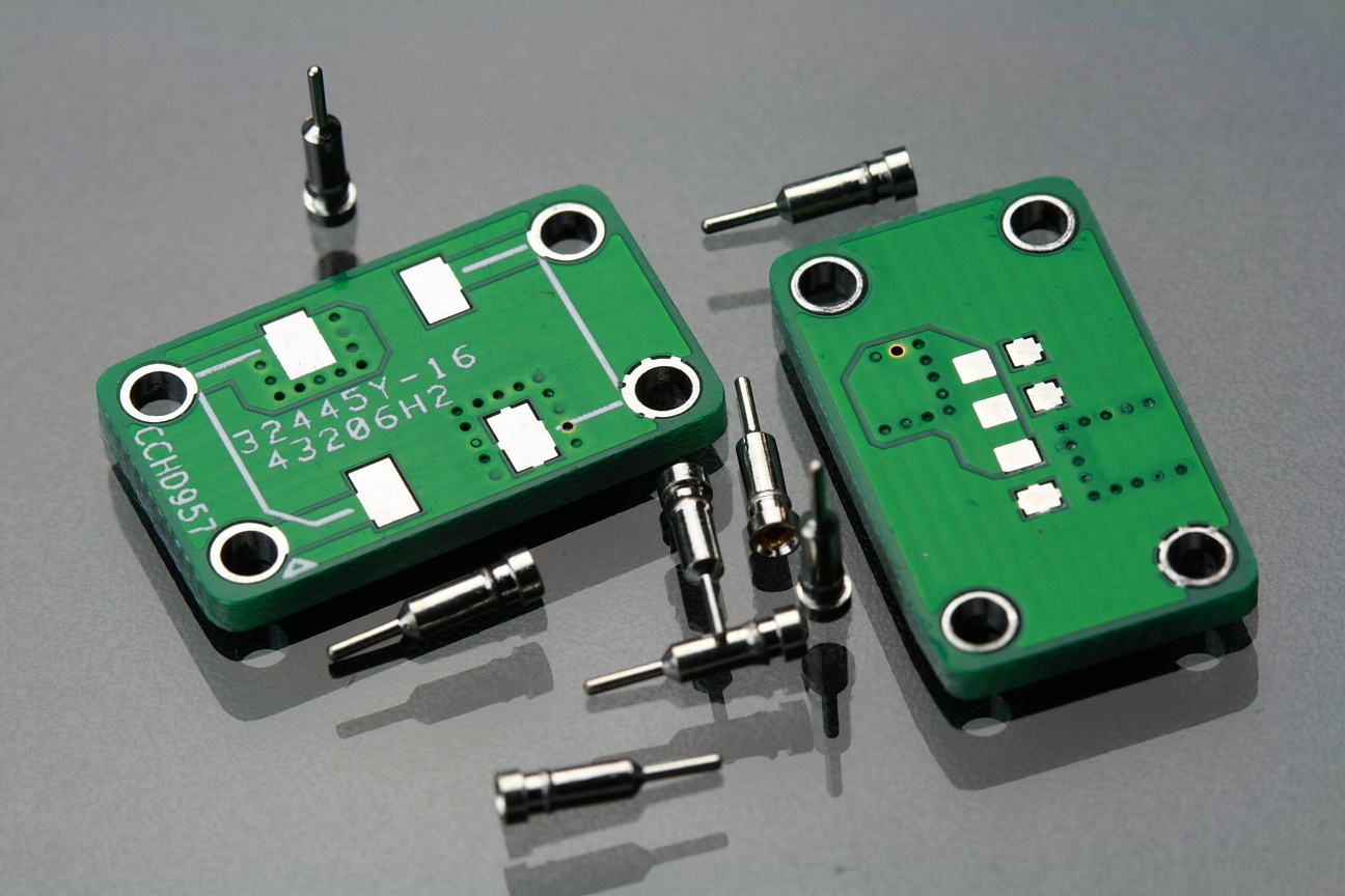

Of course you can solder it directly to a 14 pin IC socket by wires, but I think making an adapter would be much better. I got the adapter PCB today. The assembling is easy. First, I solder the CCHD-957 on the top of the PCB, then, flip it over, solder a 1n, a 104 and a 1u bypass capacitors on the back. And then, plug in four IC pins into the corner positions of a 14 pin IC socket and fit them into the four holes from the back of the adapter PCB. The last step is soldering the four pins to the pads at back. Now, with the adapter, CCHD-957 could be used as a standard 4 PIN DIP XO at anywhere.
I put both 22.5792 MHz and 24.5760 MHz CCHD-957 oscillators with adapter hookup into my double XO FIFO clock board. It looks nice. I caught cold yesterday and lost some listening sensitivity. I will do some comparison test on them once I’m getting better.

looking good as always Ian, if i were to need an adapter for a clock, i would want it to look like yours =) is there any reason why you didnt use FFC/FPC all round for the ribbon type connections rather than a mix of regular crimped larger pitch ribbon and FFC/FPC? which brand did you use, hirose? any facility for shielded?
perhaps to allow more legacy type support for older dac modules you have? as they look to be in parallel to the u.fl so i guess that would make sense
Thanks qusp,
Yes, exactly, that's the reason. To interface with legacy DAC or other finished PCB, connecting the wires from classical PH2.0 mm ribbon cables would be much easier than from FFC/FPC. But any way, if it is possible, I would be highly recommended to use the U.FL connectors and cables for better signal quality, EMI performance and less space taken. You can use either of them because they were paralleled each other.
The U.FL connectors on the double XO clock board are from I-PEX, thay are 100% compatible with those from Hirose. Hirose U.FL - Wikipedia, the free encyclopedia
Actually I tested samples from both and all of them are good. But personally I prefer I-PEX because I think gold plating would be a bit durable than the silver plating 🙂 . However, I-PEX could only be sourced from dealership.
The FFC/FPC connector on the clock board is only use for internal connection between the FIFO so there is no need concerned about the compatible problem.

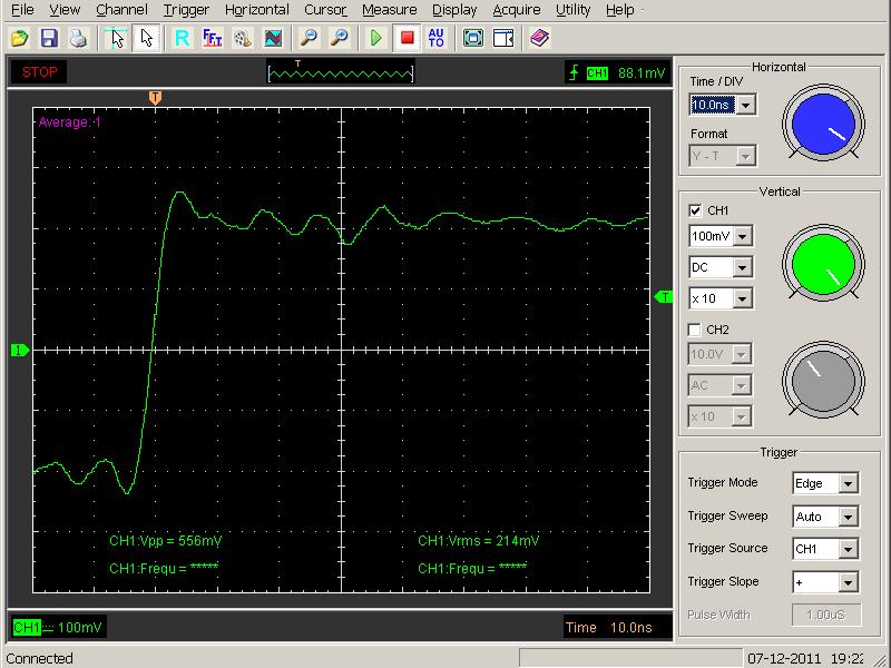

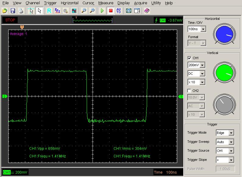

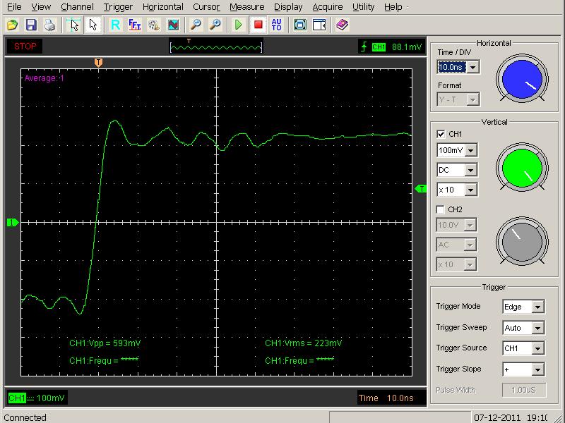

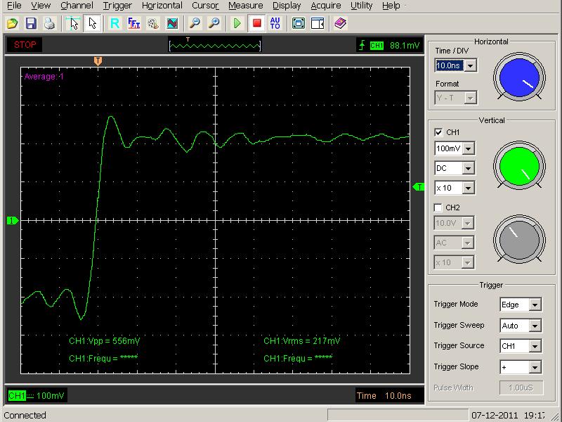

After seeing your waveform, I re-did the transformers test this evening by my regular 200Mhz bandwidth USB oscilloscope with 10ns/div and recorded the waveforms of PE65612, S22083 and S22160. The measurement point was at receiver side, after 5 feet 75 ohm coaxial cable with 75 ohm termination. My results were bit diffenent from yours. I atrached the waveforms just for reference. Yes, the PE65612 has a bit faster raising edge (but just quicker around 1ns ), not as that much as what was shown in your waveform. I tried both LVPECL driver and low jitter dedicate fan out buffer, the results were almost the same. It seems on your S22160 raising edge, there was a corner, usually this case was caused by the performance of the driver? which driver did you use? Could it delivery enough current at very high speed? Please note that that the primary inductance of PE65612 is 2.5mH, but the S22083 and S22160 are just 225uH. But any way, PE65612 is already good enough for many applications and has been quite standarded digital transformer for SPDIF.
Ian

Unless you have checked the system and particularly the scope I would not put too much analysis into the fast rise time abberations. It possible that the overshoot and preshoot are even in the scope itself (another ADC with many of the familiar digital issues). One is faster than the other but that may be as far as you can tell.
I have had to invest in a lot of stuff to be sure my instruments aren't lying to me.
