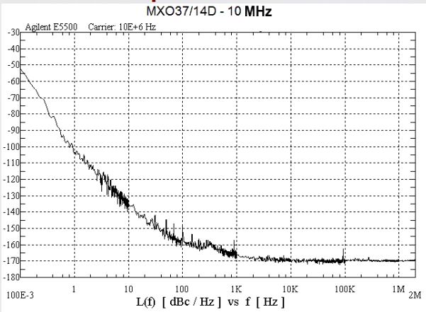

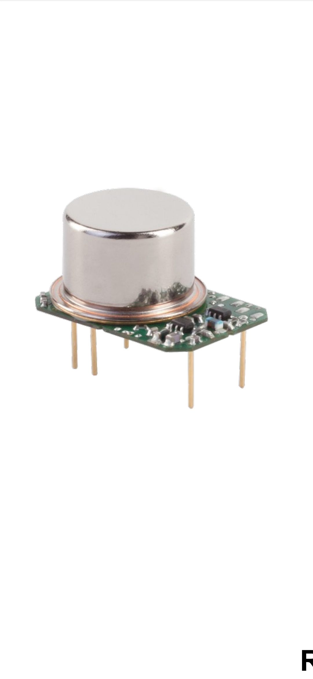

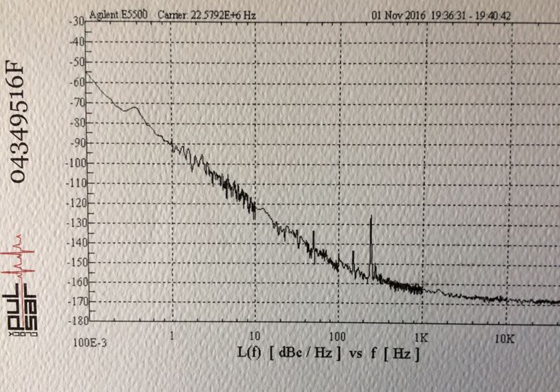

Amazing. It looks identical to Ian's Pulsar clock shown in the Q3 photo:
10 MHz:
10 MHz:

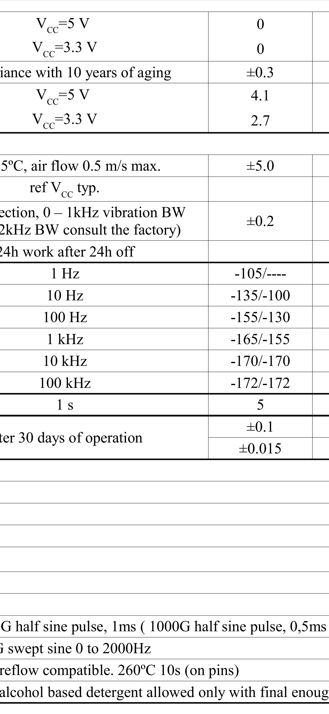

Exactly !
Do you have a more clear picture of the phase noise plot?
Ian

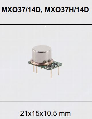

Unfortunately, no. They have a PDF, but will have to contact them to see if they have any updated plots.
http://magicxtal.com/upload/uf/df1/MXO37-14D(en) 12.pdf
A few DIY members mentioned there's re-badged Pulsar clocks out in the wild or in this case it's Pulsar OEM.
I'm just an end-user / messenger so hopefully in the next six months can learn more about this possible upgrade before getting upgraditis around that time.
EDIT: The photo in the PDF looks even more like the one in the Q3 photo. There's just no "Pulsar" stamp labeling on top.
I was one of those who mentioned it. I had been looking at it ~2years ago..
Just for curiosity. Yes, these are identical.
Also the phase noise parameters are equal to those cited for Pulsar..
I think the Pulsar project really was a group buy adventure.. But for some reason did not hold..
Ciao, George
Ciao, George

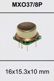

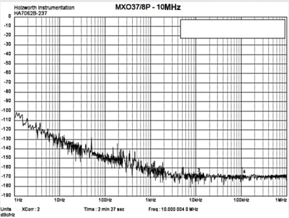

MX037/14D, MX037/14 ?
MX037/8P looks better.
