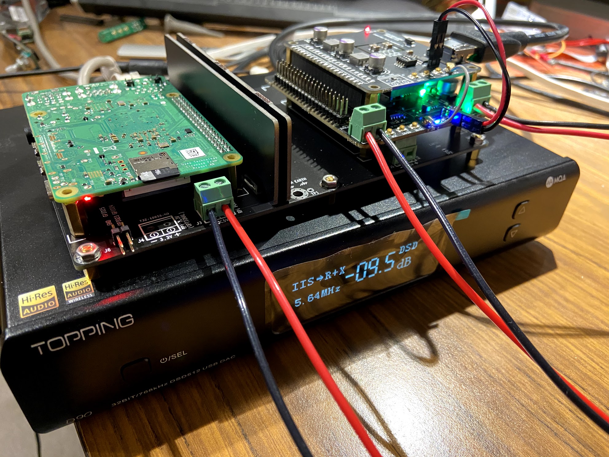

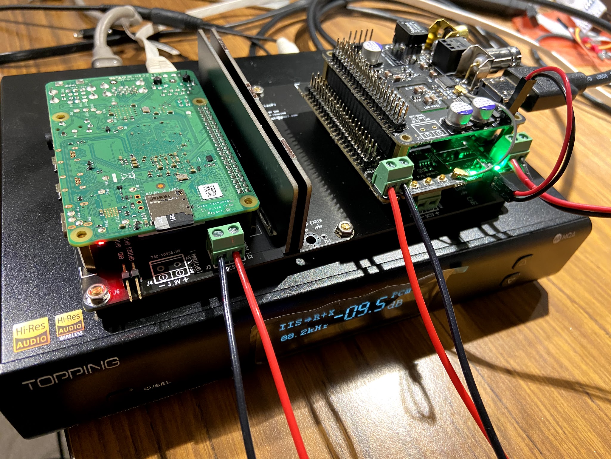

FifoPi Q3 - HDMI - Topping D90
FifoPi Q3 has an isolated DSD_EN signal. So I confirmed there is no problem working with Topping D90 or other exteranl DACs that need this DSD_EN signal to switch between PCM and DSD.
Both HdmiPi and TransportPi can be used for this application through a HDMI cable. A small two pin cable is also needed to connect the DSD_EN signal from FifoPi.
The only issue is that D90 has click noise when change between DSD and PCM. Just hope they can fix this issue by upgrade the FW.
Good weekend.
Ian

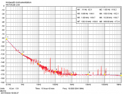

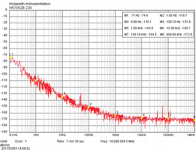

The MXOCI line has 10dB lower phase noise at 1; 10Hz..
Not small difference. Actually, with 1Hz /-120dB, 10Hz /-145dB , at 10MHz, it starts to be tough competition..

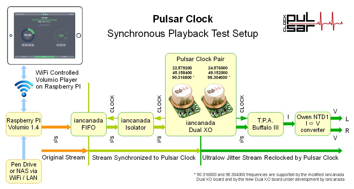

Original Pulsar Clock Datasheet:
Available in a wide selection of audio frequencies Designed for High-End Audio DAC
Makes digital music a unique listening experience Ultra Low Phase Noise
Femtosecond Jitter
Very Low Power Consumption
Fits into DIL14 Clock Sockets HCMOS Output
Easy Installation
Laser Etched Serial Number
I'm guessing "HCMOS Output" is the option to choose for this potential buy since there's a few output options.
