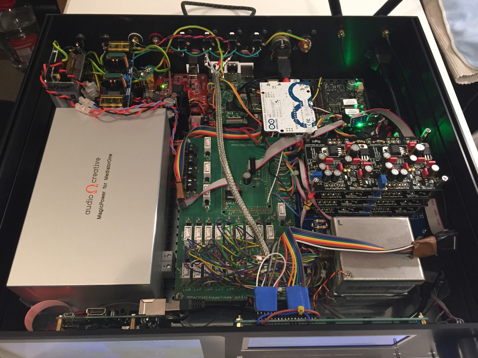

I can confirm this. In my personal "at home" DDDAC version I use the FiFoPi to take any I2S source and send it on to the DDDAC I2S input.
I made the sources selectable:
1. PI 3B with Ropieee (but you can do without of course ;-)
2. WaveIO for USB input
3. SPDIF
I tried some SPDIF to I2S converter and my old ears could not tell real difference between PI and waveIO when it went through the FiFoPi (as expected)
If the SPDIF - I2S output is connected directly to the DDDAC I can tell the difference - so the FiFoPi does what is has to do for me.
I use Accusilicon clocks by the way - till I have some serious listening test on a DDDAC from someone else with different (and better clocks) 😉

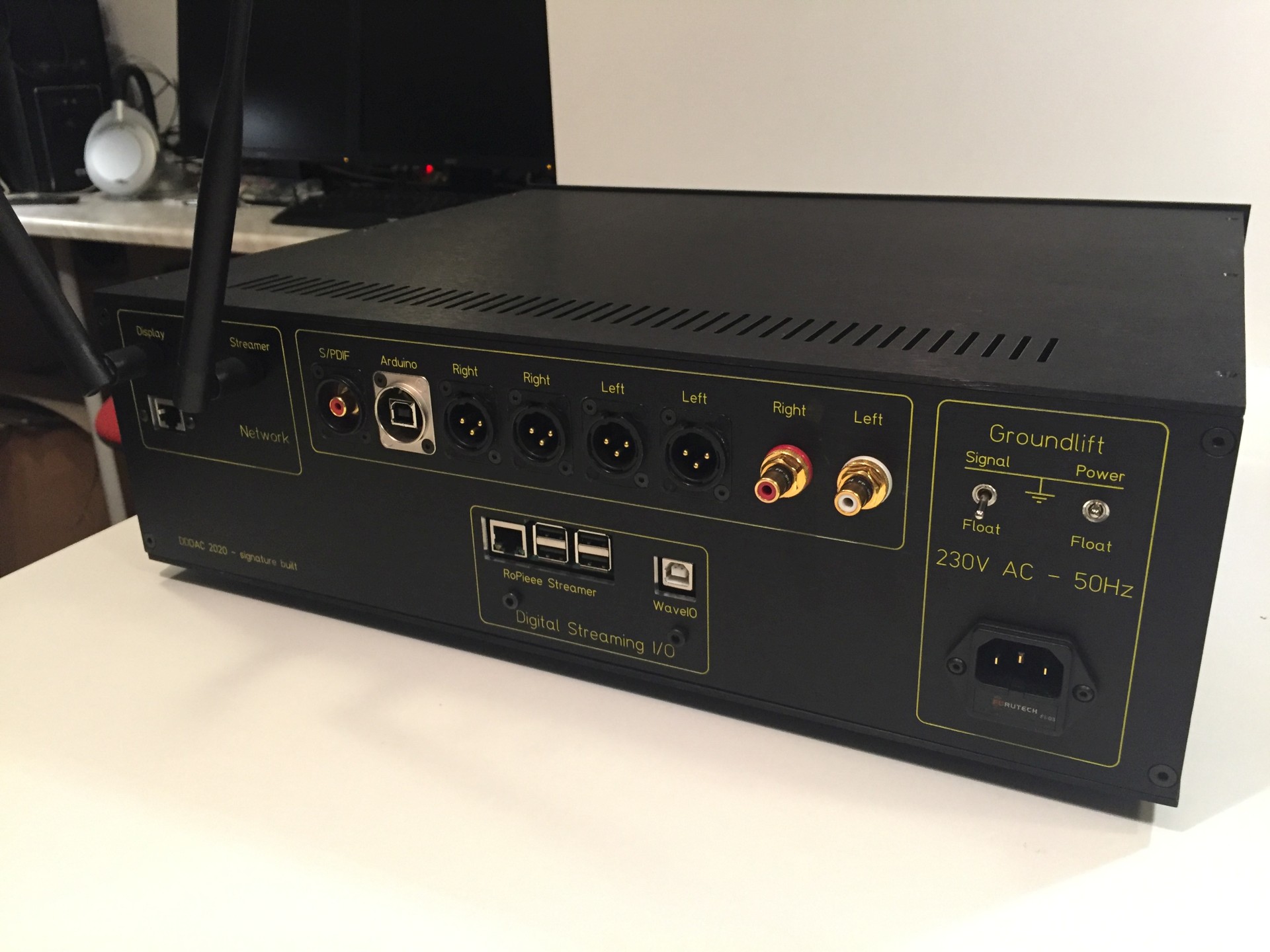

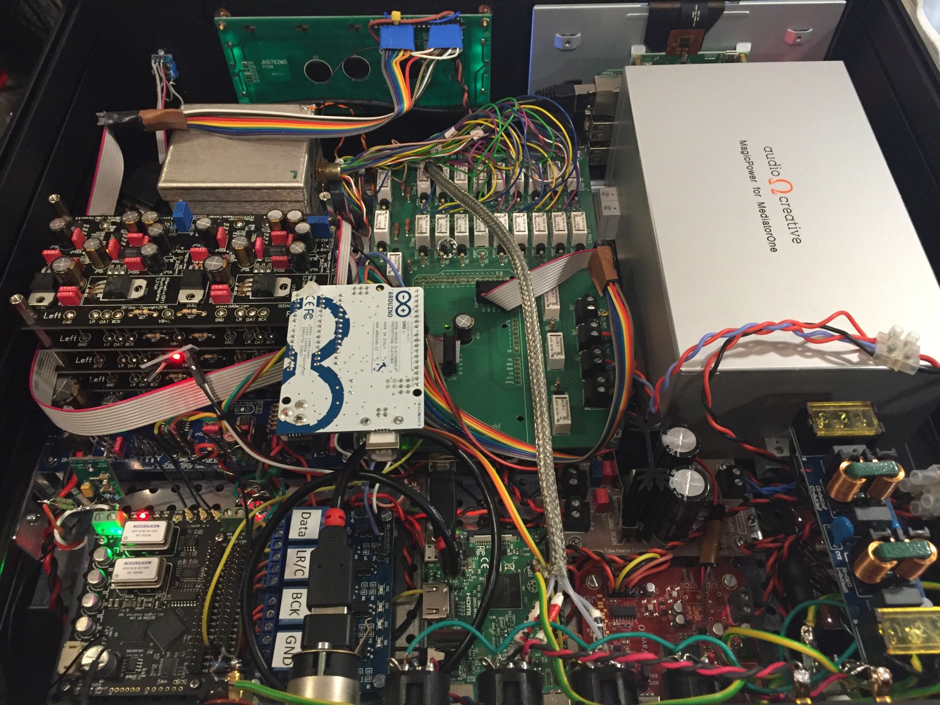

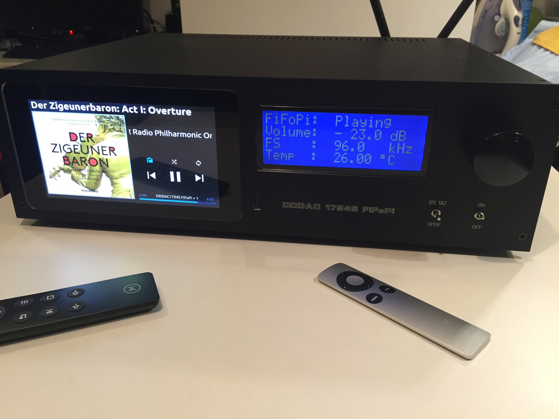

@DDDAC
Looks fantastic! Such a good job!
You have two screens, one from RPi and the other from Arduino, Am I right?
What's the Arduino for?
Your DACs are in parallel, TDA1541 or 1543?
Thanks for sharing your project!
Ian
Thanks Ian, there is also a dedicated thread on this DAC concept.
It is based on parallel PCM1794 running in non digital filter mode.
The Arduino does the TVC volume control, shows the sample frequency plus all kind of other controlling of IR remote, front panel switches and controls inputs, system check etc.
Audio Creative also did some great work with your FiFoPi /audio-creative.nl projecten 2/

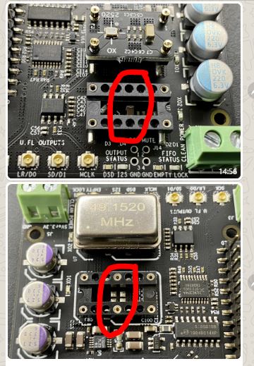

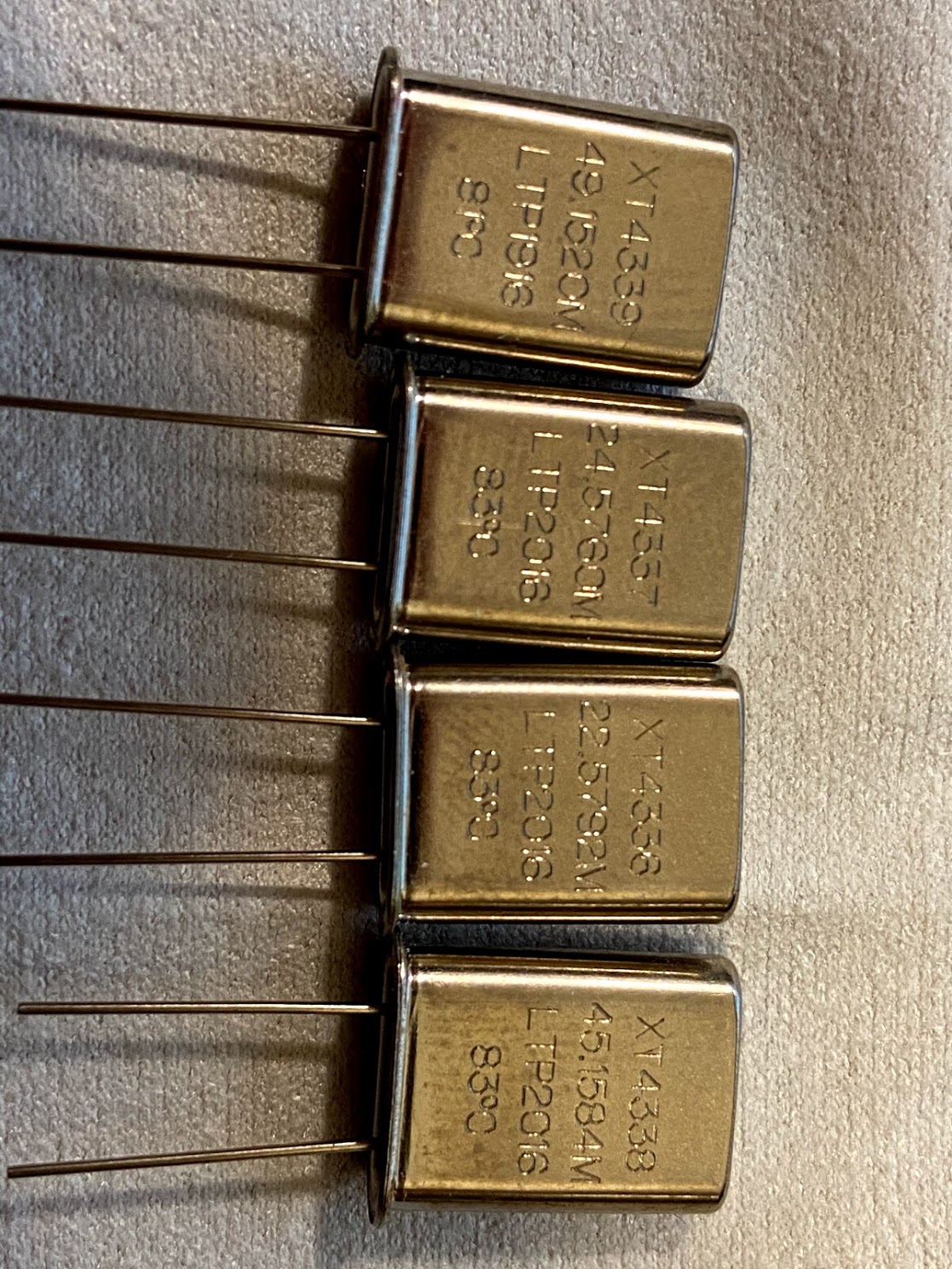

Hey Ian,
seems you removed the connections for the small square layout XO clock versions ? Any rational for that?
Just want to make the grounding areas bigger and more continuous under the XO sockets. That's very important to lower the ground impedance for high frequency clock signals.
You can insert two round pins to the holes of the sockets if you really want to use those square XOs. I can give you some of the pins next time if you need.
Ian
thanks Ian - are those pins available at Mouser/Digikey and co? Or you just pull them out of the DIP Socket?
