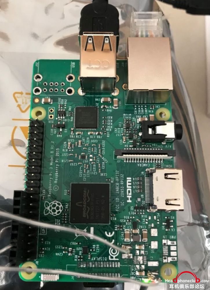

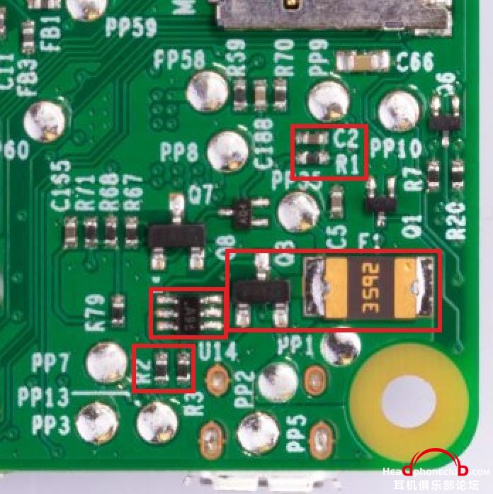

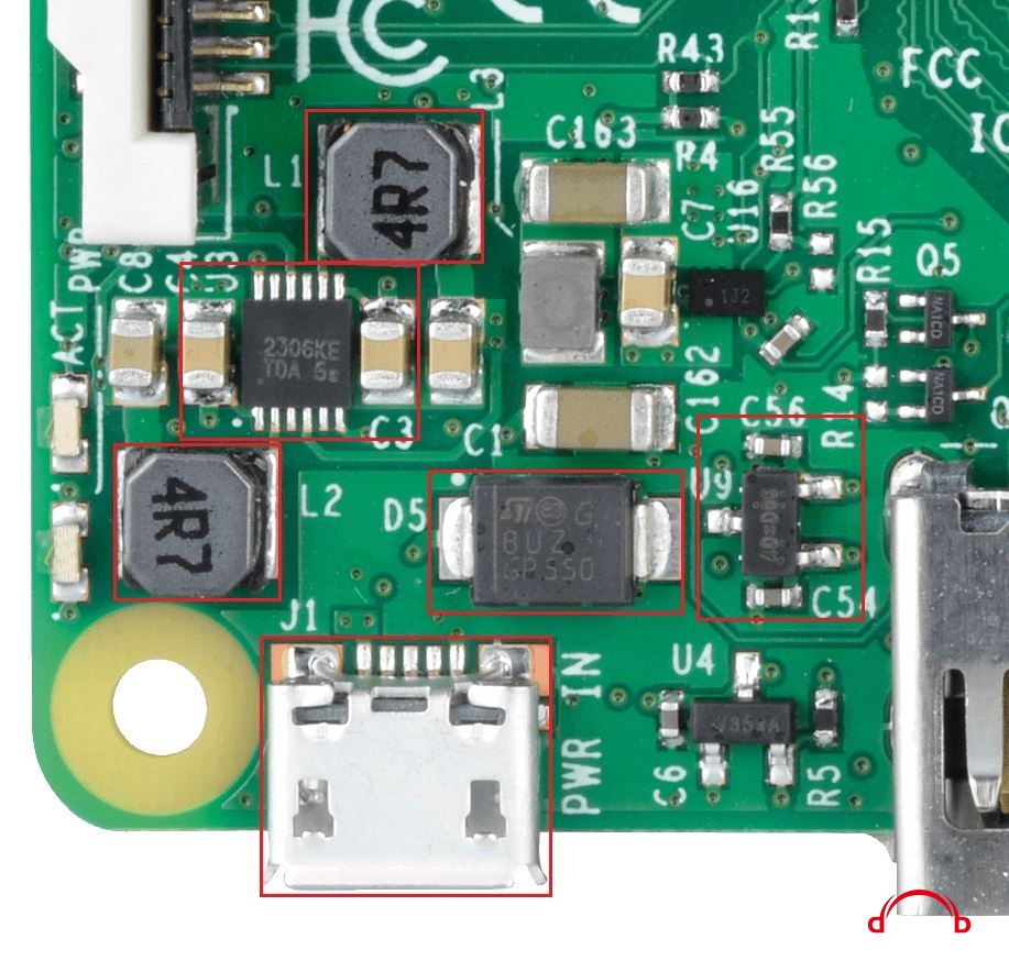

If you want to improve the Raspberry Pi's noise problem, in fact, the improvement method is not from an external power supply, nor is it to buy StationPi, but to remove the very bad built-in DC-DC power supply of the Raspberry Pi, and then supply power separately from the outside PP5: GND, PP7 : 5V, PP8: 3.3V and pp9: 1.8V. That is, first remove the built-in DC-DC power supply of the Raspberry Pi in the photo. For details, please refer to the Raspberry Pi manual.
Schematics - Raspberry Pi Documentation
You describe it perfectly what is the problem with the Raspberry power supply, and I wonder if anyone has done what you detailed, inputting new precision regulators into each PP.
Is anyone doing that in this thread, or has done it, or they just isolate the power pins galvanically from other stages, so you can power them separately?
I have heard of a new Pi power supply that apparently iancanada had developed or was developing, supposedly correcting that Raspberry weak design area, which I don't know if it's true.

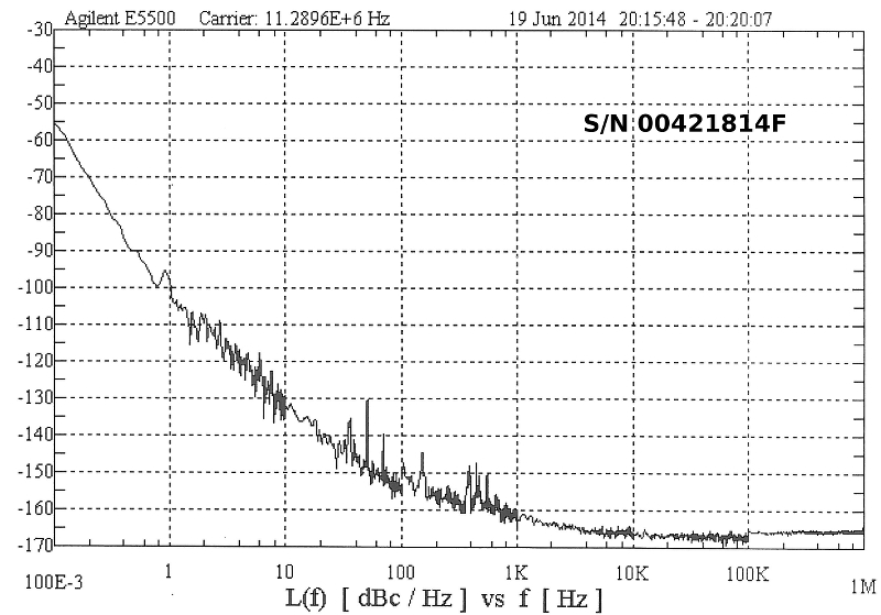

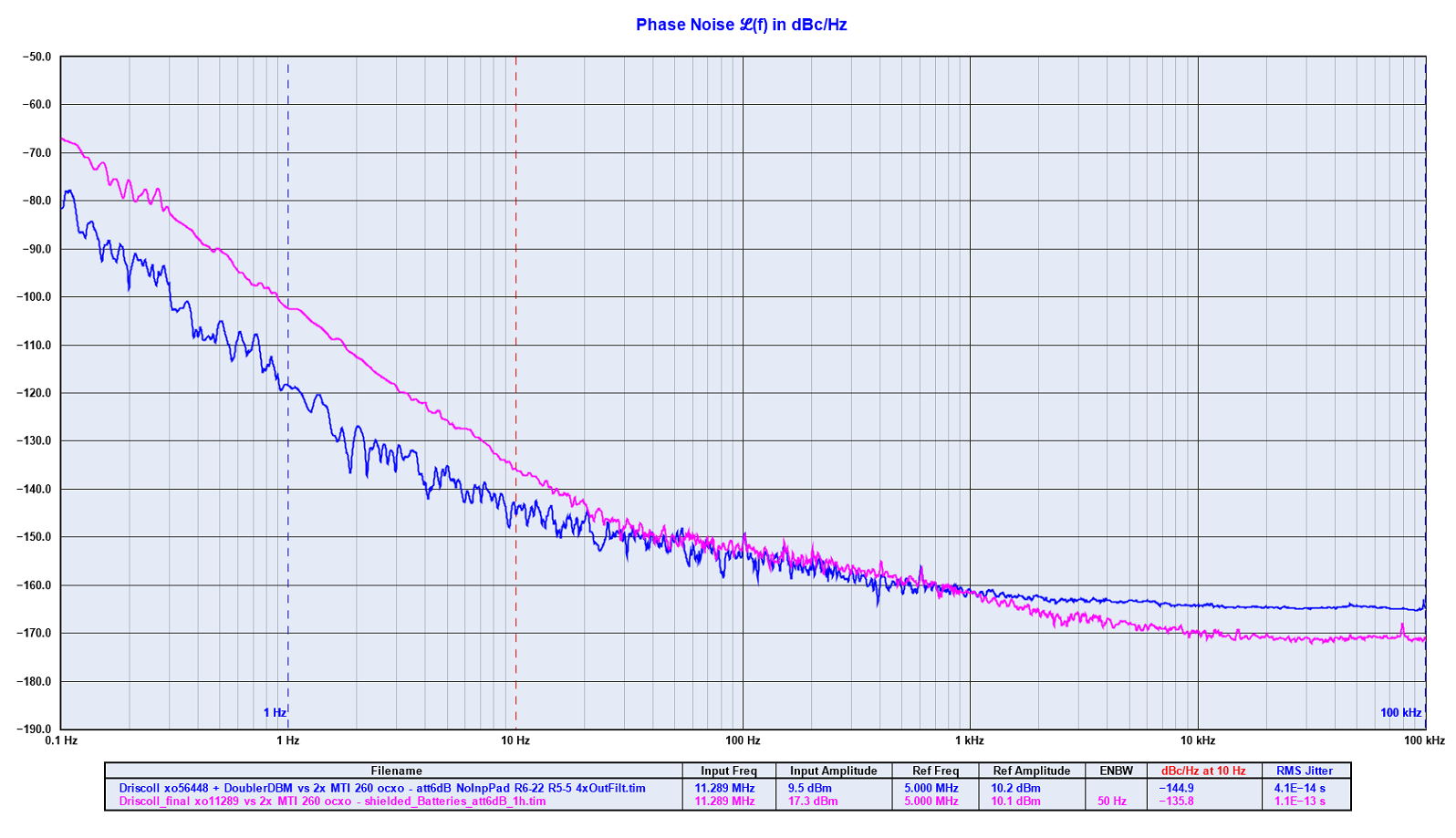

Are you sure? Please compare the following plots:
- the Driscoll oscillator at 11.2896 MHz is around 6 dB better than the Pulsar at the same frequency (pink line)
- the Driscoll oscillator at 5.6448 MHz with doubler is around 20 dB better than the Pulsar at the same frequency (blue line)

Looking at the real crystal osc. data:
Pulsar. MORI
1Hz. - 101. - 102
10Hz - 132. - 136
100Hz. - 155 - 152
1kHz. - 161 - 161
I think it's a real achievement, from a russian tech company, in ~1. 5cm^3. (Pulsar was just rebadging..)
Most of the Pulsar phase noise plots I have seen were better than the claimed
specs. I think Morion (Russian) are better again but you have to pay for it.

Are you sure?
For my current situational keep in simple minimalistic needs, yes. The Pulsar Clocks are compact and somewhat plug and play. No external board and no 12V power supply.
If there was a compact plug and play TWTMC 5.6448 MHz requiring no external board and power that of course would be more optimal. But given my current project and the legendary Pulsar clock performance, it would be a dream to have Pulsar clocks.
For future projects, the main focus will be TWTMC 5.6448 MHz. But for now I have to work with minimalistic constraints.
