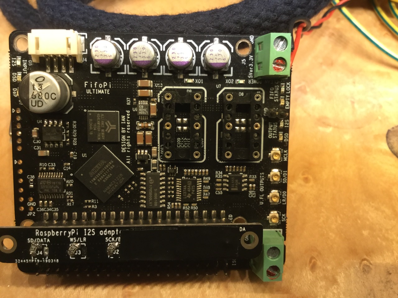

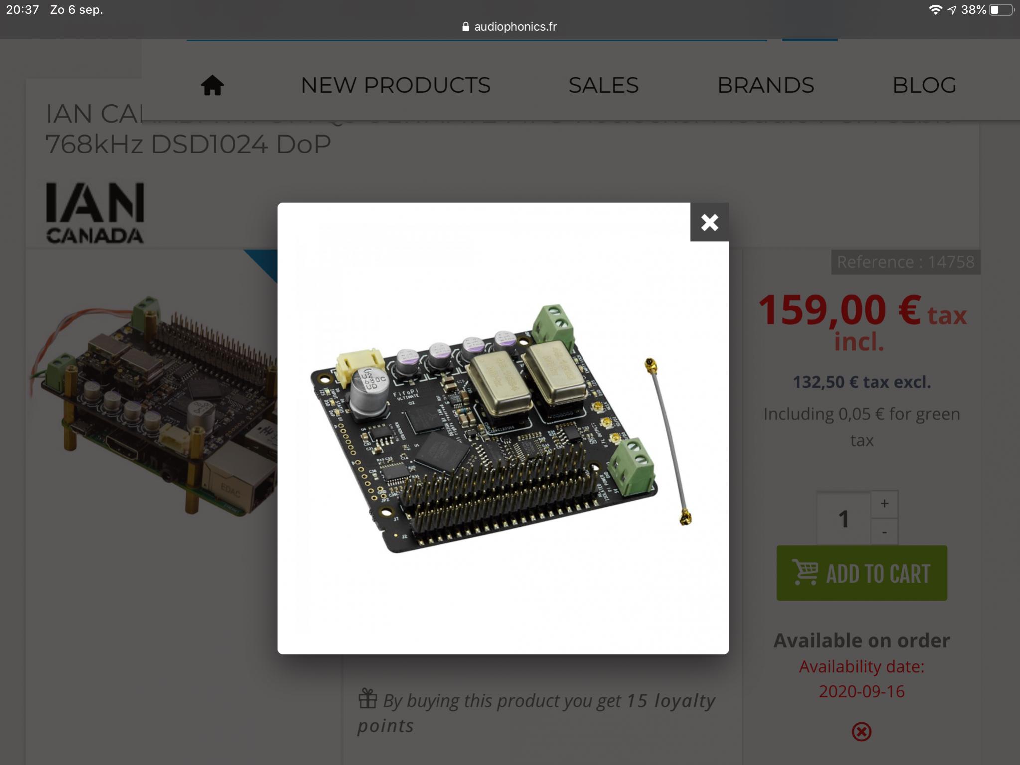

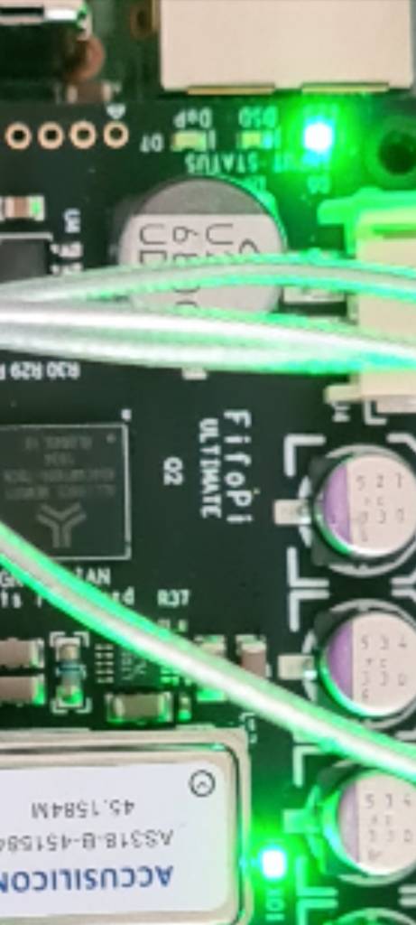

You can see it on the board written under the word ultimate.
I have the first edition, on the Audiophonics site the Q2 version is shown on the Q3 order field.
See pictures.
@Ian, on the Audiophonics website they announce the Q3 version will be available on 16 sept. Is this correct?

@Supersurfer
FifoPi Q3 are under production. Hopefully they will be available in next week.
Ian
