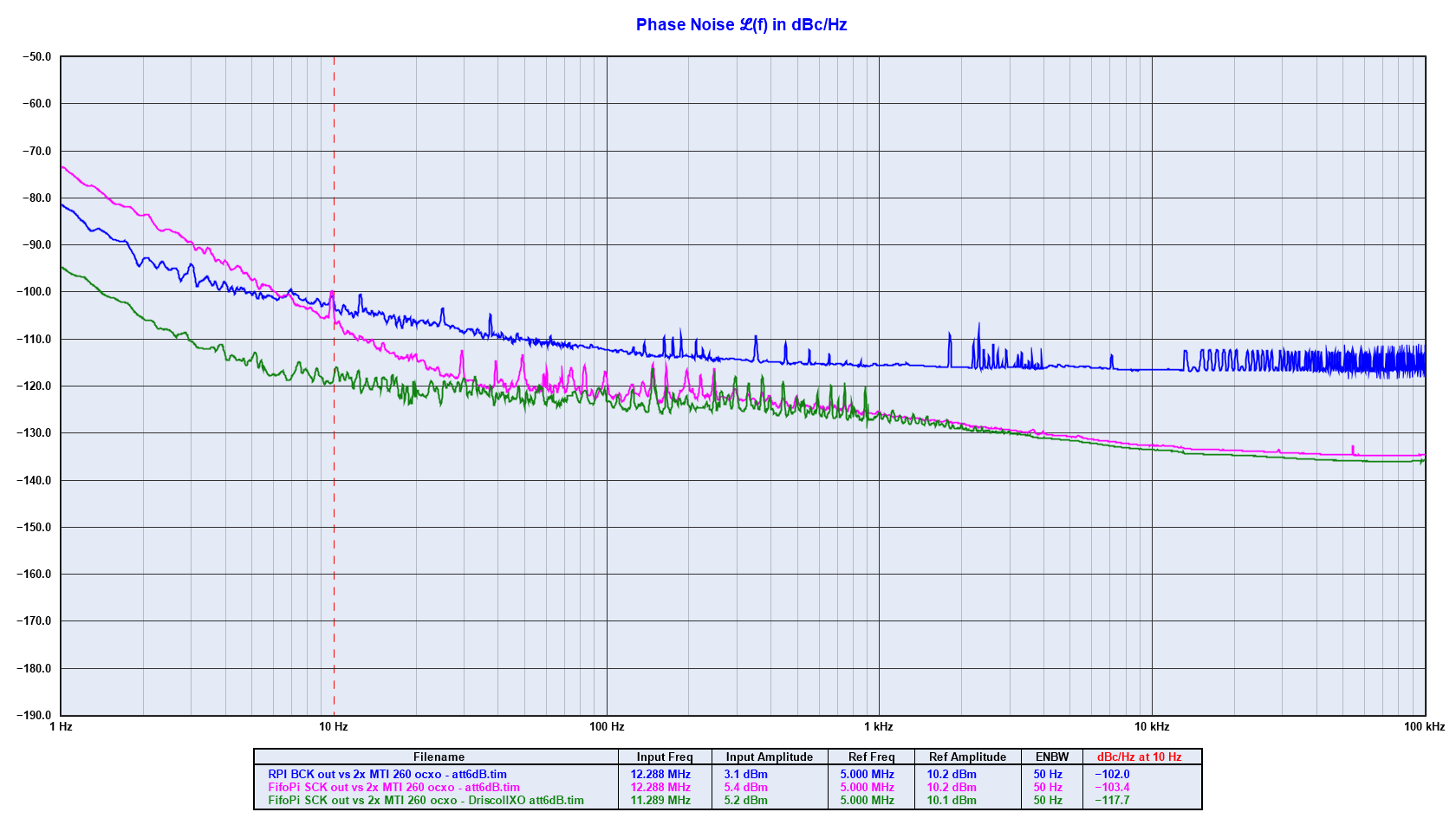

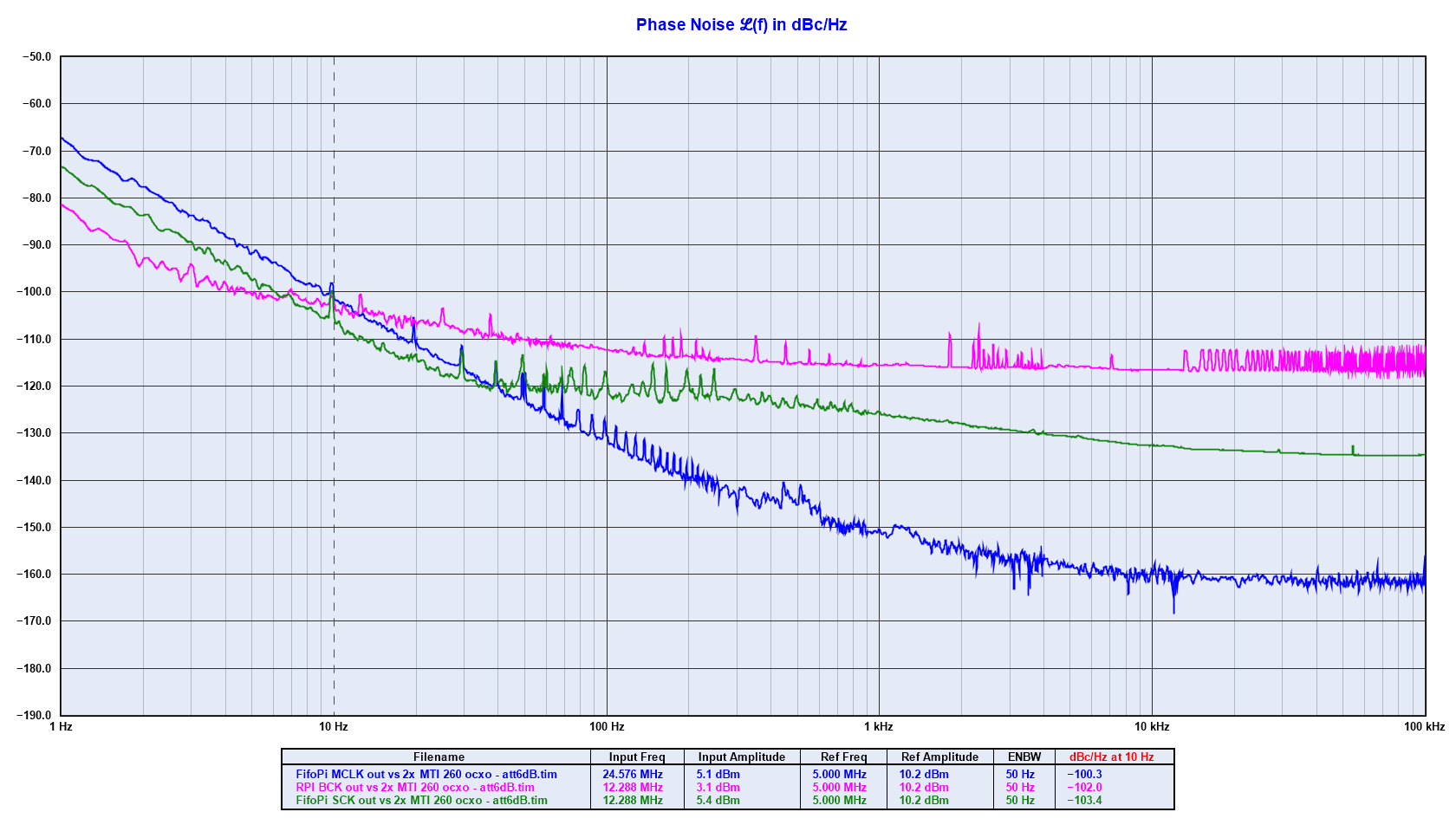

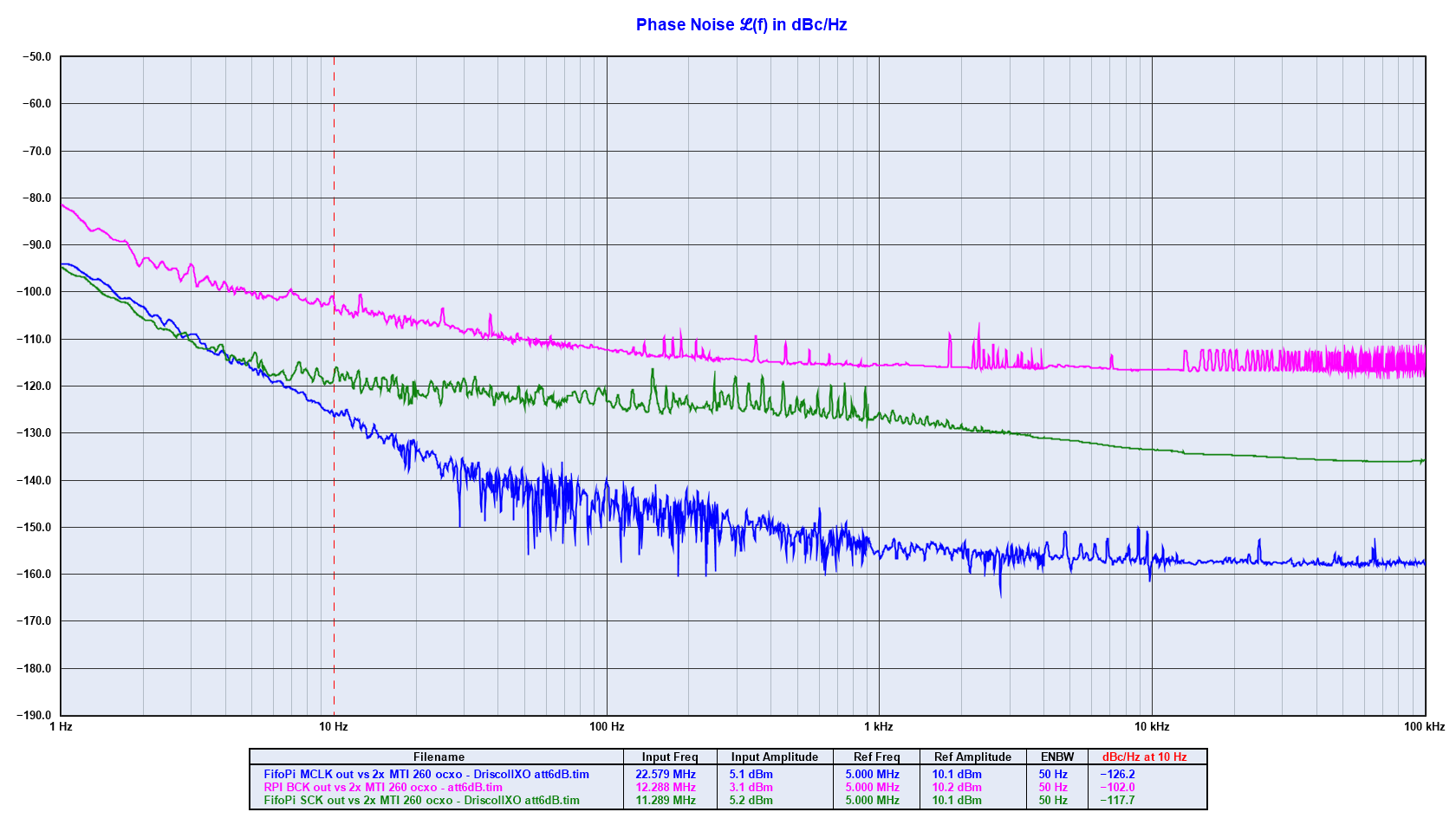

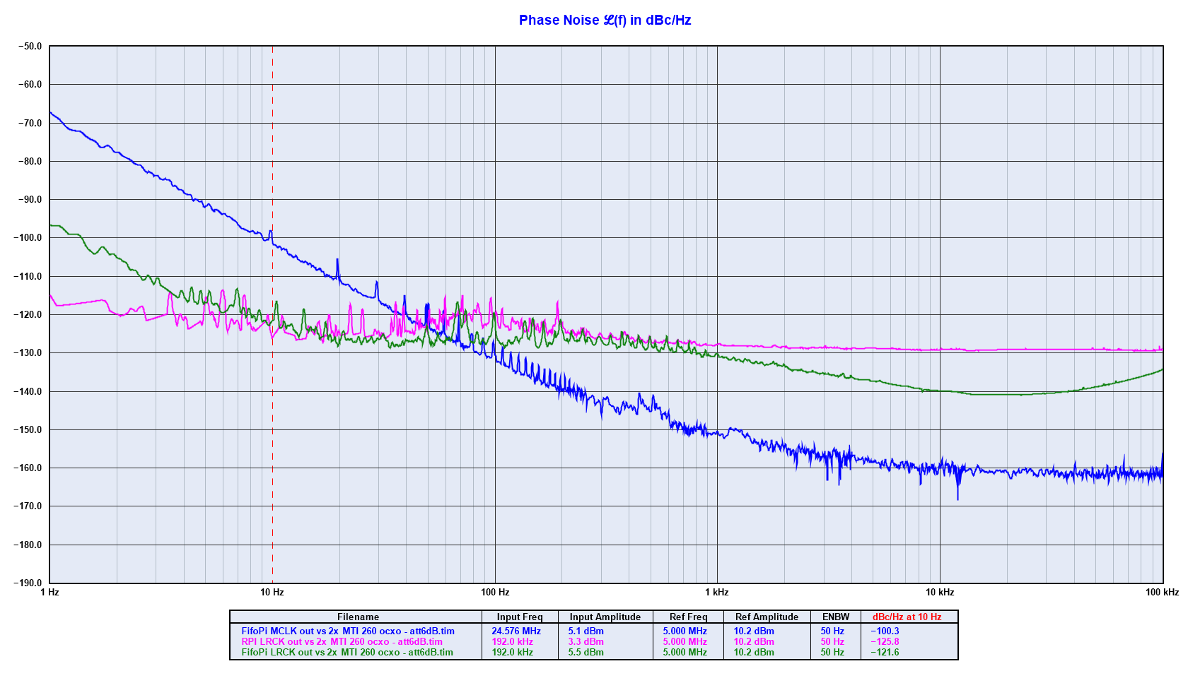

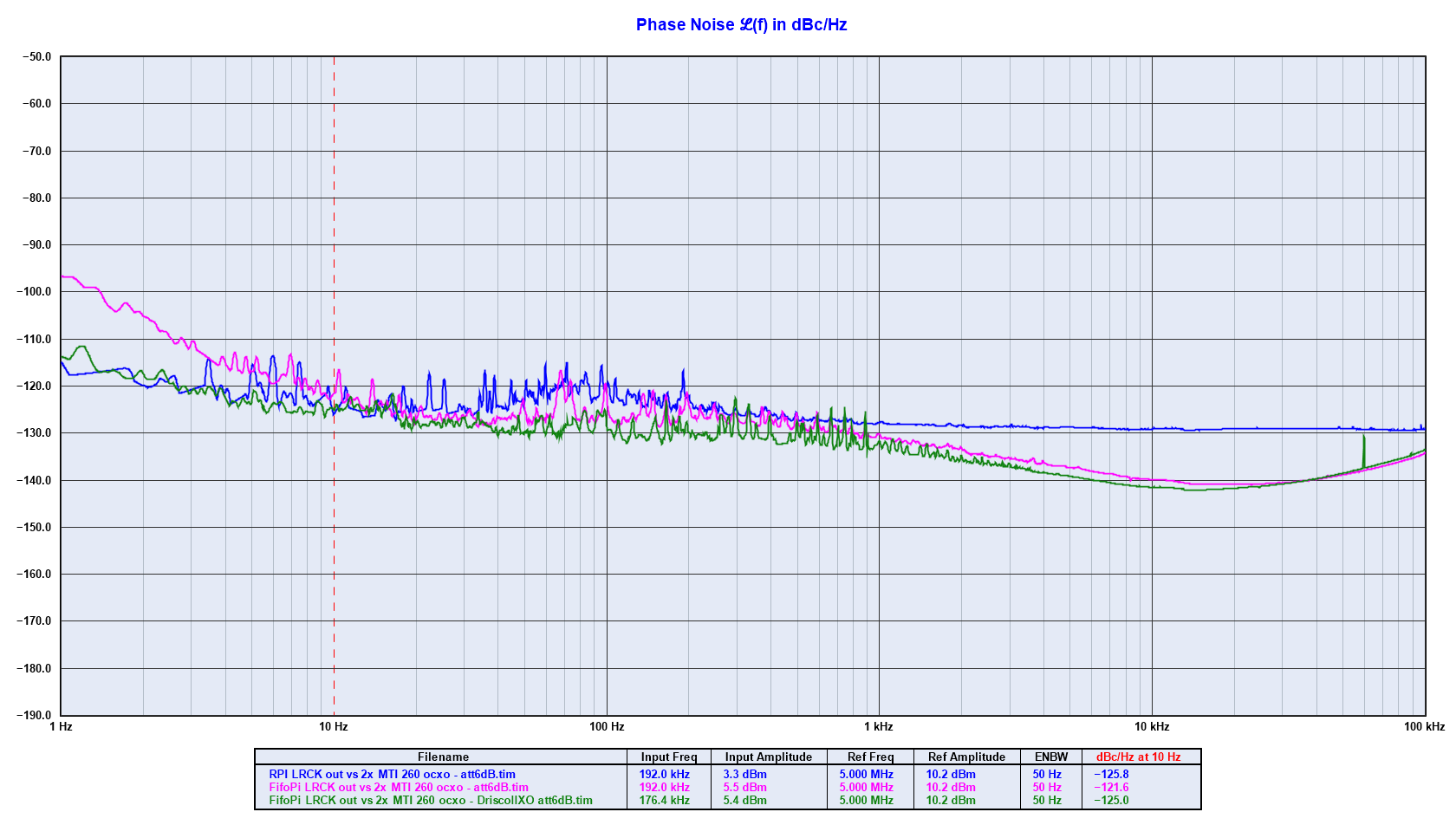

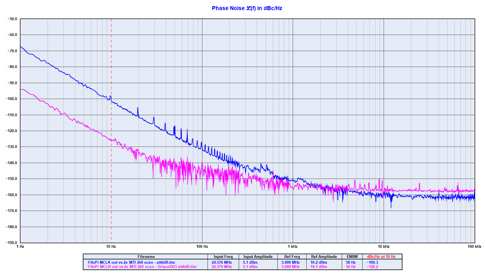

If someone was interested I attach the phase noise plots.
Each picture's title explains what has been measured.
I believe this thread is more appropriate to discuss the measurements.
01 fifopi-mclk-crystek-cchd-957-24-576-mhz-phase-noise-png.png61.1 KB · Views: 676
06 rpi-fifopi-lrck-driscoll-22-5792-mhz-phase-noise-png.png108.3 KB · Views: 220
05 rpi-fifopi-sck-driscoll-22-5792-mhz-phase-noise-png.png113.1 KB · Views: 622
04 fifopi-mclk-crystek-24-576-_-driscoll-22-5792-mhz-phase-noise-png.png96.6 KB · Views: 617
03 rpi-fifopi-lrck-crystek-cchd-957-24-576-mhz-phase-noise-png.png102.8 KB · Views: 603
02 rpi-fifopi-sck-crystek-cchd-957-24-576-mhz-phase-noise-png.png106.5 KB · Views: 674
Could help to show all the good work made
Thank you Andrea,
Could it be possible to attach in a post as above the measurment captures from 1 Hz of the former 2017 Discroll with At-Cut & SC-CUT side to side with the new Discroll board please with these same crystal?
And the new Pierce AT-Cut as well to show how it performs side to side to the former's
Thank you Andrea,

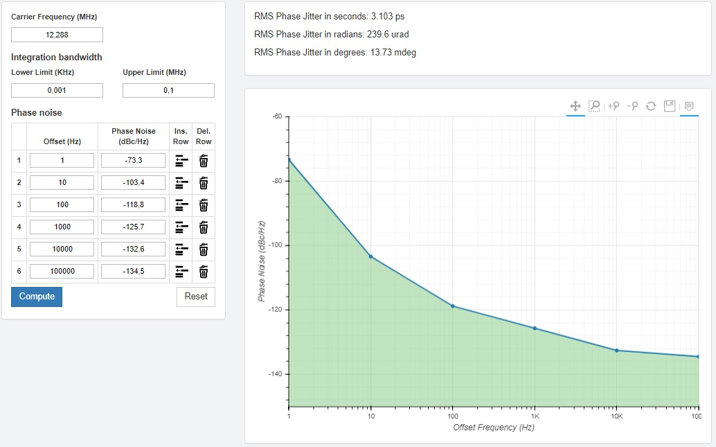

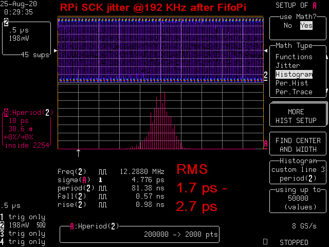

First picture: FifoPi SCK measured jitter is 2.7 ps
Second picture: FifoPi SCK calculated jitter from phase noise measurement is 3.1 ps
Measurement difference: 400 fs (3.1 - 2.7 ps)

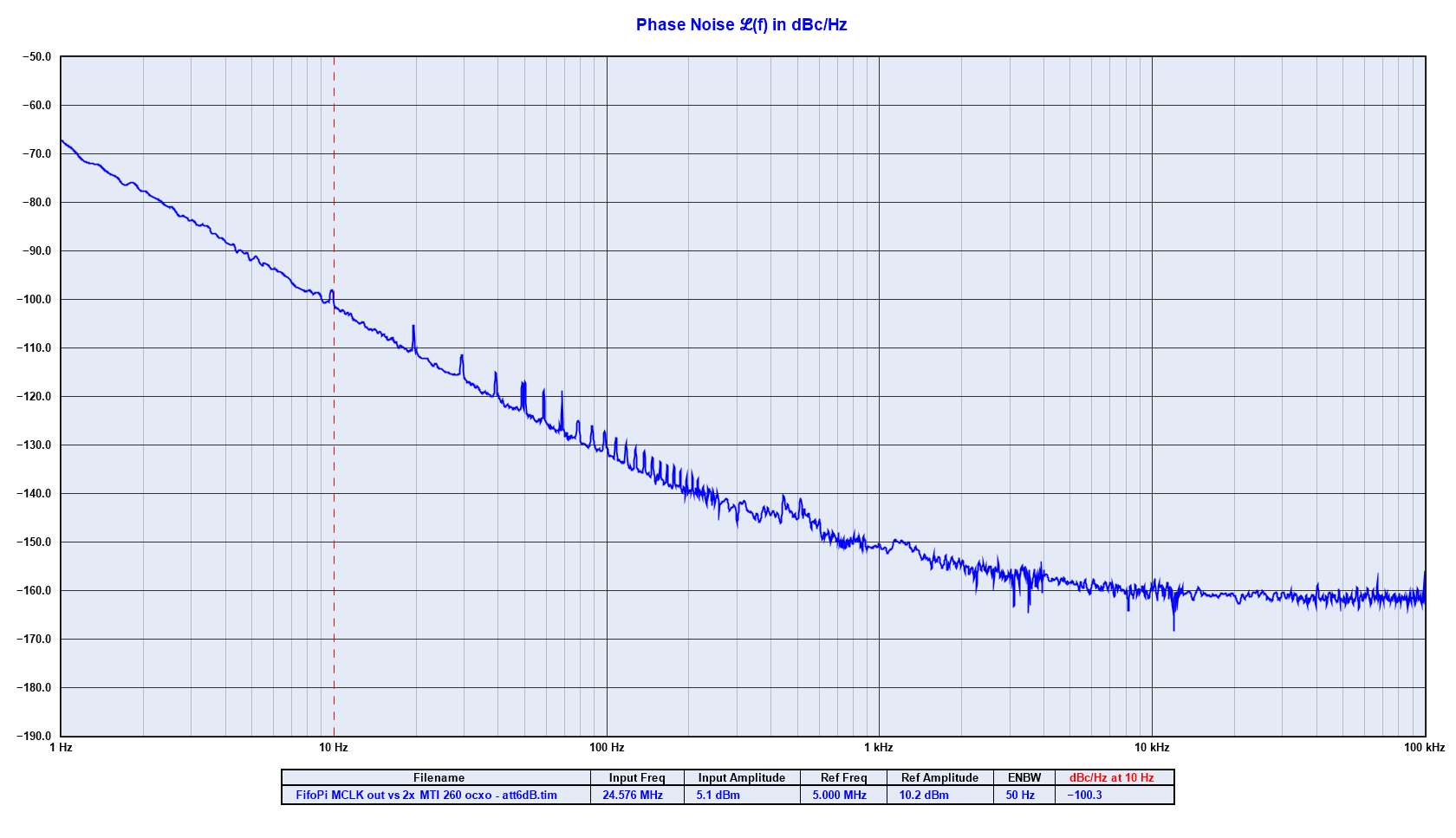

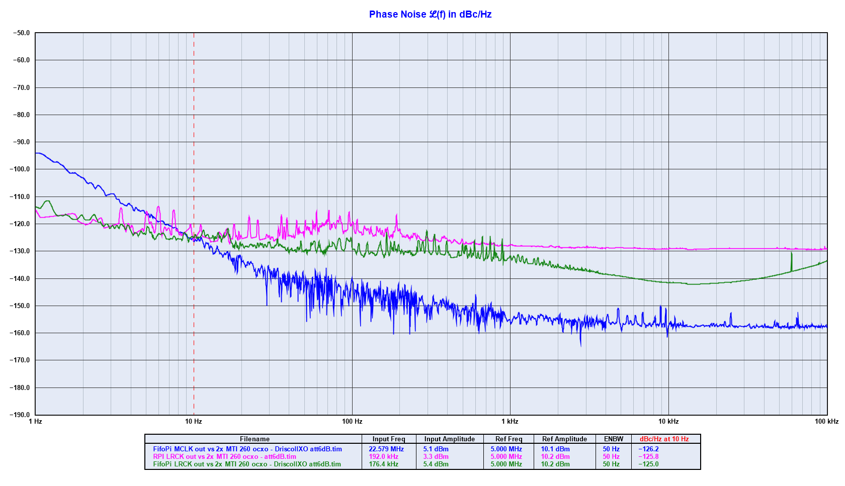

Third picture: FifoPi measured phase noise (used to calculate jitter), green curve drives PCM1794, PCM1704 and so on.
Crystek 24.576 MHz master clock noise floor is -160 dBc, FifoPi SCK 12.288 MHz noise floor is -130dBc, RPI SCK 12.288 MHz is -115 dBc

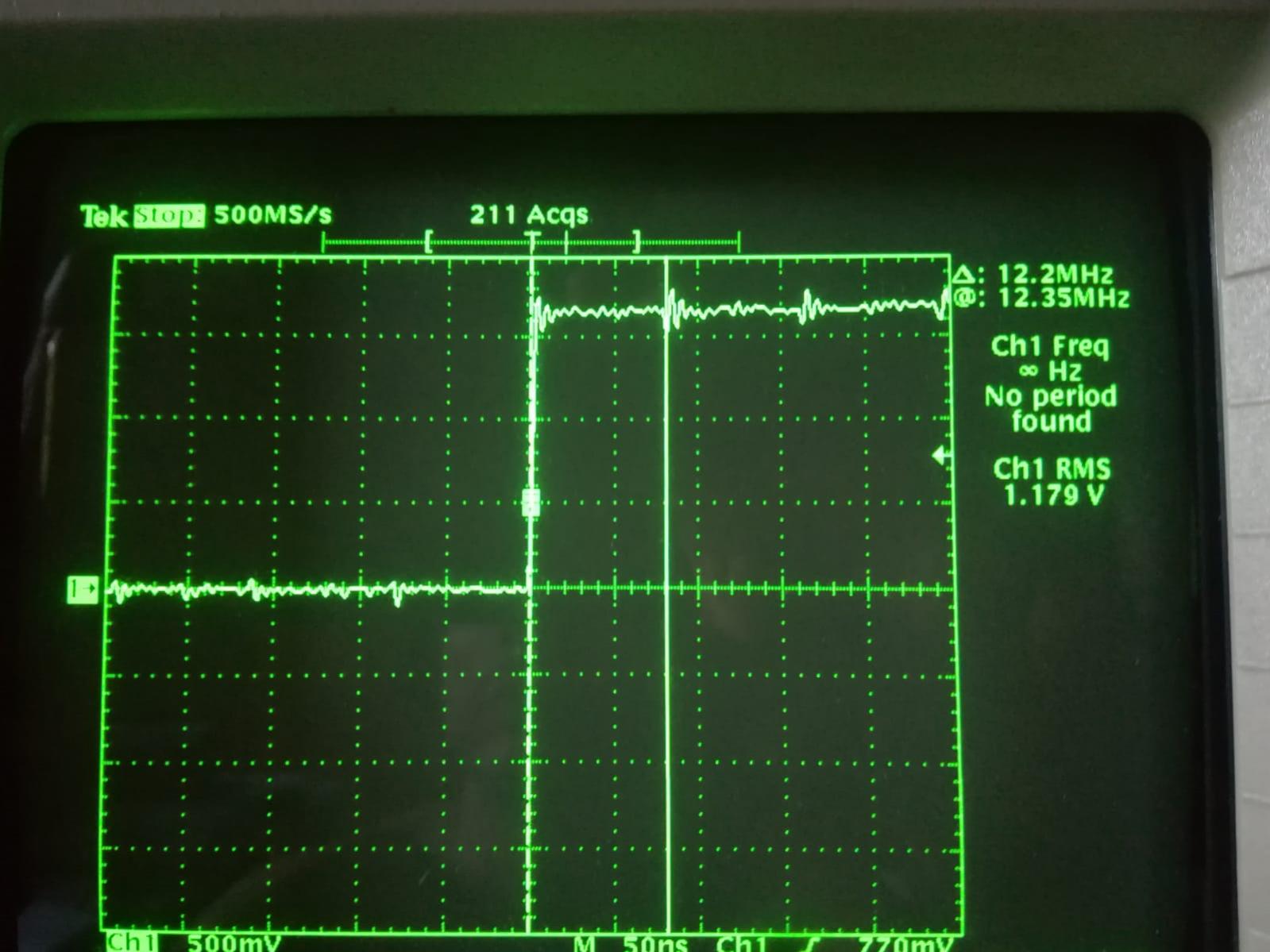

Fourth picture: FifoPi LRCK 192 kHz wave captured with the oscilloscope, there is crosstalk at SCK clock (12.288 MHz), this wave drives TDA1541A, AD1865, AD1862 and so on.
Crosstalk should be removed, the LRCK clock does not need the SCK to be superimposed.
