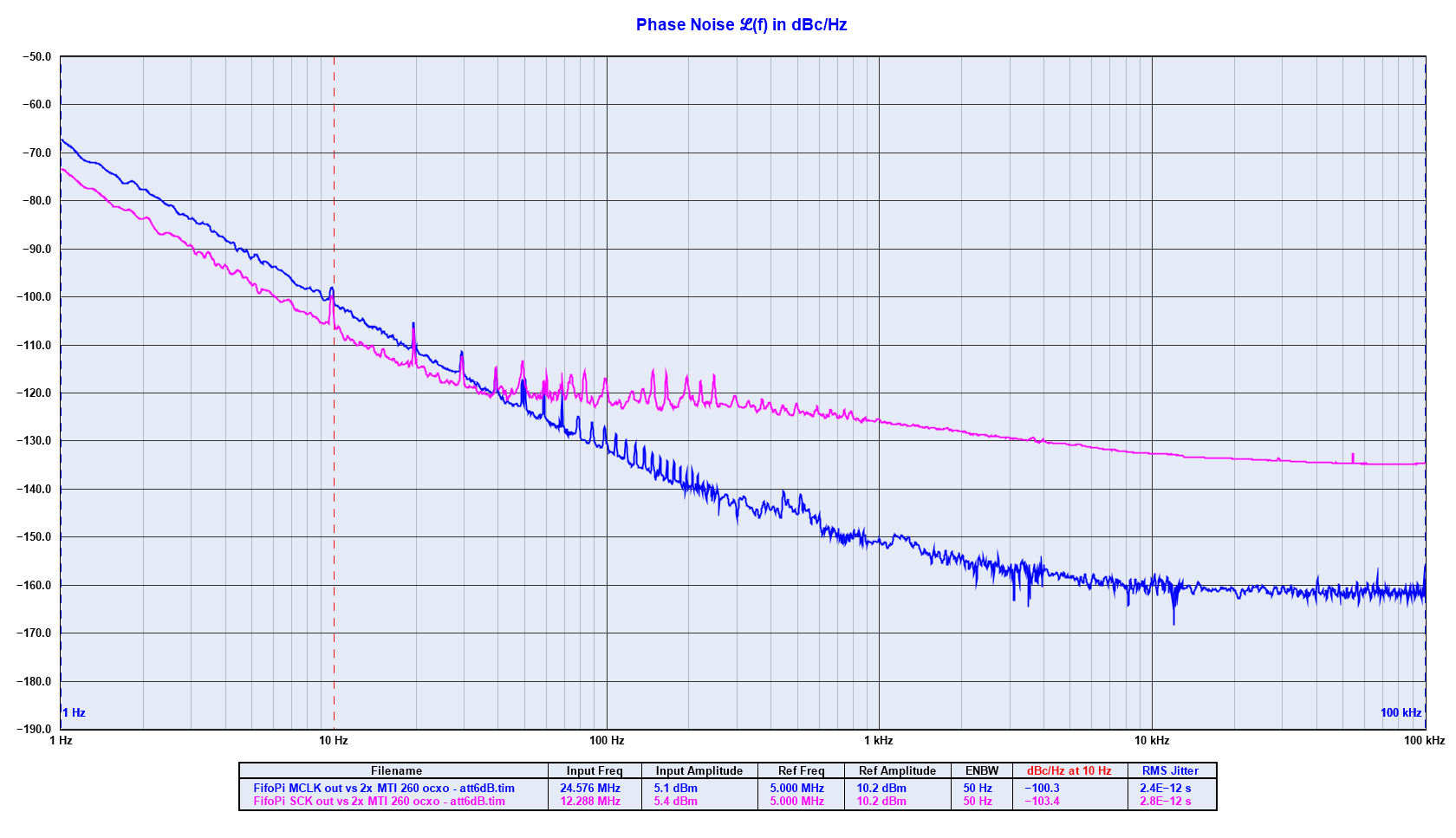

Please, let me remind that I still wait for the analog view of the LRCK after FifoPi with the time division set to 50 ns.
And also it could be useful to see the waveform of the LRCK before the D-FF.
I report here the last post from the other thread, this should be a good starting point to understand the "FifoPi principle".
About spurs and integration bandwidth I suggest a full immersion in the literature you can find at Rubiola.org.
So you will understand the meaning of the power supply spurs and mostly what you have to care about the phase noise at 6 MHz from the carrier (half the carrier frequency).
Moreover you can play with a phase noise to jitter converter to understand that the major contribution to the jitter calculation comes from the close in phase noise and not at 6 MHz from the carrier (that weights nothing).
But as I have already pointed out, if your goal is to remove the spurs from the power supply of the Rpi then you have reached the target.
We have all understood that your real time digital oscilloscope is the reference gear to measure the jitter, so keep out for a while the RPi measurements and focus to the FifoPi SCK and master clock (Crystek) measurements.
Your FifoPi operates in a different domain then we have to assume that it was not source dependent, so the source is not relevant in the investigation.

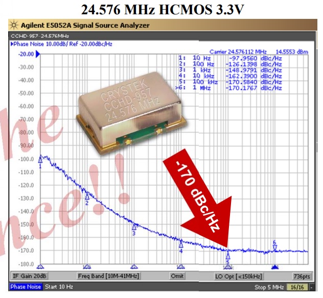

I attach again the phase noise plot of the FIfoPi SCK vs the master clock.
I also attach the phase noise plot of the Crystek CCHD-957 at 24.576 MHz, measured from the manufacturer using an Agilent E5052A (it uses cross correlation to measure the phase noise like the Timepod).
As you can see the phase noise plots are almost equal, the measurement from the Timepod is around 2 dB better against the E5052A. You should know that could be a difference from a crystal to another, mostly if we are talking about cheap crystal. Maybe we have got one of the best.
This means that the measurement from the Timepod is reliable, at least at 24.576 MHz.
Since the half frequency of the master clock (12.288 MHz) is still in the range of the Timepod we can assume the reliability of the FifoPi SCK phase noise measurement.
Now the jitter, as you can see the calculated jitter from the Timepod is almost the same from your digital oscilloscope, a little less than 3 ps.
We have to assume the reliability of the calculation.
A little digression, take a look at this link Crystek CCHD-957 | H i F i D U I N O
They have calculated the jitter with a different integration bandwidth, so the Crystek is more than one order of magnitude better, 120 fs!
What a trick!
This says a lot about the usefulness of the jitter measurement.
But if you take a look at the phase jitter per segment you see that the major contribution is in the 10 Hz region (1 Hz is missing), so you can understand the possible weight of the 6 MHz from the carrier you are pointing out, null.
Back to the topic, I forward again a few simple questions, just in cause you would kindly answer:
- the phase noise measurements of the Crystek are almost identical (Timepod vs E5052A), can you trust the measurement?
- the calculated jitter is identical, can you trust the measurement?
- what does 3 ps jitter explains?
- is 3 ps of jitter the "ultimate" performance to be reached?
- why the phase noise grows above 10 Hz from the carrier?
Please, let us know.
P.S.
Dividing the master clock you should get 6 dB better phase noise. Sometimes the real world confirms the theoretical laws, from 1 Hz to 10 Hz from the carrier the phase noise of the SCK (the master clock divided by 2) is effectively 6 dB better.
So the SCK output of the FifoPi, after removing the noise from the RPi, is improved by 6 dB against the master clock. Good news for the 1704 and 1794 users.

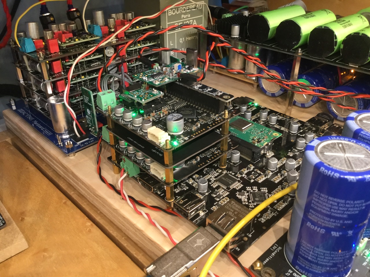

Due to the discussion between Ian and Andrea on the fifopi I have finally (I wanted to do this for a while now) put 2 fifopi’s in series to see if it will benefit the sound.
I will let it play for a while before writing my final judgement but the first impression is that it has an audible effect.
Is there anybody else that has tried this?

I see Andrea clock on top, but what clock did you put in the pre-fifopi ? And what did you actually compare ? Top versus top-with-pre ?
Hi Doede,
For the 44.1khz family the bottom fifopi has a crystek clock and the top one the Andrea Mori driscoll with SC-cut crystal.
For the 48khz family bottom fifopi uses the standard supplied clock and the top one the crystek.
I want to compare the difference in sound with one or 2 fifopi’s.
The fifopi does not isolate the source for 100% (nor do the others I have used like Acko isolator/recklocker, twisted pear cronus/hermes and Allo Kali and isolator)
Changes in the source are audible, like changing the rpi for an usbridge and changing power supplies to these devices.
The bottom fifopi is powered with the shanti and UcConditioner on 5v (a new and unused one so it has to run in)
The top fifopi is battery and UcHybrid powered 3,3v (local regulator bypassed).
The Andrea Mori clock is battery/UcHybrid powered.
