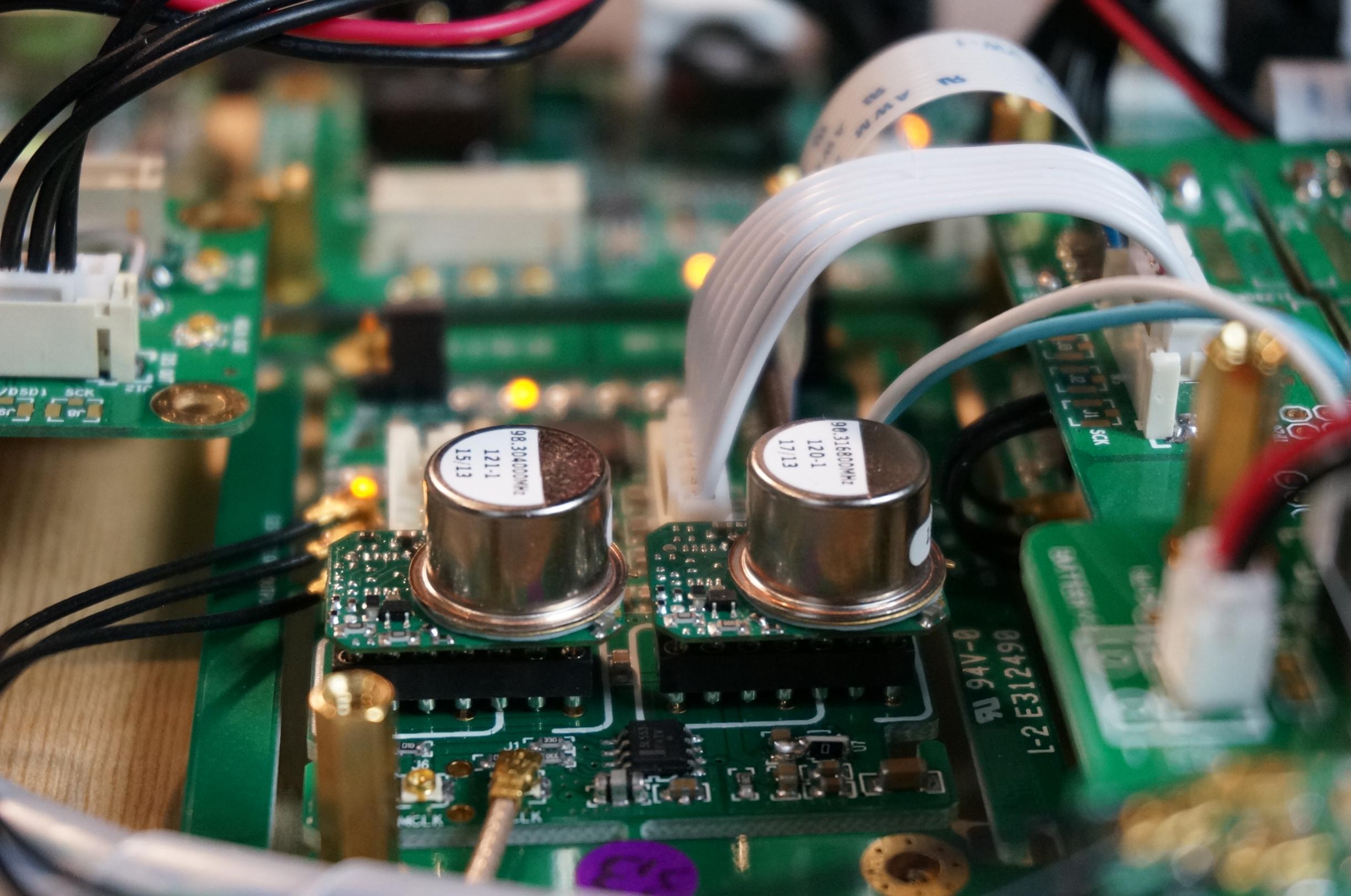

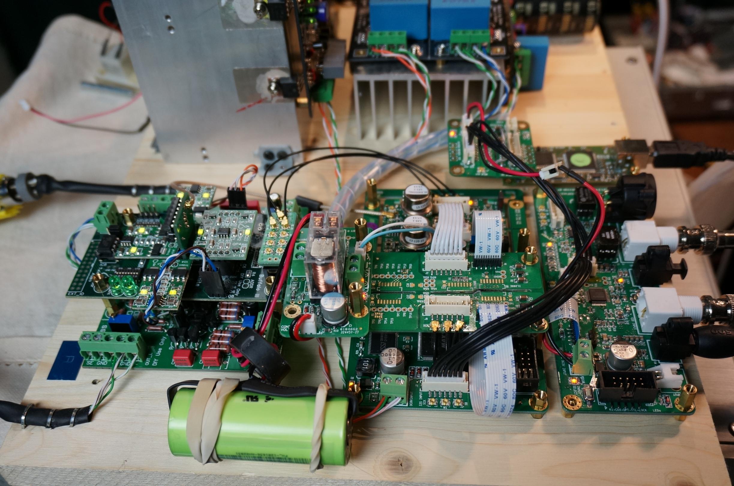

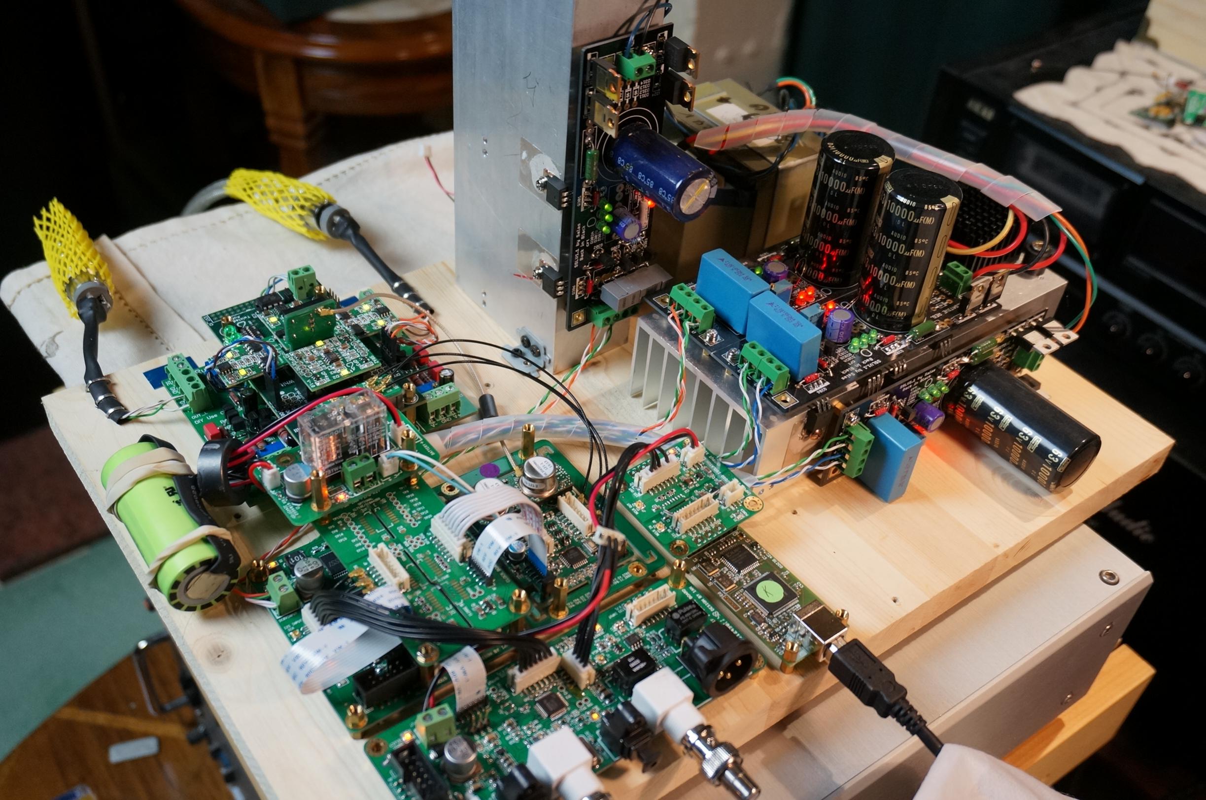

OCXO review: 90.3168MHz/98.3040MHz, -135dBc/Hz@100Hz
I was tied up with GBV and couldn’t do any research job until last week I did some carefully comparison testing on this pair of OCXO with CCHD957 and Si570.
Good news and bad news. The good news is I have to say those OCXOs are really good. The bad news I’ll tell you later on.
The test was done on my system with FIFO KIT, ESS9018, Pass pre amplifier and power amplifier and B&W speakers. Clock board was powered by single cell of A123 LifePO4 battery directly.
The overall impress was that those OCXOs really sound different. Unlike CCHD957 which makes music more musical, and Si570 which has some sweet spot on high range, those OCXO make the music real. This makes me remembering a couple of years ago, when my wife and I had wonderful dinner in hotel restaurant. A violin player was playing at the quiet lobby. I was standing there, closing my eyes, carefully listening to the solo, trying to distinguish what the different with my audio system. My audio system sounds a bit rich, but the real sound comes with solid density and all the details. The music was exactly there that you can touch, no matter you close of open your eyes. Now, with those OCXO, my system plays music more close to the real than before.
With those OCXO, the sound stage was huge and every instrument sounds from its position like a point, you can distinguish both position and distance as a vivid 3D picture even you open your eyes. But when you close your eyes, it seems like the music is something you can touch.
I still need take some time to get familiar with this kind of sound. And now, I start to miss the sound of CCHD957 and Si570 🙂.
It seems that clock jitter not only affecting the sound quality by Fs but also by effecting the D/A (DS DAC) conversion process itself.
The next, I may do some jitter test on my LeCroy. But I fairly believe that it’s already beyond the ability of the jitter measurement noise floor of my oscilloscope.
Please see the pictures for more details on testing setups.

Ian,
that is a great news. Hard to believe it is still possible to improve on the set up you have. I am just wondering what is the bad news?
Regardless, a few questions. I see you have some kind of isolator after Amanero. What kind of isolator is that one, since that is a different one from the one used before the clock? Also I see you use Legato, just like I did until recently.
I have been experimenting with different I/Vs and output devices, and I went back on experimenting with transformers. After few, I settled for now on Lundahl LL1674 but used in reverse as 2:1, in order to provide a proper loading to the DAC. I hope you will try the same or similar, in my case is day / night difference to Legato. Highs completely opened, the depth and soundstage just exploded. There is nothing else, just Lundahl between DAC and my 2A3 tube amp, and when I tried for a first time, I just could not believe the difference. Imagine, I am not new to transformers in the output from DAC, but I was just astonished with the difference. Once you hear it you would never go back. It is not necessary to use the one I used, but high impedance on primary is what is needed.
