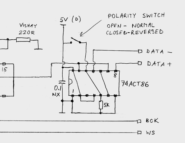

I have a question on how to best integrate the upgraded version of Peter Daniel's balanced-output DAC using 2 TDA1543 chips with the FIFO.
See details of this upgrade in this thread: http://www.diyaudio.com/forums/audio-sector/187748-pushing-limits-tda1543-nos-dac.html
To make a balanced output, one of the two channels of each TDA1543 is fed an inverted version of the data. The stock configuration uses a 74ACT86 (Quad 2-In EX-OR gate). See attached diagram of how this is used to produce the normal and inverted data lines.
I had first thought that the Unversal I2S-PCM board would work here as it as it does produce an inverted data output, but I didn't realize then that the TDA1543 is I2S input only. So the PCM-only output of the converter board would not work.
Then I looked at the FIFO for a similar feature and didn't see one.
Is there a better way to produce this inverted data line, especially in conjunction with the FIFO?
TIA!
Greg in Mississippi

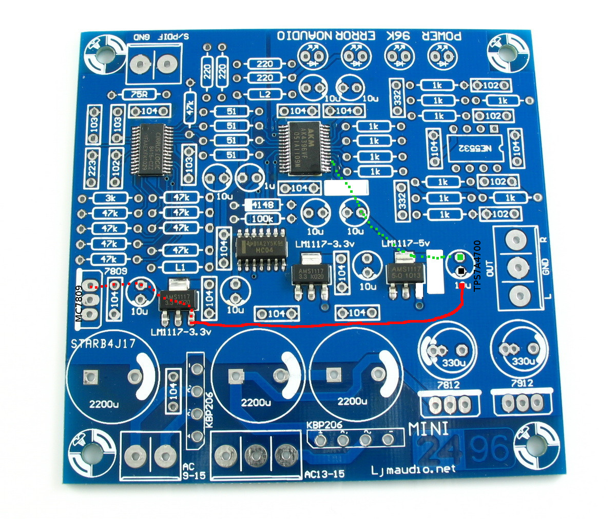

tps7a4700 capacitor recommendation
i'm planning on using one of ian's TPA7A4700 regulators configured for 5v to supply the AVDD (analog) pin of my ak4396 dac.
currently the dac is configured like MC7809->AMS1117-5->AVDD.
MC7809 has 100nF+10uF at its output
AMS1117-5 has 47uF at its output
AVDD has 10uF by the input.
i've attached an image showing what my plans are to fit the TPA7A4700 regulator in place of the AMS1117-5. i will lift the input pin of the AMS1117 to disable it, and remove the 47uF capacitor to provide vout and gnd connections for the TPA7A4700 pcb. vin will come from a jumper wire attached to the output of the MC7809 (using the "accessible" input pad of another regulator; see red trace).
my first question is: any issues with running it with a long vin jumper wire like that?
second: looking at the provided schematic for the TPA7A4700 pcb, there are optional oscon input and 1uF film (i think?) capacitors.
which of these, if any, would benefit this application? and if 1uF is already a good value for the output, what capacitance would be ideal for the input? is oscon still a good choice for this application given that it's for the analog vin of the ak4396, or should i look for something like a nichicon KA/KZ?
here's some ideas so far:
output:
BC Vishay MKT370 1uf/63v
input:
Sanyo OSCON SEPC 470uF/16v
Nichicon Muse KZ 100uF/25v
thanks,
-matt
correction, by default the AMS1117-5 is fed from a (nearby) MC7812, not the pictured MC7809. i would like to jumper the TPS7A4700 vin over to the MC7809 though to take the load off of the MC7812, because the MC7812 is also used for the opamps in the output stage.
