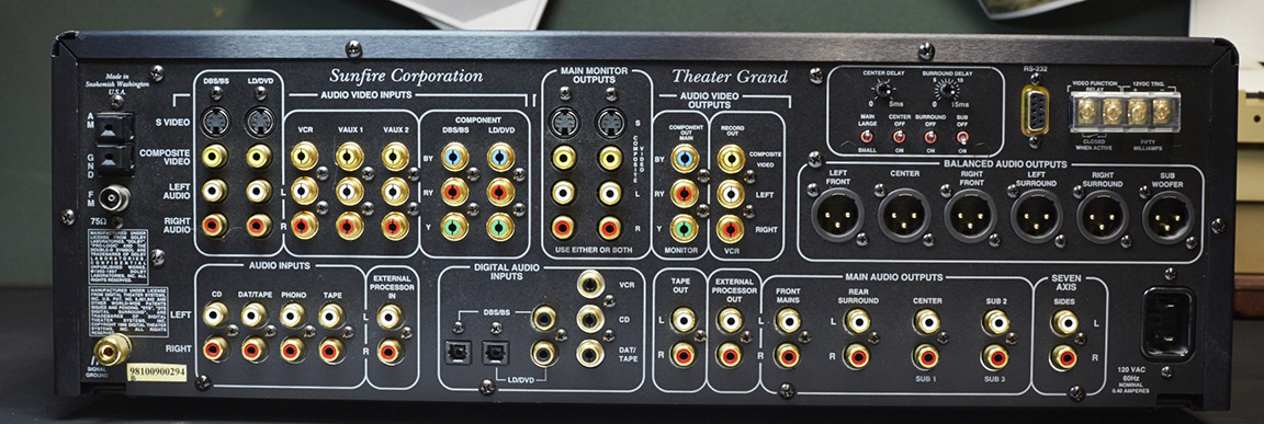

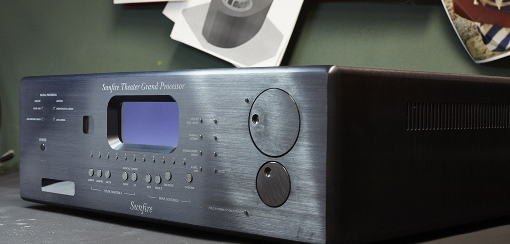

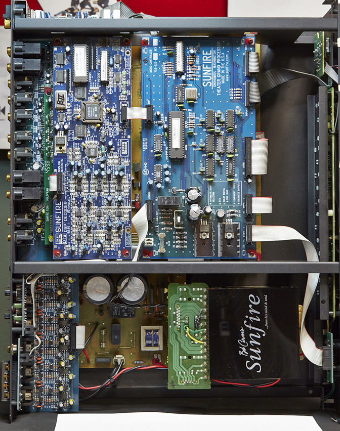

Now, let me make you smile little bit, since you are in the mood to make three out of one... Here is my case for the next project I am talking about. I spent big bucks on it... $79.00, hehehe. It was broken, but there are so manny goodies already inside. The best one is trafo with 18 secondaries... :joker::cubehead:😀

Your sunfire processor looks great, it listed $400 on eBay, how could you get it for only $79 :no:. The case has very good quality as same as Krell, do you really just want to take the transformer? :spin:

You are correct Sunfire typically goes for that price on eBay, but mine was not working completely, it was listed as broken, so they listed it for I believe $ 35. There were just two other people interested and with bidding I ended up at $ 79. I certainly did not buy it for the trafo only. I primarily took it for the case, but since that unit is a processor, than it uses all the same voltages I will need thru out. So trafo is added benefit and it is an octopus with so many different windings at monstrous 260VA for this type of applications. Majority of voltages I could use. Ideal to give all separate winding / feeds to pre-regulators for analog, digital parts off and L and Right DAC boards, clock IVs, FIFO, isolator circuits...
Case has all I wanted: It is as big as big receiver, so it gives a lots of room for all different boards and power supplies. Than front panel is feast on its own. Big window to accommodate any VFD display I will be replacing, than tons of momentary switches, two!!! rotary encoders with attached buttons that I could always replace if these do not work with Arduino. So all that saves me a tons of machining work, and time is what I am short with. Case looks like from the box with no scratches, so I came very good with this. It is already gutted out and is waiting for all my boards to be fitted.
For someone who is good with microprocessors and programming, there is all that there that could be hacked and reprogrammed to control all kinds of switching and integrated in project. Certainly not me, I will be just hacking front panel circuit board and linking switches, display and rotary encoders to Arduino.
