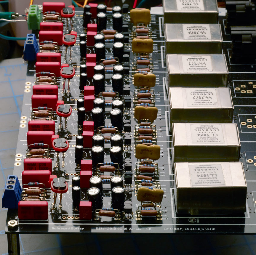

I believe I reached the final decision on my I/V stage (somehow I know I might regret this statement, ha) It will be actually my old output I used and built for my modified Behringer. After several experiments and listening I concluded the optimum to be: DAC -> balanced jFet buffer -> Lundahl LL1674 connected as 1:2. That sounds so good, it is hard to explain. With this, buffer is sonically invisible - no caps in the way of signal, and Lundahl connected that gives minimal gain, but just right amount to feed any of my amps. In the picture attached you could see how that looks like, although this was 6 channel setup I made for Behringer, that is now cut in 2 channels each. I never heard this DAC to sound as good. Instead of explaining how it sounds, you really need to hear it.
I have offer for you. In the middle of December I will go to Europe, and I will be out for about month. If you want I could send you my test set up with two channels of buffer and two Lundahls. Just, enjoy it and send it back before I return. That way you will hear for yourself... Not that I try to derail you while in the race...

No, I never started a thread. It was designed by ZenMod for my need based on Nelson Pass B1, but this was balanced version without caps. Cviller made circuit board design, and I did manufacturing in China. I will need to make new boards and will make some modifications to make it more useful, such as option with or without transformer, maybe more options for various Lundahl transformers and such. I will see. When I am ready I will make post for group buy, because many people asked me about it. I definitely will need to make more of it for my use.

Hochopeper, thanks for the info. Also, I do have a new I/V that seems to be the ticket, I just have to finish it. It is design by ZenMod and few other extraordinary guys for Serbian DIYAudio for a local ESS project. By concept and features it seems to be something special. I am still working on it, and when I am done I will report. Cannot talk much about it now. 😀
