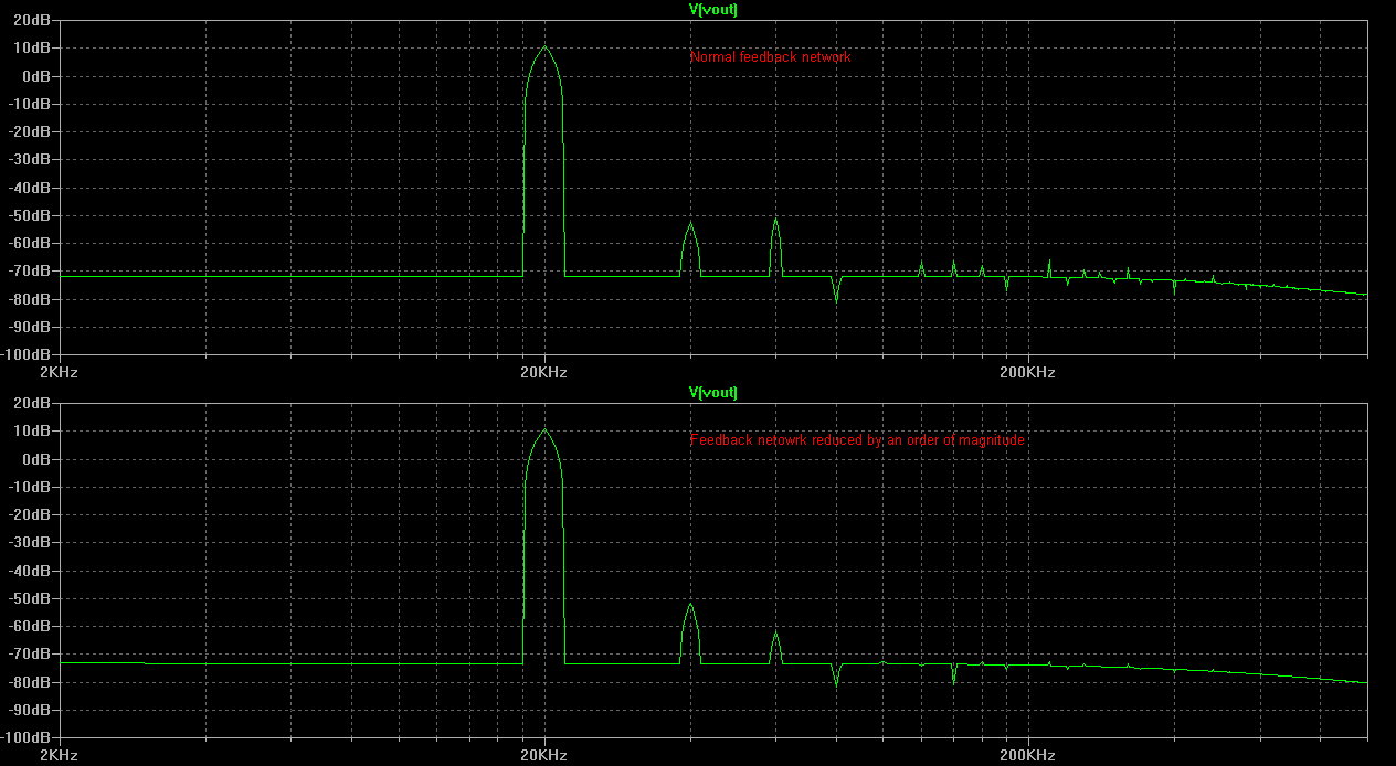

Is there anything wrong with increasing the PL cap Hugh mentions to say, 56pF? I haven't seen any problems in my simulations.
EDIT: Hugh, I only meant the feedback network, not the input network. Just decrease the resistors on the feedback side of the LTP. And IIRC, there was a decrease in higher order distortions. I will try to dig up the thread.
- keantoken
In the simulator, this mod has had different affects on different amplifiers, presumably because the base current of the LTP transistors is the parasitic factor we are compensating for. I'm simming with the HAKSA to see what affect it has.

Okay, I have attached the simulation results. This worries me because I didn't expect it to be so significant! Whenever I get too successful on the simulator I ask others to verify my results, which is why I've also attached my simulation file with models included. The mod probably works well here because of the low OLG of the amp, which makes the base current of the LTP transistors larger (not to mention the non-CCS LTP loading).
This simulation was taken at 2V input, 20KHz. Something needing mentioning is that the feedback cap also has to be increased by a factor of 10.
- keantoken

The impedances of the fb and input networks should match, so that there are identical voltage drops across fb and input bias resistors. This guarantees identical offset to ground, that is, 0mV.
Your simulation reveals low H3, H5, H7, etc artefacts. This is very useful, and I like it. I strive to reduce these, and ideally, to have monotonically decreasing artefacts if at all possible, generally only seen with SE circuits.
Hugh

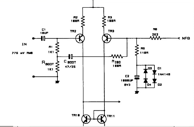

Douglas Self uses low value resistances in both FB and input for the reason Hugh stated, then bootstraps the input to the feedback point to increase input impedance.
SandyK
ref. Audio Power Amplifiers-D.Self vol.3 P.86
Hello
You mean this one, have you try it in a amp ?
Can be interesting to try it in the Haksa amp.
