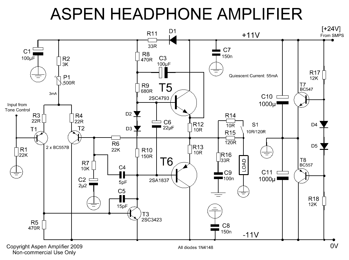

As promised, here is the schematic.
- keantoken
The references are different..... but you clearly have worked out why it's been done. So in truth, a little thought, seeing the obvious intent of it all, and you've reached an epiphany......

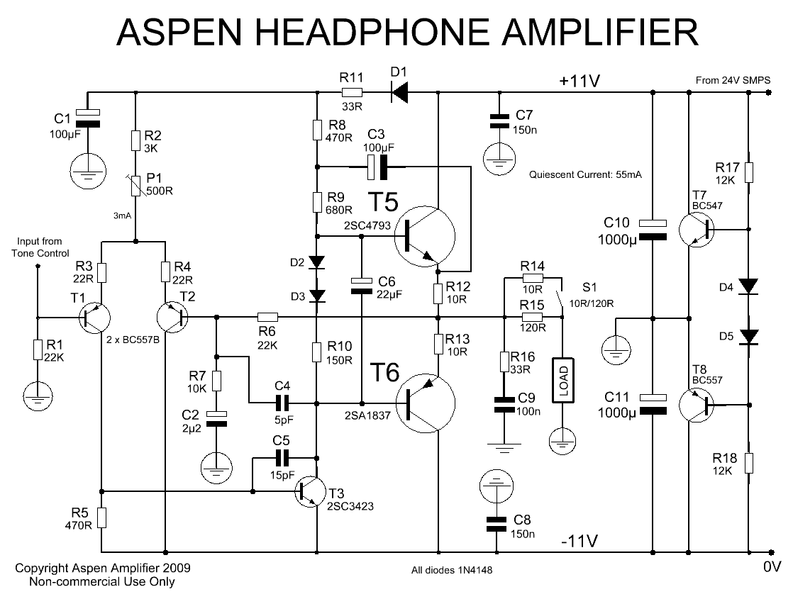

Try this schematic!
Hugh
Hello Hugh
I have at the Haksa schematic you sent me by email, except the need of a 10 ohm ground lifting resistor, all are ok for me.
I need to use parts from my parts bins, so I will use, for the VAS a KSC3503, and for the output MJE15034 and MJE15035.
I have lot of used small and big standard transformers types wall-warts, so I will not need to find a SMPS wall-wart.
