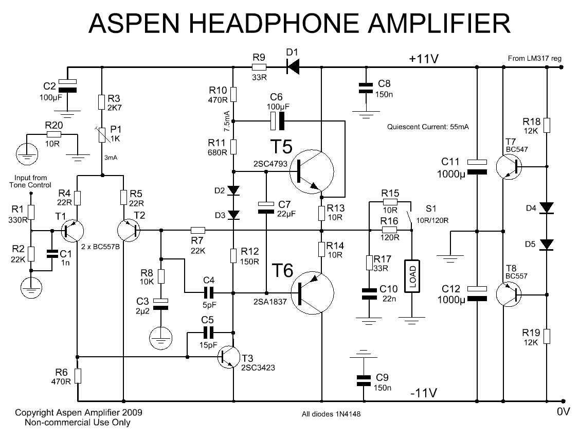

Hi Geatan,
just check wether the miller cap value works for that transistor, you may have to adjust it to get optimum rsults.
Hello Nico
From past use of the KSC3503, I know that I may need to raise a bit the value of the miller cap and phase lead cap.
The 2SC3423 have a Cob of 1.8 pF , the KSC3503 have a Cob of 2.6 pF
I will check with a 10k hz square wave on a scope.
Btw, I will do my pcb, so it may be usefull to see an image of the pcb routes.
Thank
Bye
Gaetan
compensation/stability tweaks?
series RC in parallel with R1?
I've found a input high frequency termination "Zobel" can be useful, adding phase margin, reducing source/vol pot setting dependency
looking at the feedback loop signal path the input Q1 likes a low Z HF AC gnd at its base
also can fliter some RF from the input
I know Hugh has some ideas on feedback and amplifier voicing but I hate to see all of the compensation bypassing the output stage - "TMC" or 2-pole compensation both would allow loop gain to be maintained to a higher frequency around the output stage
earlier output Zobel design was questioned - the main load difficulty is cable capacitance
due to the desire for small flexible cable headphones can have higher cable C - the amp should be stable into a few hundred pF to at least a few nF
while sim will not be definitive due to modeling limitations a look at output behavior with a step current appied to the output or a V step in series with the modeled cable Cload can show some useful features - AC analysis is less useful than .tran based sims

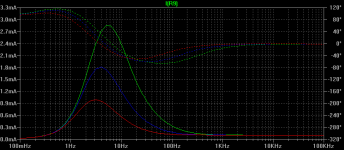

Another nitpick, I scrutinize the value of C3. The graph shows the AC current through R9 (bootstrap source) in mA, for values of 100uF, 220uF, and 470uF (I believe the AC analysis assumes an input voltage of 1V). Normally it is very low, but has risen considerably at 20Hz (lower is better, the bootstrap is supposed to be a CCS). What I don't know is what effect this has on the actual sound.
This should probably wait until someone prototypes it, I just want to point this out. I've been uneasy about the descending value of C3 over time.
- keantoken

JCX,
I'm having some difficulty with 'I hate to see all of the compensation bypassing the output stage'! What do you precisely mean by this?
A Zobel on the input is a good idea, what values do you have in mind? I have amended the zobel cap from 100nF to 22nF; this was a misprint; I'd never intended such a large cap in the first place.
Nevertheless, I think we are reaching the point where this is becoming a simfest; we need to build the damn thing and inspect the performance subjectively and objectively with waveforms.
The intention has always been to build something simple, effective, inexpensive, and relatively high performance. But it is not the ultimate; that would be, I feel, an SE design.
Thanks for your valued input.
Kean,
The value of C3 is not particularly critical. You can get away with about 22uF if you throw away a little bass response. On my AKSA, I've tried as little as 47uF and as much as 470uF and the differences are far less than you'd expect. Certainly very hard to pick subjectively.

Nico,
It is very clear to me that any series R added to the load will dampen any tendency to oscillate, and pull back phase shift. There is probably not much requirement to design for highly reactive loads in this design, given the structure of cans and the fact that the electrostatic ones need veritably power amps to drive them anyway. Thanks for mentioning it, however.
Hugh

C4 is supposed to be the phase-lead cap, whatever that means. My observation is that it turns gain down to 1 at high frequencies, aiding stability. I personally would give it a value that rolls off response at not far after 20KHz, why not? But most people don't.
EDIT: To clarify, if C4 is not present, usually there is some sort of gain peaking at 100KHz or above, presumably because the capacitance of the LTP transistors affects the feedback network's ratio at HF.

Hello
Since the lag compensation or Miller cap and the VAS are the most important step for the signal voltage amplification for the drivers, if the value of the cap are too big, that VAS local nfb are cuting lower than the pole frequency and cut down into high frequencies who are important for good listening. And if the cap his too small it cut higher than the pole frequency and the amp oscillate.
So we use a phase-lead cap as an other local nfb, because with this cap you can keep miller cap at much lower value without the amp oscillating and the sound sound becoming tizzy, bright and fatigueing.
Bye
Gaetan
Does anyone know what C4 does? How was it's value determined?
The $64K question, goes to the heart of the design.
Phase lead, recommended by J Linsley Hood, used on many of his amps.
Improves tolerance of capacitive loads, enables lag comp to be reduced which improves SQ. Very useful on a power amp designed for electrostatic speakers.
How arrived at? Sims, then empirically, in listening tests and square wave analysis.
Difficult to arrive at these values using math analysis as they are tiny capacitors, so layout plays a big part. One of my amps used a single sided board, needed 5pF of PL. When I went double sided, there was more stray capacitance, and I needed to amend it to 3pF. Made a big difference to the sonics, too. Sim assumes there are no parasitics. Play with LTSpice, you will see what happens on a loop gain plot.
Hugh
