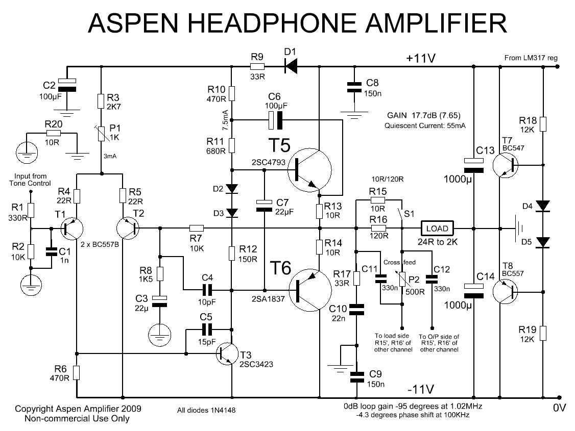

A few minor mods to the HAKSA to incorporate Crossfeed, reduced Zin and more data.
This completes the amplifier, the crossfeed, and the virtual earth. A non-inverting, opamp buffered very low phase shift tone control to follow.
Hugh

Hi Hugh,
didn't know you got your own channel here, haven't been around here for a very long time but congrats to your own corner!
Nice little headphone amp there and nice choice of transistors too!
I was going to ask you why you choose the 2N5401 shown in the simulation schematics in the beginning of the thread but now I see you opted for the BC557, what's your reason for the change?
Cheers Michael

5401s are rated to 150V, reasonably fast. This application is low voltage, so 557Bs would be better as they are faster, lower Cob, and much higher beta. The VAS is the best I've yet used, 1.8pF, 150V, 200MHz, 50mA, and inexpensive. The outputs are much faster than the usual choice, MJE15030/31, and while not so high current, their linearity is as good and they are cheaper. For this application, very good choice.
On top of that, all these are commonly available except the 3423, and I have plenty of stock of all of them (though not for resale!).

Michael's comment reminded me I had not simulated the Loop gain for BC557B, so I did it again today and came up with slightly different lag compensation and phase lead values. This has resulted in a full two degree reduction in phase shift at 100KHz, which is no bad thing. Apologies, it's set in concrete now!
Hugh

Hugh, I realized I should ask you this. Until now I haven't thought to understand how exactly you made your choice of devices.
How much do you believe the actual performance curves of an individual transistor (Ic vs Hfe/Vbe, etc.) affect it's sound as opposed to passive factors such as Cob, Ft and AC characteristics?
I'm sort of asking you how important DC performance is as opposed to AC performance.
PS, the amp is awesome I think, painfully nitpicked and scrutinized, it has had a rough childhood but will surely be strong for it. A masterpiece I believe.
- keantoken
