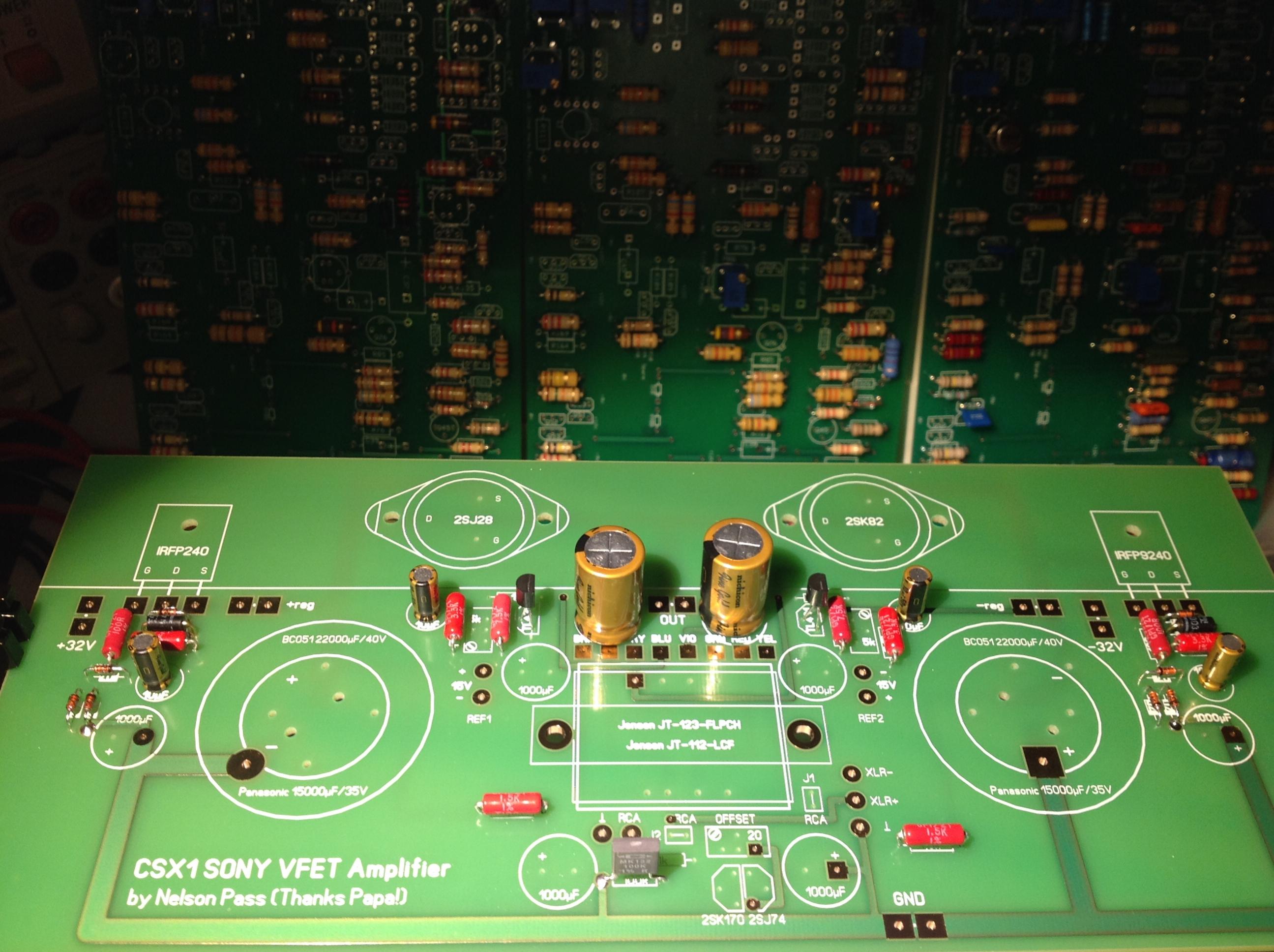

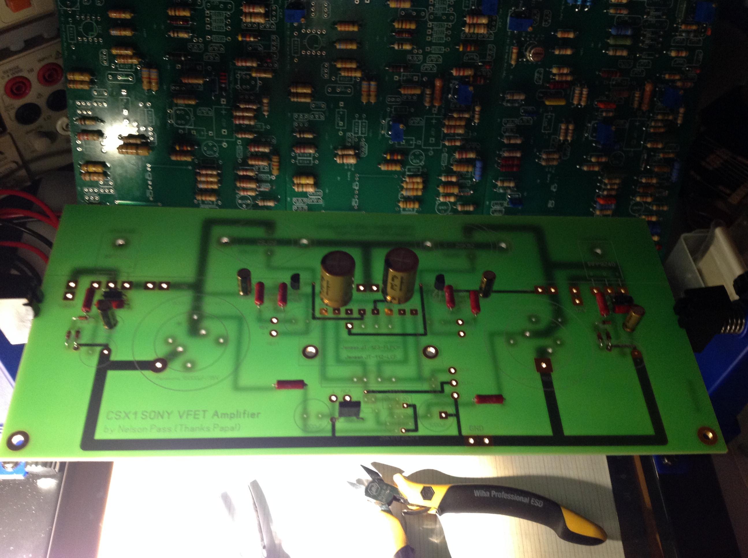

this evening Sony CSX1 on bench table , work in progress...
and lot's of joy :cheerful:

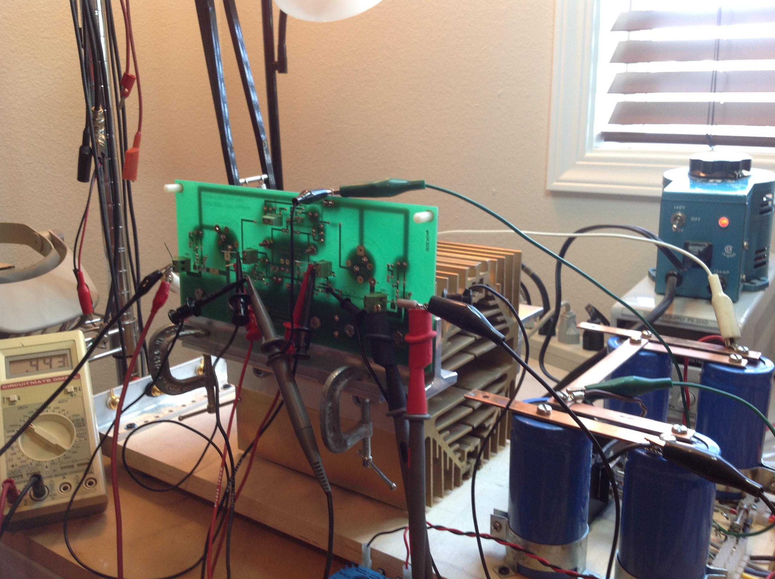

First channel tested and biased. It's a beast for heat dissipation. It's very stable for bias adjusting. At 1.3 amp bias my test jig was getting hot. I just had the t-bar secured with C- clamps.
I previously set the bias voltage references at 12 volts without the main power supply. With the main supply connected I then brought the variac up slowly watching the current draw from each polarity of the supply and the voltage on the reference bias supplies. Once the supply was up to voltage I started alternating the bias supplies while watching the output offset and voltage across the .47 ohm sense resistors. Very little drift in the output offset, once set, it stayed in place even as things warmed up.
On to the next channel.
