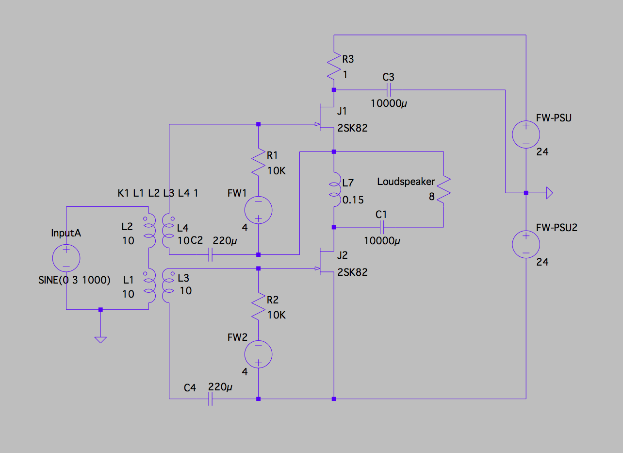

VFET Accordion Amp

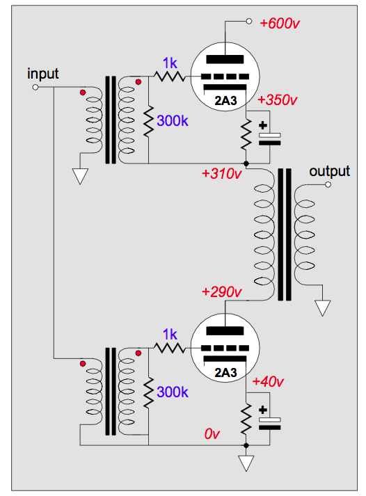

I was reading TubeCad last night, and I thought Accordion Amp topology would be suitable for VFET single ended amp. LTSpice simulation suggests 2x Mu, 2X wattage than regular Sony 2SK82 SE amp, and typical SE THD figure.
I don't know if this amp works good in real world, so I ll appreciate it if someone would give me an advice. The Choke in the schematics is 0.15H 1 ohm, and R3 is for voltage compensation. Maybe a bad idea...
The Tube CAD Journal: The Accordion Amplifier: A new single-ended topology
