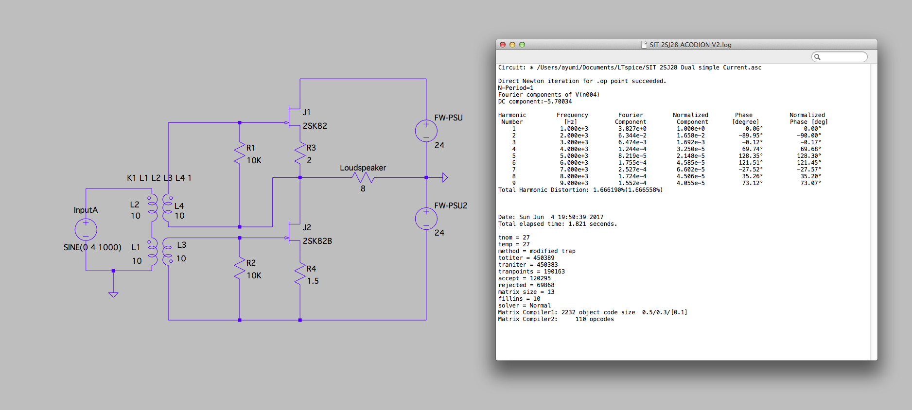

The output of J1 and J2 is opposite phase. Tube Cad calls this circuit single ended, so I just followed their definition... Sorry for the confusion!
he needs choke/xformer for transforming impedance ; what is drawn , when transfered in sand realm , is nothing else than F6 ; character of amp ( 2nd dominant , 3rd dominant) is easy to set with different values for source resistors or even with Zen Amount Pot ; search in F6 thread

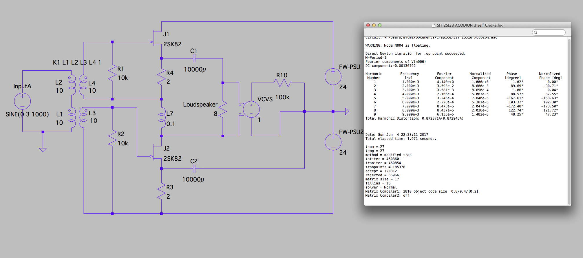

Now I tried that on LTSpice (If I understand your words correctly...) , but it seems like the virtual sands are way too accurate to replicate the real thing even with the 2SK82s with intentionally different curves.
Looks like I should prototype the real thing.:)

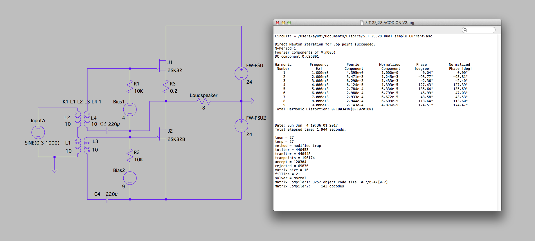

stay with gate biasing , and keep source resistors at minimum , increasing only what you need to get preferred THD spectra
if you bias them with source resistors you're wasting gain and getting awful DC offset at output ........ meaning - it's not practical chasing both THD spectra and 0 offset in same time with same parts
Thank you for your advice again.
Sure, I understand the offset part.
1 or 2 ohm would be a reasonable value to start experiments?
hmm, I'm going back and forth. After seeing the ultra simple self biased version, it's hard to go back to the fixed bias one! :eek:
The problem is the gain loss that ZM pointed out, so I brought back the choke again. My novice brain could not find any other way to realize a self biased version with high gain...
I can do this now with my parts in my drawer, so I probably should try this first. If you guys find any issue, or have better idea, please let me know. :)

After a bit more careful examination, I concluded that this accordion topology would not a good idea for 2SK82, because the output impedance is too high (15 ohm-isn). It would be OK for 16 ohm speakers, but those speakers would not need high power anyway. The best results on simulations were CSX and ZM suggested F6 kind with 0.1 -0.2 ohm source resistors.
For those adding a buffer before the transformer, what load is reasonable to test the buffer distortion with? I have tested 1000 and 500 load and I am happy with how the buffer is performing. I could connect it to my transformer to further test and terminate the transformer with two resistors (what value?) to provide an even more realistic test scenario?
