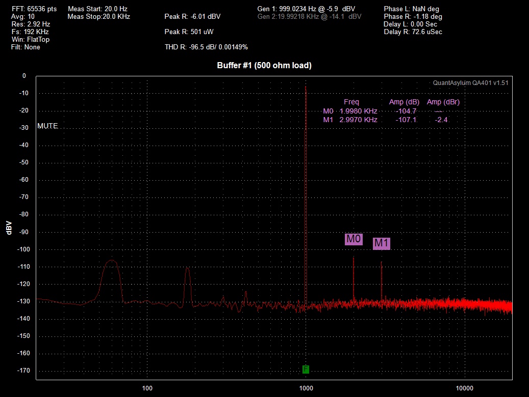

Article - Sony VFETs part 1
If you
can drive 500 ohms without significant distortion, you are doing fine.
Excellent, here are my results at 500 ohms

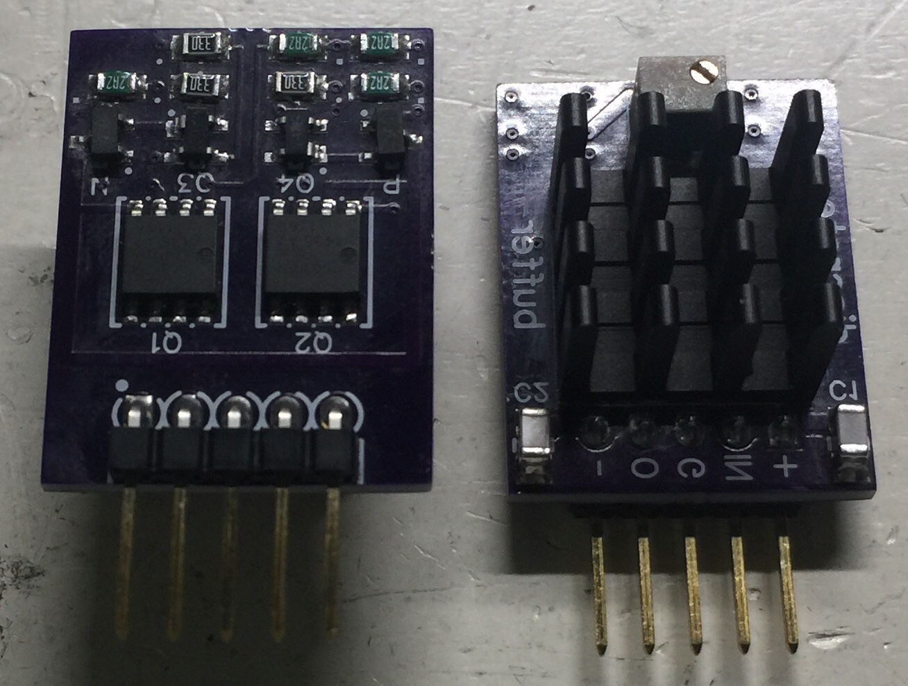

They are cute little guys

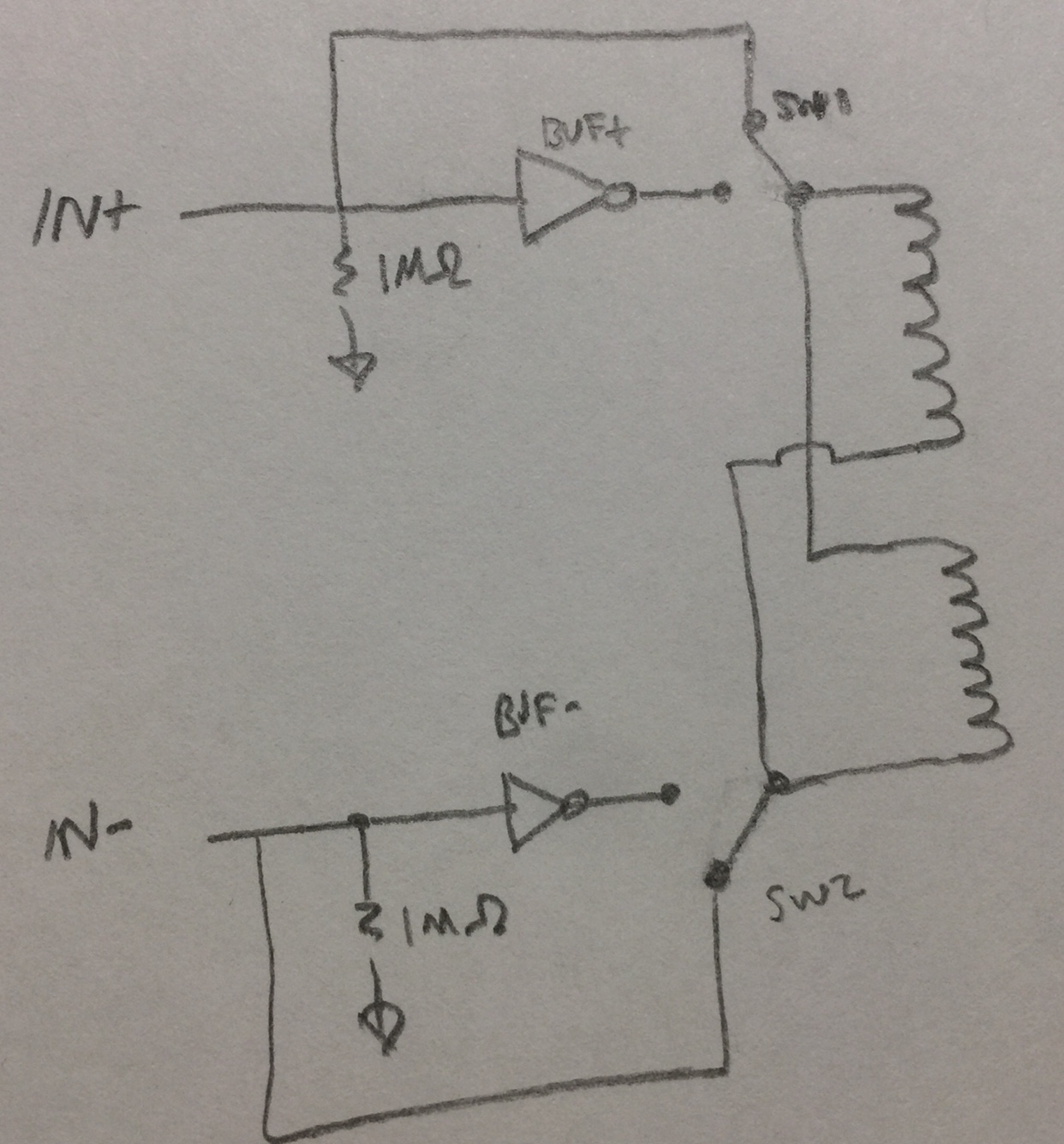

In thinking about it, I have a few questions. Here is the schematic that elicited the smoke, I was using a balanced to SE XLR Adapter
1.) I am switching the buffer in and out of the circuit via a relay. I am just moving the input of the buffer, the output stays connected. Will this work? Is it better to switch the output, or must I switch both the input and out of the buffer?
2.) My buffer saw as load the primaries in parallel, which is pretty low and caused a resistor to smoke. This is much lower than the 500R above. This is because the negative input was connected to ground via the adapter. I am doing something wrong here, obviously. How can I fix it?

Yes, you are doing something wrong.
The first step on the path to enlightenment.
I don't think you want the output of the buffer and the input signal
connected to the transformer at the same time. Also, always see to it
that the buffer input has something to look at, even if it's only a large
value resistor to ground.
The smoke was the first indication of that 🙂
Ok, so switch the output of the buffer. Makes sense!
It seems that I should also switch the input. Take this example:
I seem to loose the benefit of a balanced input, as I have the input resistor to ground? So, I guess if I wanted to have the buffer flexibility, I need switch it completely in/out, meaning both input and output?
In the case of the first diagram, where the switch toggles the buffer to be in-line, doesn’t the buffer still see 25R in parallel with 25R as load?
You want the buffer to always have some DC connection to ground,
even if it's 1 Meg (or more likely 100K). Otherwise it might be led astray...

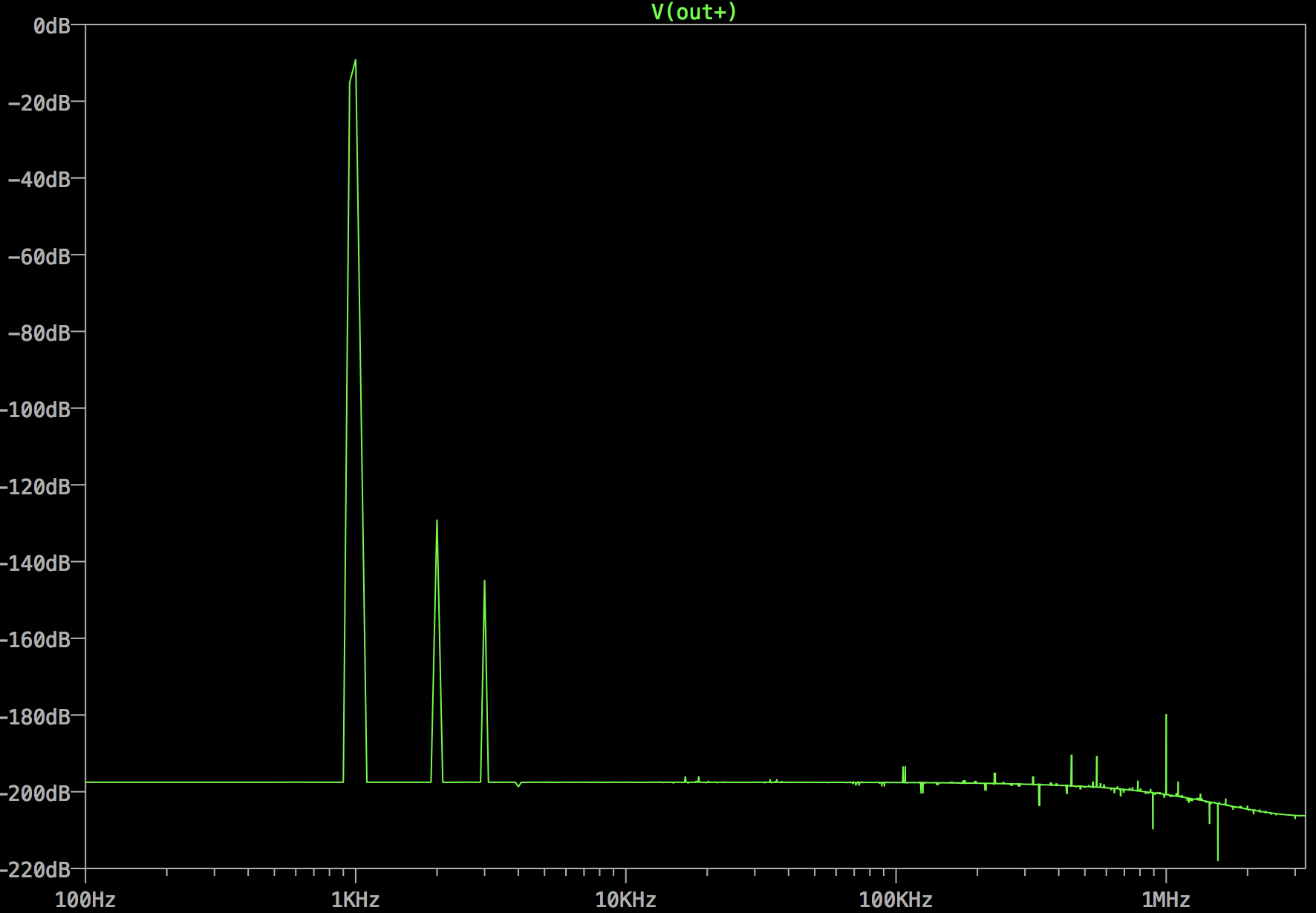

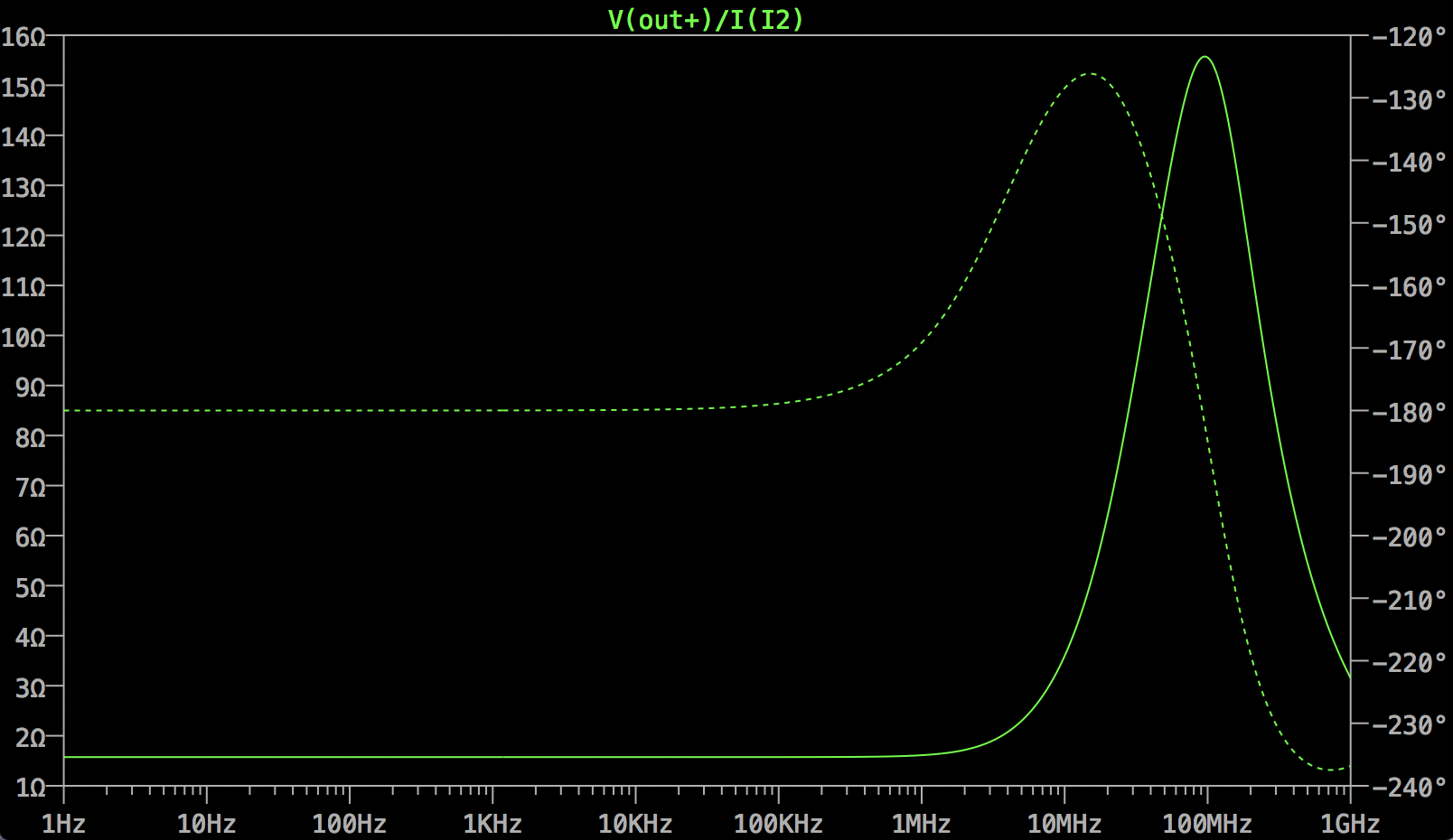

ok, so I've measured the output impedance to be quite low, in fact it matches my simulation.
attachment.php
In terms of the simulation, the FFT looks similar in relative magnitude, but the values are lower in the (perfect) sim. Compare to the measured FFT above.
attachment.php
In terms of the resistor to ground, I'm using a diamond buffer topology and my input devices are half of a PHPT610030NPK. Here's the datasheet:
http://www.mouser.com/ds/2/302/PHPT610030NPK-534221.pdf
I've tried 100K to ground and 1M to ground. I don't see much of any difference with the distortion on the output. What should I be looking for when choosing this resistor?
