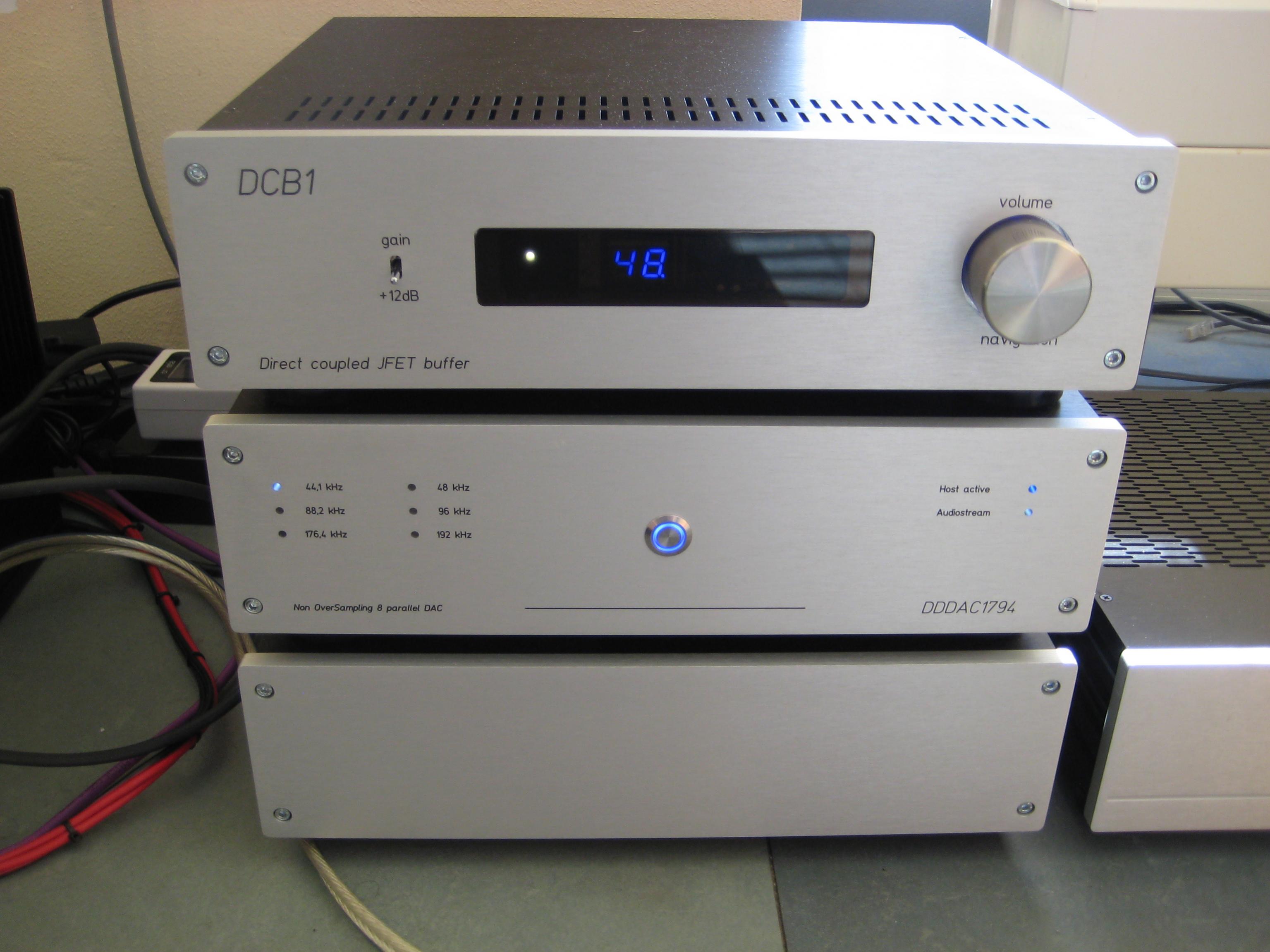

Do you have any problem driving the F6 with its 14db gain with a DCB1?

Indeed the 14 dB is often a problem with DCB1, but I have a 10-12 dB Juma gain stage which I can switch in with just one switch. See pictures.

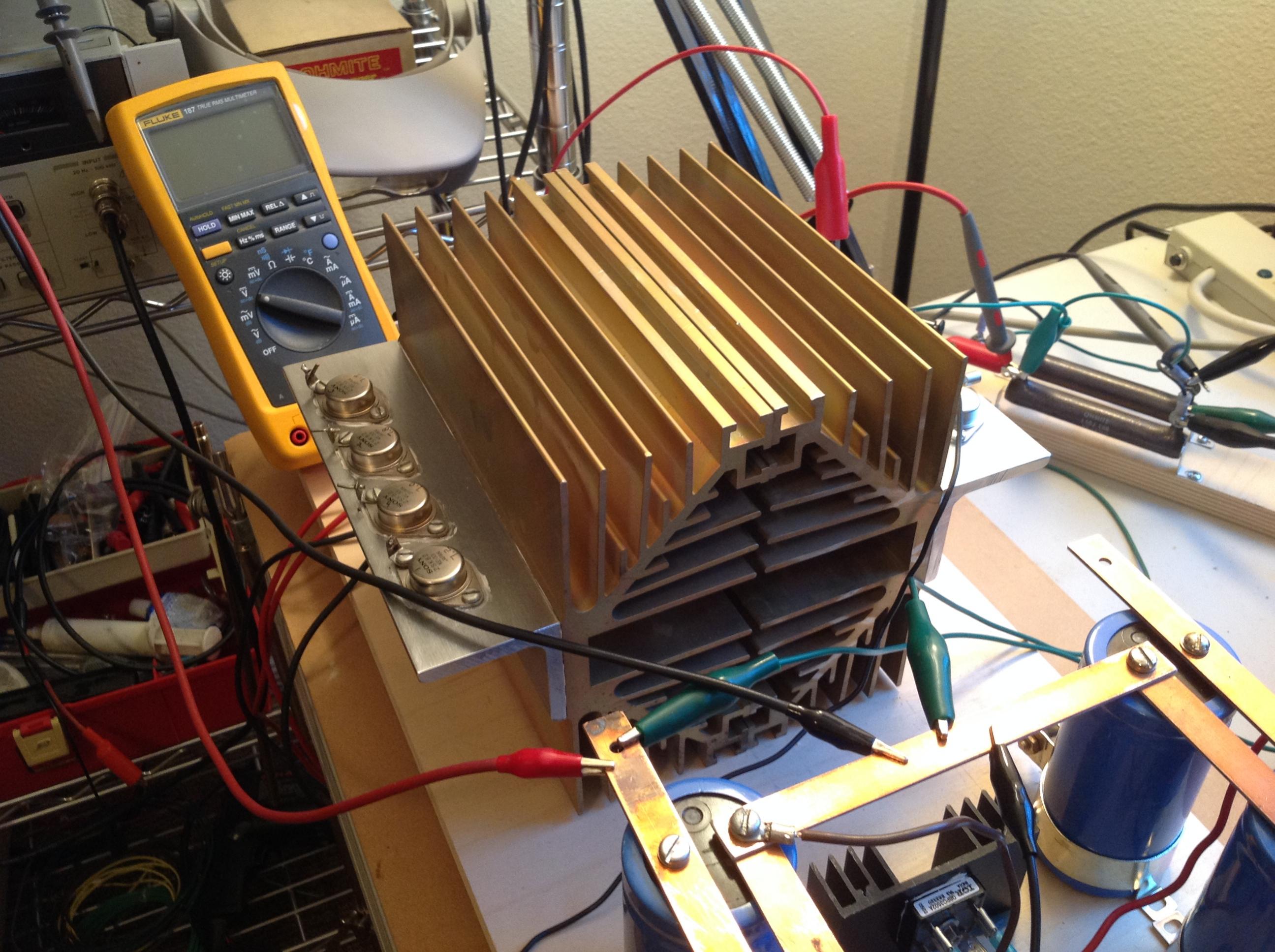

I finally got around to testing my VFETs. Four each of the 2SK82 and 2SJ28, not many. I tested at 1.5 amps, 25Vds
2SK82
#1 7.2 Vgs
#2 7.8 Vgs
#3 7.4 Vgs
#4 7.0 Vgs
Not bad, happy with that spread
2SJ82
#1 11.4 Vgs
#2 11.1 Vgs
#3 8.9 Vgs
#4 8.5 Vgs
Two groups that will work.
The 11 Vgs ones will be problematic in the CSX boards with out changing some values on the regulators. By the time I got the voltages to 11 volts the regulator wasnt working with the 15 volt supply. The 431 needs a mA to work and the voltage divider will take another mA, that is 2mA going through the 3.3K ohm supply resister, resulting in a 6+ volt drop. 15v-6v leaves only 11 volts left over for the regulator. In testing the ref. on the regualtor was decreasing at that point, thus no regulation. If I were to use the 11 Vgs VFETs I think a 1K ohm supply resistor and a 10K ohm instead of 7.5K ohm in the voltage divider would work. The other fix would be to start with a higher supply voltage, but in my case I already have the stock 12VAC transformers.
If your Vgs values are in between I would check and make sure your regulator is working by measureing the 2.5 volt reference. You want a regulator and not just a voltage divider.

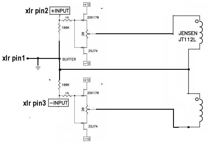

I have a CSX2 question that I hope is simple. Is it possible to drive the input transformer with two buffers, once for each input phase? The wiper of two pots would be connected to the In+ and In- of the original schematic. A second small bipolar supply would be used to insolate the transformer as intended.

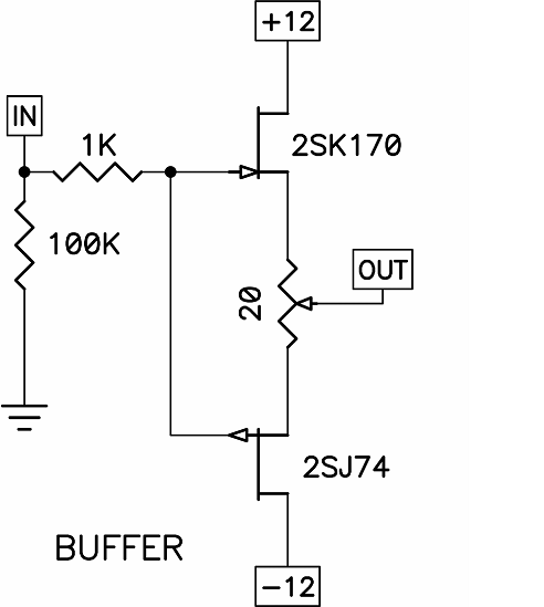

I think you mean this buffer, twice?
Thanks! The article states:
"You also have the option of running the input windings of the transformer in series, sacrificing 6 dB of gain, but doubling the input impedance and halving the capacitance."
So, if the connection from pin 1 to the center of the two windings is omitted, would the above also be true?
