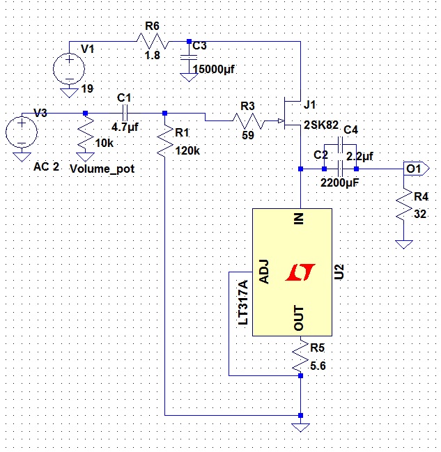

You can trace the wires in the underside photo for the "schematic".
Hey, it's fun, it works, and sounds OK to me. 😉
Hey Drjbf1
Me too i have few of KD-33 grade 2SK82's and i am in to quick build
with point to point technique , but could you share more informations
about caps values ,components potentiometer and PSU ?
Its simple circuit but i work much with schematic or little better zoom detailed photo's please.
Maybe new thread dedicatet to your work ?
Thanks its very interesting diyer friendly and fun project for Sony Vfet's.
Have a nice day :hphones:
My work certainly does NOT deserve any dedication! :whazzat: 🙂 I just cobbled this together without any optimization or allowance for headphones different from mine which max out at 30 mW. I thought setting the gate bias differently was not worth the effort and extra parts given the small improvement in performance. PSU is SMPS brick.
