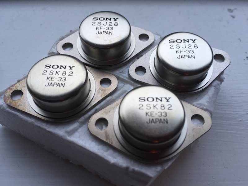

I had a feeling this part II would involve jfets and SITs. Go figure.. 😛
Anyways, got my set of Sony's 😀
Me to! SONY

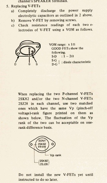

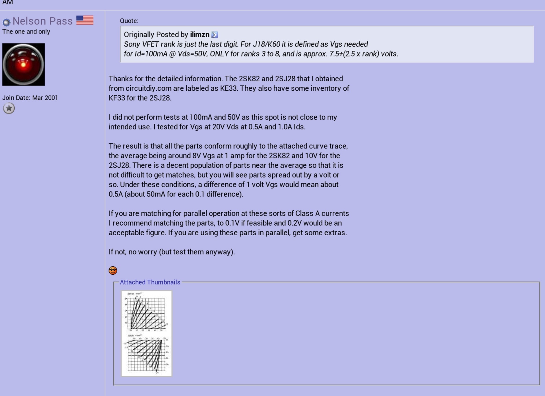

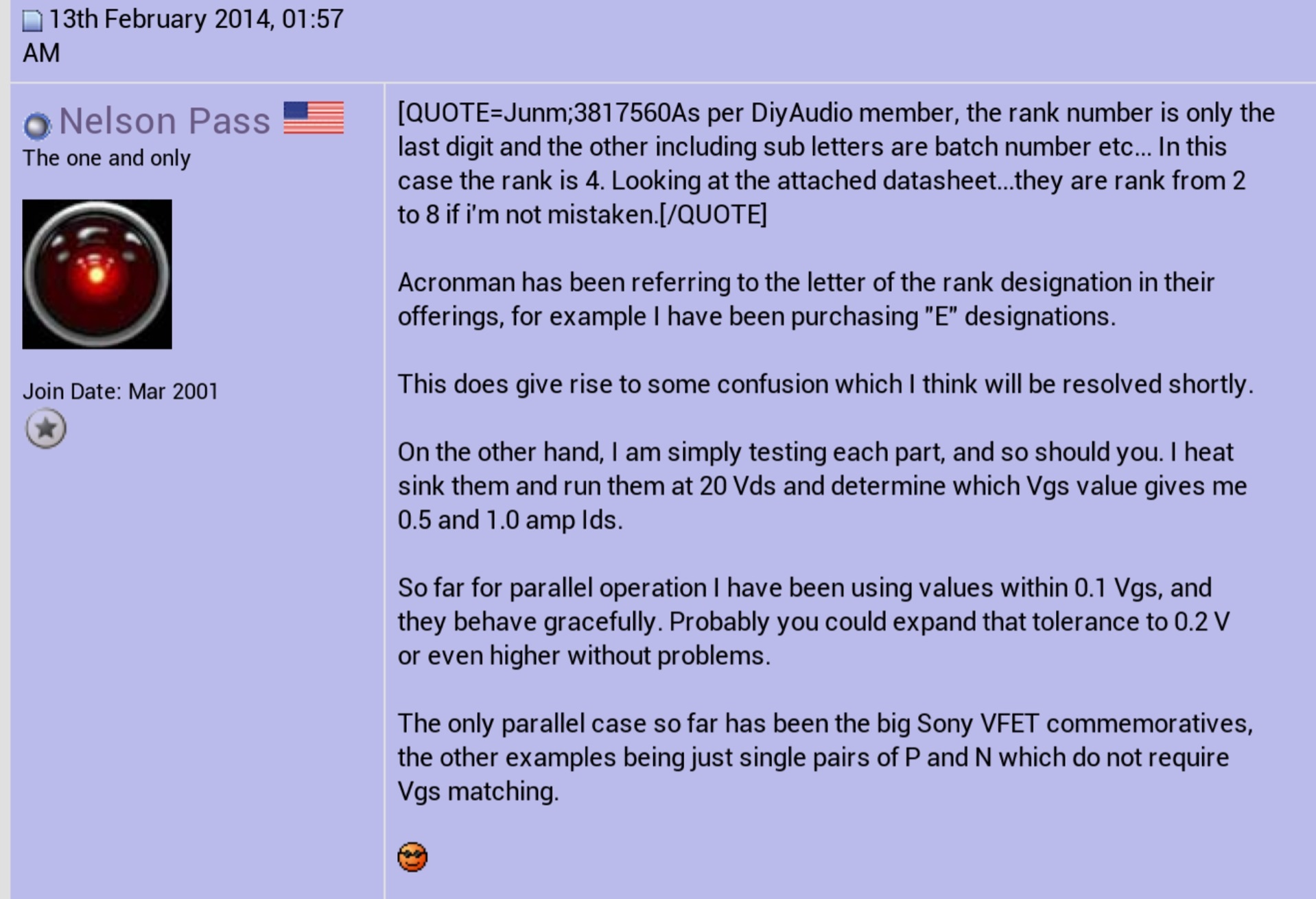

@ Tea Bag & Diyers
What your current ?
I don't think this small tester are perfect made for vfet´s Vgs procedure.
http://www.diyaudio.com/forums/pass-labs/253411-article-sony-vfets-part-1-a-110.html#post4321408
Ok for basic test´s : source drain resistance and diode characteristic
from Sony service manual , look at attached thumbnails.
I near future i try great " Frankentracer" and i am on way to complete
Locky_z usb tracer i need some windows pc to work this tool,
in everyday life i always work on apple computer.
Anyway i do with dear Papa councils and
that mean aluminum profiles must be drilled 🙂
Kind regards

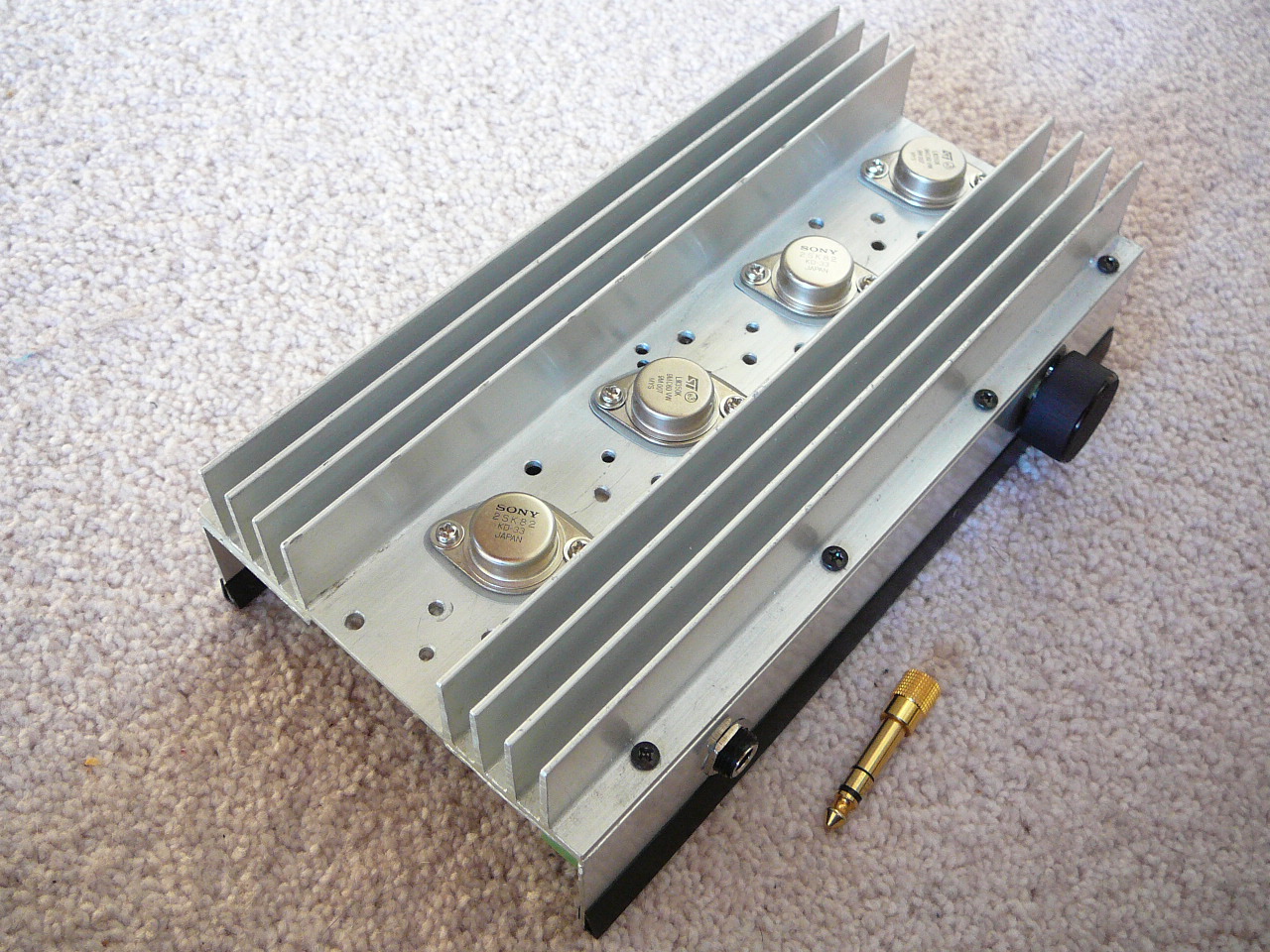

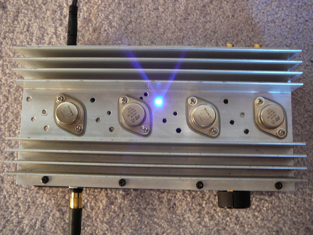

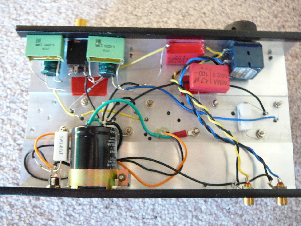

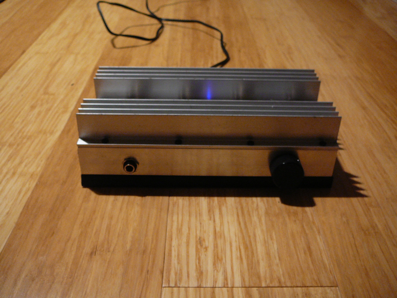

In the meantime ... Quickie 2SK82 Head Amp
If I build Part 2, I will have some 2SK82s extra, in addition to service replacements, and they are eating a hole in my parts drawer.
So while waiting for Part 2, I decided to try something a bit different, a quick and very simple single-ended follower headphone amp. Mostly re-used bits I had lying around, with an industrial look to complement those TO-3 metal cans.
With grounded gate, Vgs is about 6v and Vds 12v, bias at about 200ma set by LM350 (had to be a TO-3 device) current sink for around 0.019% distortion (mainly 2nd harmonic) at a loud listening level on my 32 Ohm headphones. You can trace the wires in the underside photo for the "schematic".
Hey, it's fun, it works, and sounds OK to me. 😉
