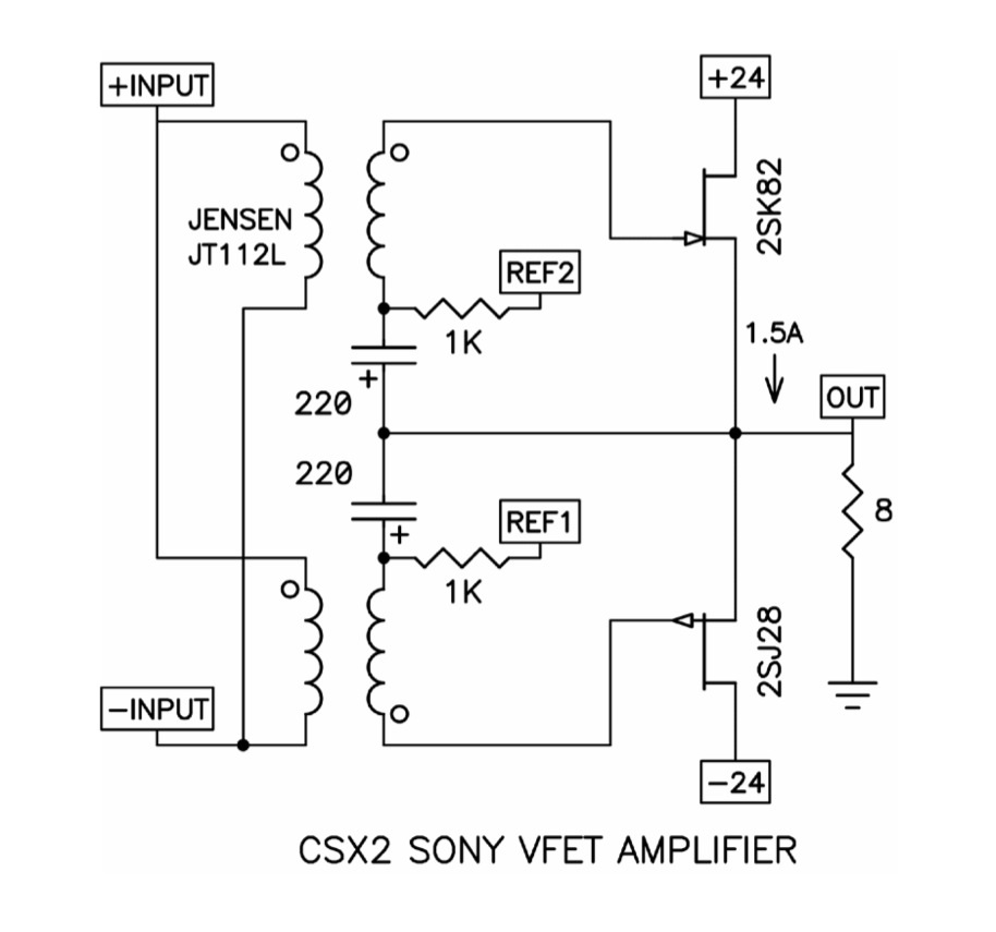

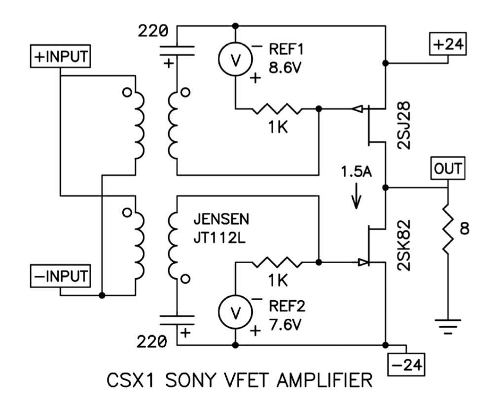

everything has a sound , sure big thick film power resistor sounds different than inductive wirewound but load choke and active load are too...
speaker protection is the condom of listening you can go without 😀
( with the SITAMP you have the output coupling cap..)
Big cap take a time to break-in but don't expect miracle , better tweak operating point or loading type..🙂
Something interesting, or I learning about, protection system are invisibles for the sound?
Hola Christian friend, It you have a output cap you have not DC, Maybe an overcharge system but do not need a system for protect your speakers.
CSX are DC coupled and for that reason nothing between.
I hearing for there that Juanito has monster loudspeakers, is it true?
Juanito, Dude, One more question, Do still use SE with the sj28 like ccs? What you did with the secondary connection to the gate in this Vfet?

hi , i don't have special speaker just small avant-garde horn , but i like them enough to put a speaker protection 😀
yes i continue using the CSX1 in single mode with the 2SJ28 on top of the 2SK82 . i just rewire the jensen to get the full signal only to 2SK82 gate .
and use the 2SJ28Bias to get 0v offset.. it's probably not the best way to feed the 2SK82 but sounds very good like that .. a kind of OTL single end amp...

i don't have CCS on top of the 2SJ28 in fact i have nothing at all ( i go unregulated) don't forget i 'm in single end and the 2SJ28 is the load!

Hi maybe I couldn't explain well, If you keep out the 28 from the sound chain and polarize to dc = 0volt the P channel Vfet will be one CCS, controlling the current in the another Vfet, the 82.

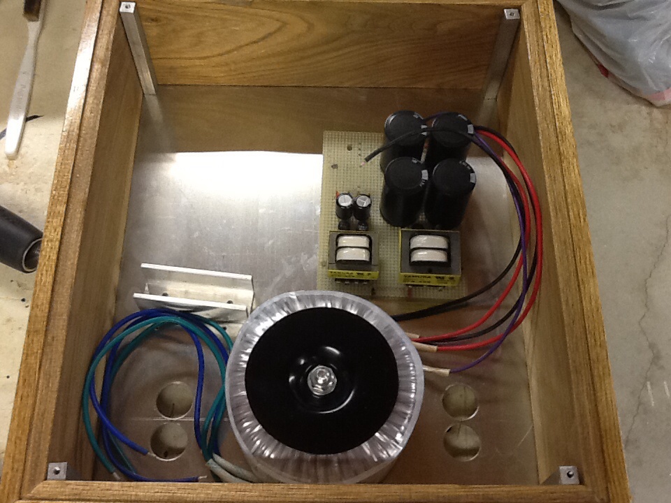

Hi Botte
Look promising 😀
Your wood frame is good job and 12V supplementary for LSK nice !
What be finalised amp ? Keep secret ok i wait .
Good luck 🙂![]()

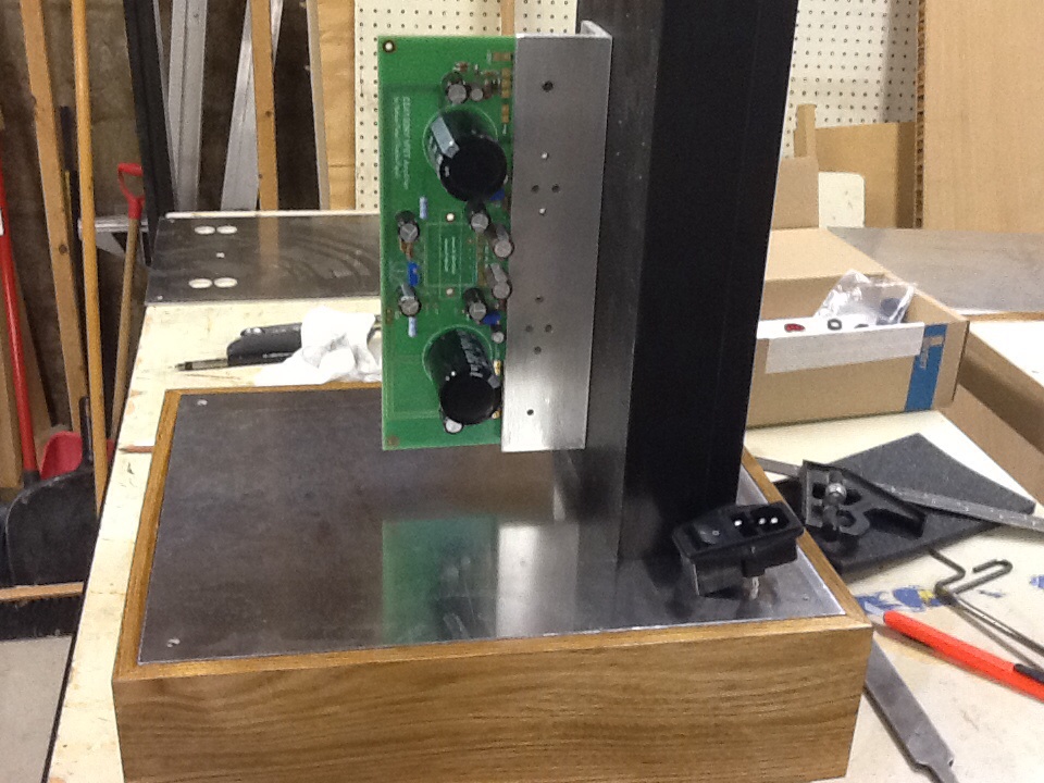

The extra 42 volt supply is for an optional LSK front end to the CSX1. I will see how it sounds in the system and then determine if I need the extra gain to help me balance with my subs. I guess I could just turn down the subs, typical engineering, always adding complexity where it's not required. 😉

The extra 42 volt supply is for an optional LSK front end to the CSX1....always adding complexity where it's not required. 😉
Hi Botte
42 volts for LSK front-end ??

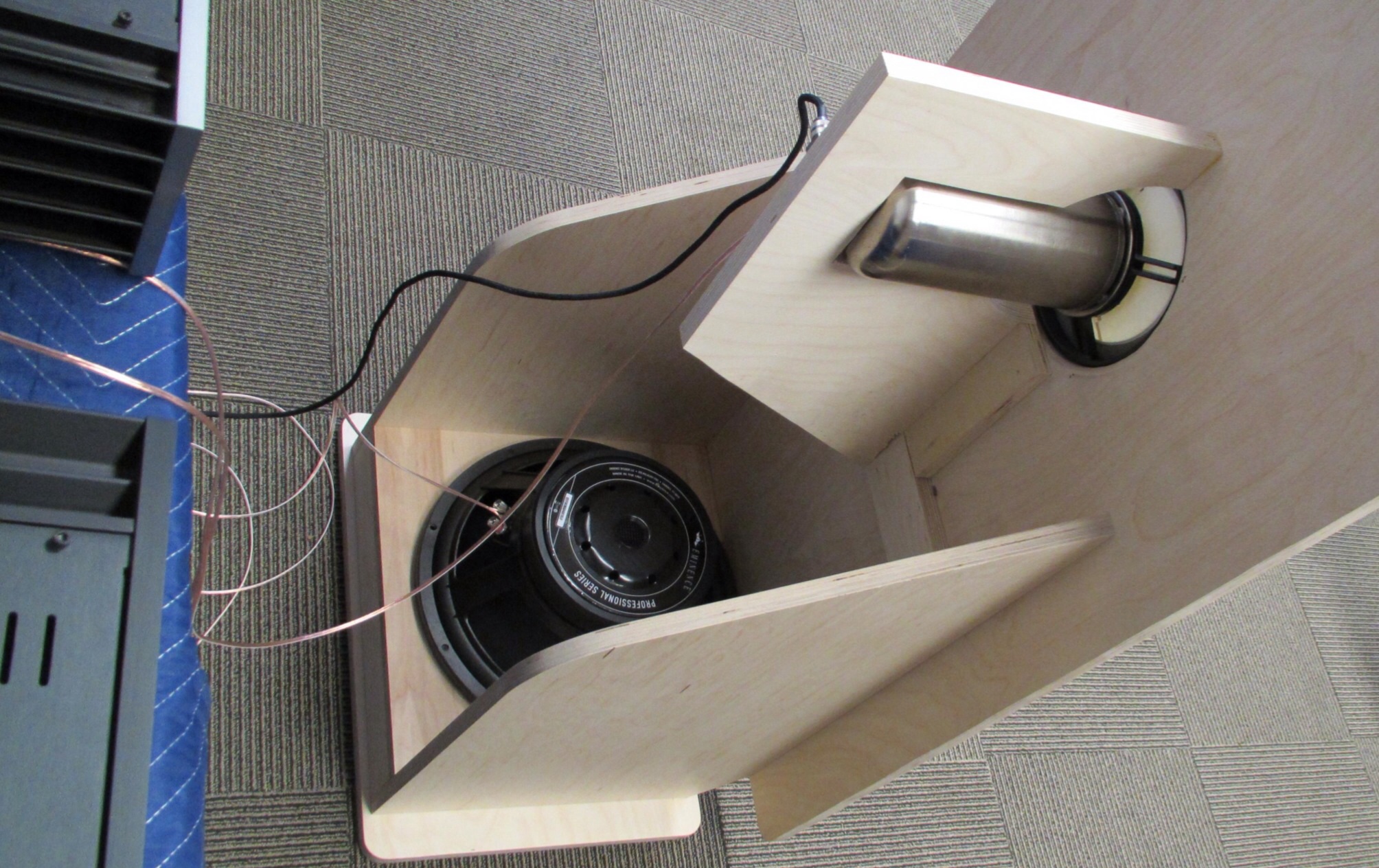

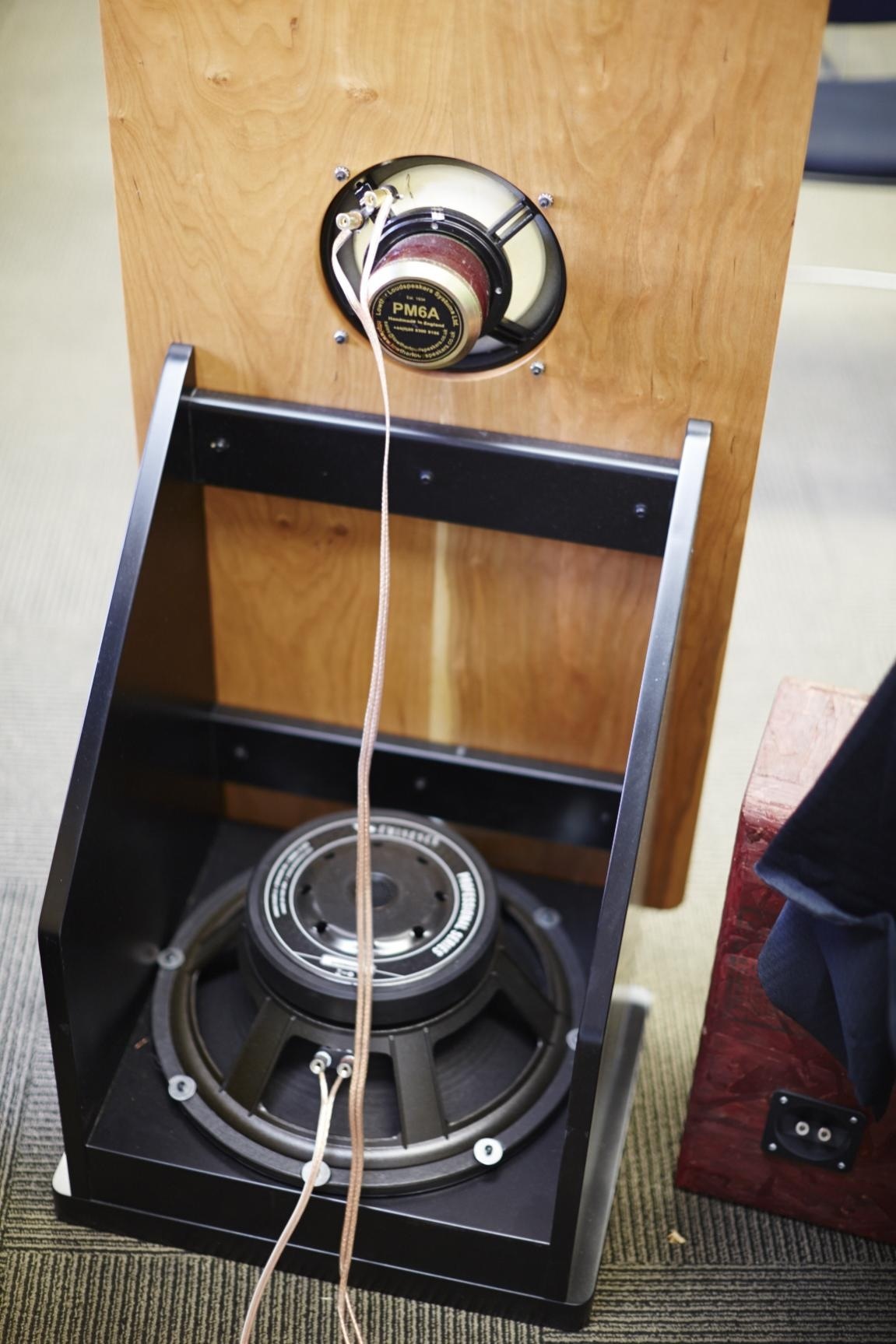

I remember Papa show on BAF his biampified configuration with Eminence sub woofer drive by FirstWatt amp and Lowther PM6A alnico drive with Sony Vfet amplifier. Woow i am impressed by huge long magnets like show on photo. High efficiency about 100 dB is the key.

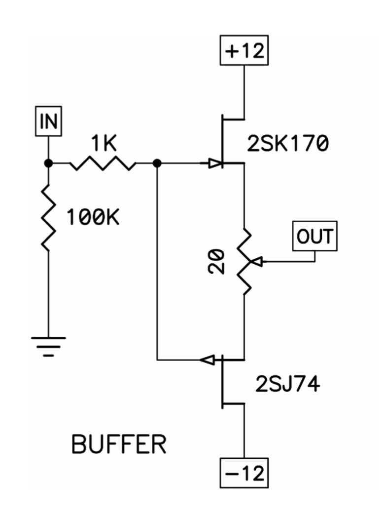

Buffer or not , CSX1 or CSX2 , Jensen transformer configurations , many parameters to have fun.

,,,,,,,,, Lowther PM6A alnico ...... Woow i am impressed by huge long magnets like show on photo...........
while A in designation certainly is for AlNiCo , huge long magnets are FC , so - no AlNiCo
while Ahuge long magnets are FC , so - no AlNiCo
Hi Zen Mode and Diyers
FC what is it ferrite core ?
Thanks for clarification.
Oops i see open baffle photo with Lowthers at BAF
is PM6A silver wire voice coil, ticonal magnet ?
Anyway this " jewelry " wide range speakers are not 88 dB.
