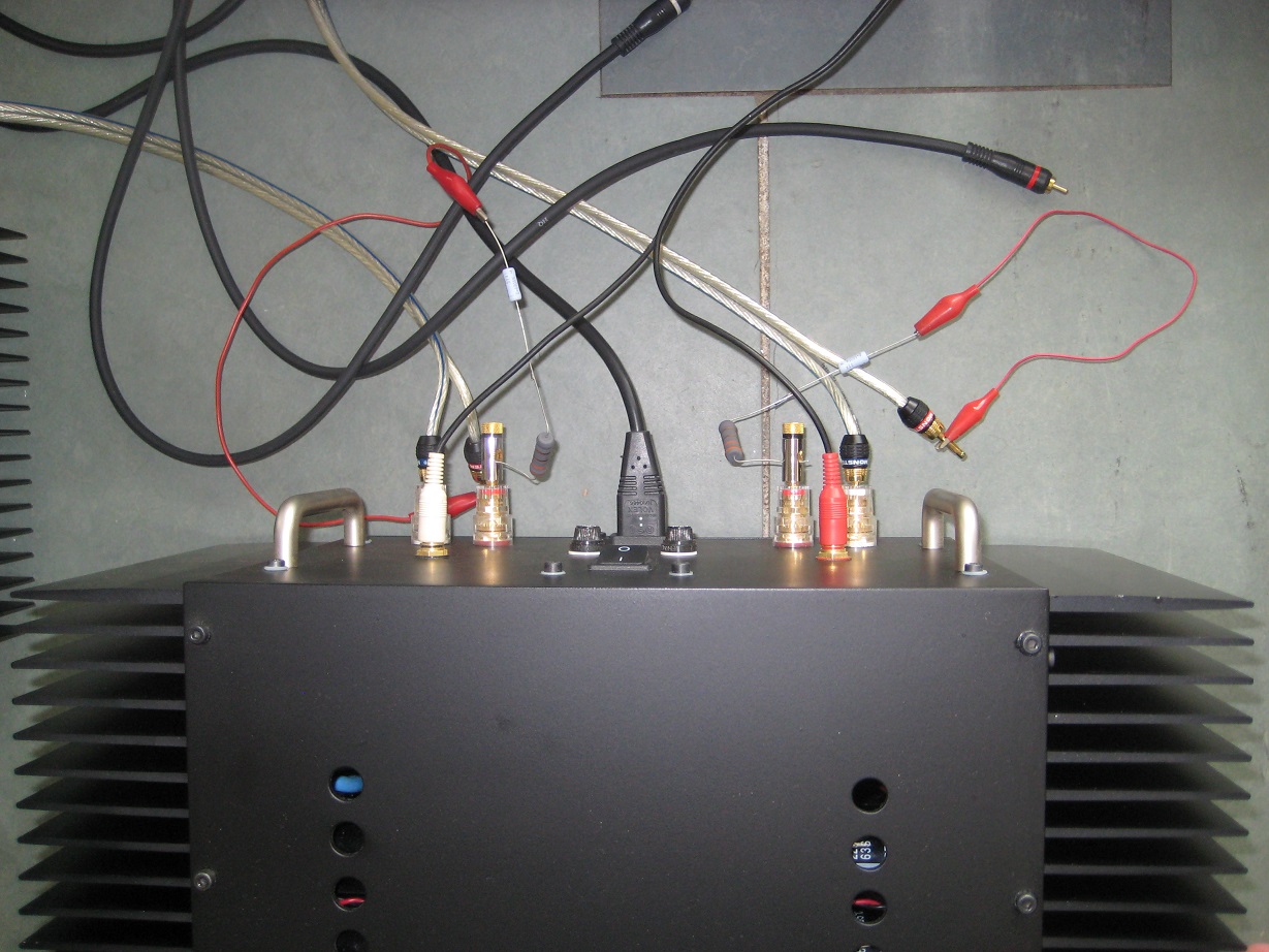

Hello WalterW. Please insert a 4 Ohm non-inductive power resistor between each power output of your stereo F5 amp and loudspeakers to compare with CSX1; which has an inherent 4 Ohm output impedance. Will this new F5 setup sound like your CSX1?Curious if there are more people finished with their build, and are listening to it?

I did what Antoinel asked me to do, see picture of crippled F5Tv3 with additional 4 Ohms resistor🙂
And I took some time to listen to the CSX-1, the crippled F5T and the normal F5T ( without the 4 Ohm resistor).
What I can say is that the difference in bass performance has clearly to do with the higher output impedance of the CSX-1. With the 4 Ohm resistors I get equal bass performance with CSX-1 and F5T. Bass is woolly and more boomy that way.
The 4 Ohms didn't seem to make much difference for the rest of the frequency spectrum.
The CSX-1 still has a different sonic signature than the F5T.
The F5T is accurate, easy, powerful, but a bit dull, flat. The CSX-1 has great musicality, sparkle, bright in the mid, high-mid range.... So pianos, guitars, horns, strings they all sound very good.
It is just like the good old 'loudness button' on an old amp is turned on.😀
Maybe the SIT is making the difference here...
Still very curious for other builders comments.....😉

Hello WalterW. I am glad to read that you have a subjective comparison at ~equal output impedance of the amplifiers. May consider repeating the experiment with diyF6; which will encompass the two similar variables of 4 Ohm output Z, and a Jensen transformer like in CSX1.
N.B. The 4 Ohm power resistors in the pic appear to be low wattage; suggesting that may need to use a much higher wattage ones for improved subjective answers..

I know the resistors are small, but non-inductive 😀 After playing one Coldplay song with a lot of bass, at a fairly high volume, I couldn't touch the bigger ones🙂
Today I repeated the whole sequence and outcome is the same.
