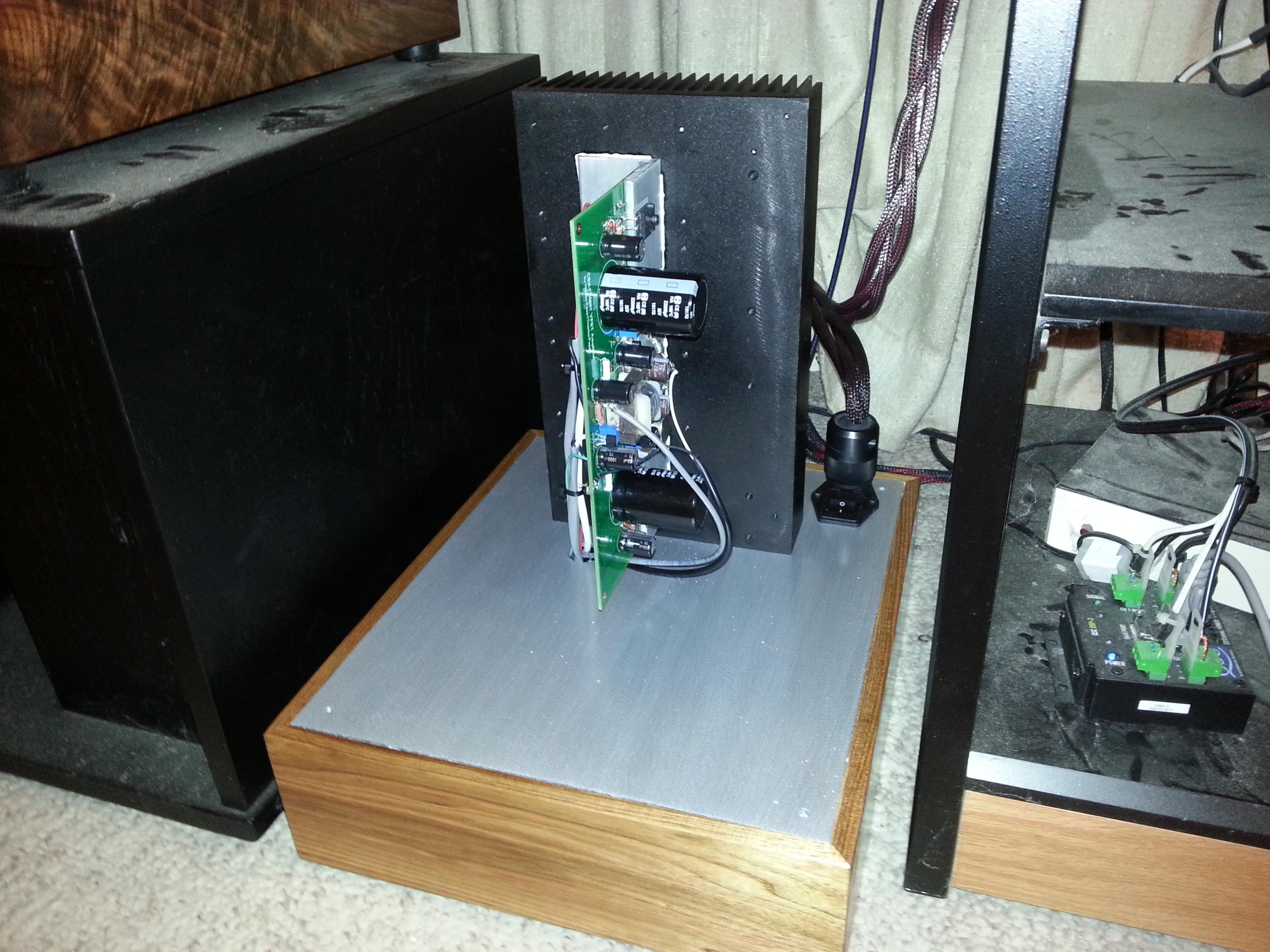

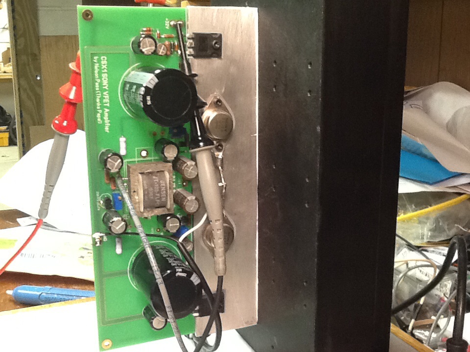

First channel is up and running. Looks like 3.2 gain. 🙂

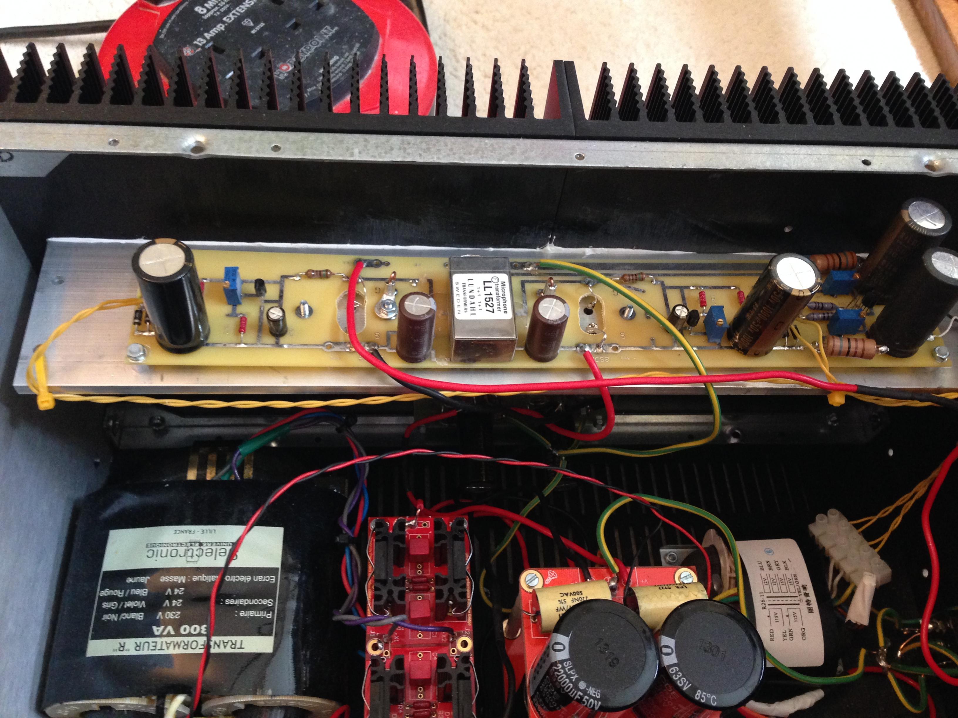

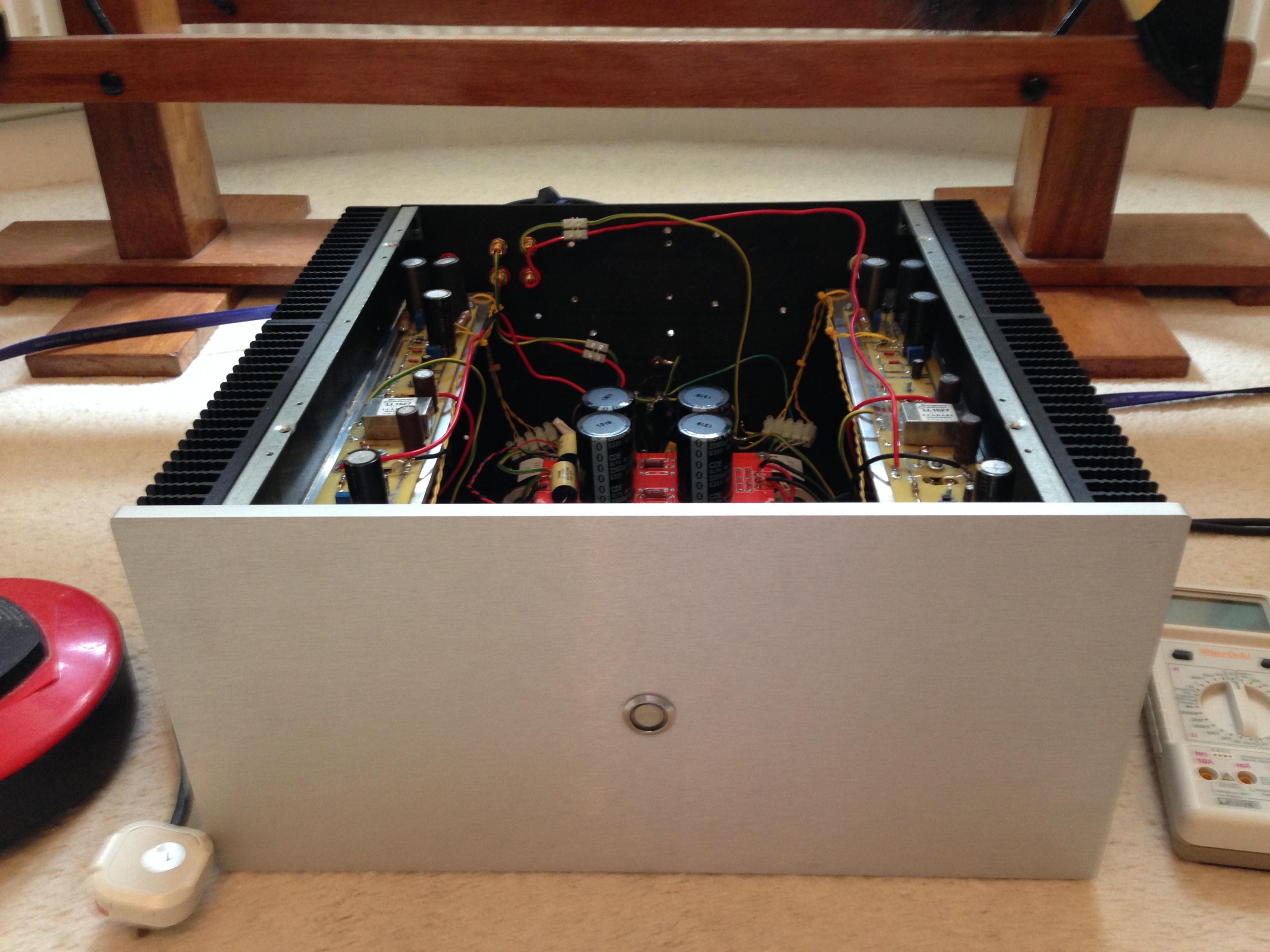

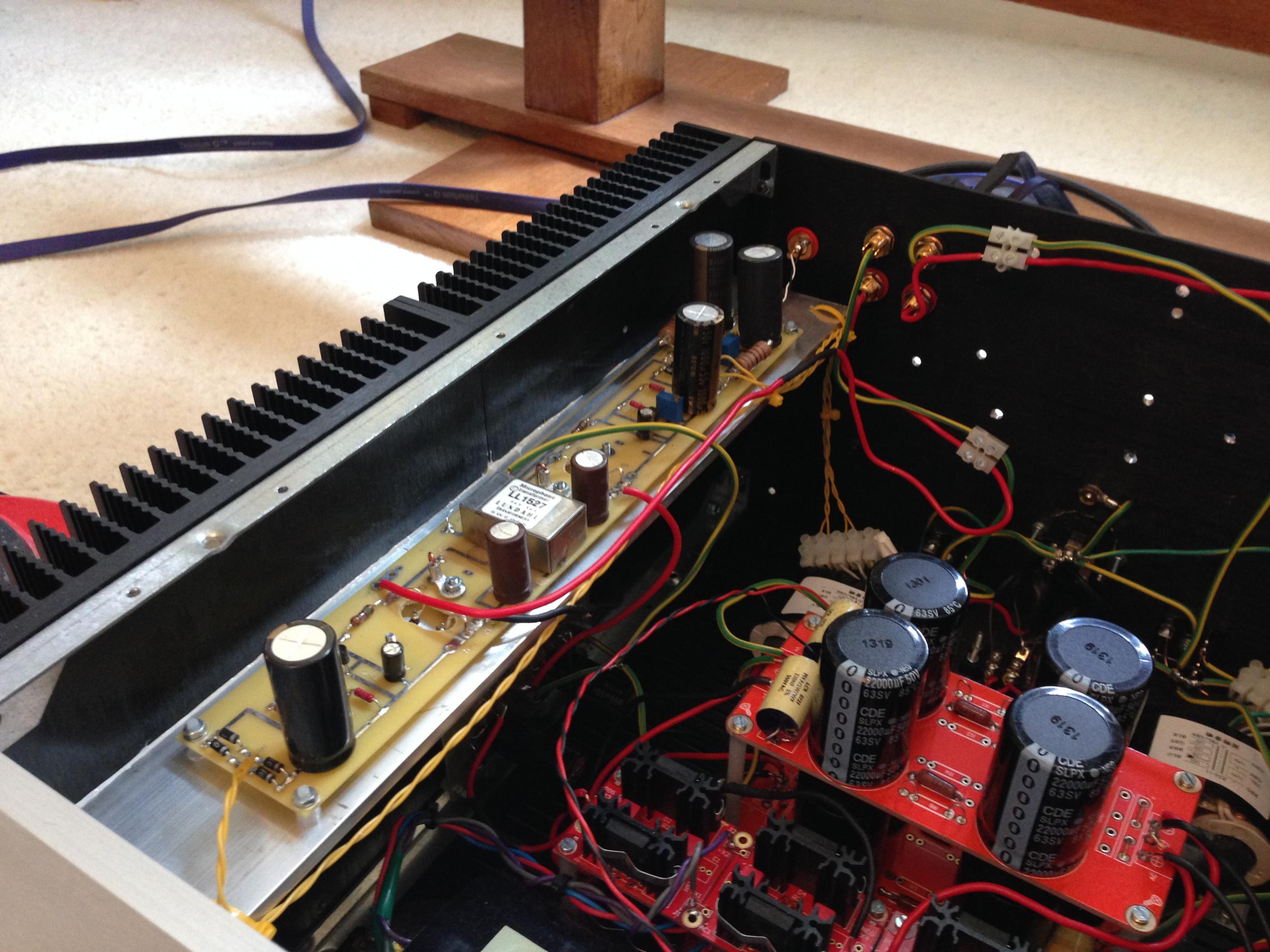

Almost finished rebuilding the amp after all the problems that I had exterminating P channel VFETs.
I had multiple further issues as I went along, 1 of my Cinemag transformers had a short between windings which meant the 2SJ28 bias on one channel was flowing to ground. This wasn't really picked up when using the LM317 bias regulators as they can supply a fair amount of current - enough to ruin a 30VA R-Core mains transformer! When trying to bias with the TL431 I couldn't do it as the circuit was drawing all the current that it could supply and this was running through the 3K3 resistors and dropping the voltage. This is now the stock CSX1 circuit with IRFP240/9240 main regs and TL431 bias.
Hopefully the problems are all in the past. I now have both sides up and running at 1.2A to be on the safe side. Plenty of time to push the bias higher in future. I need to put new speaker protection in (blew the original speaker protection boards somehow too) and tidy up the wiring, but other than that and upping the bias it is pretty much done.
Oh I need a new rack to fit it in, but I haven't mentioned that to the wife just yet 😉
How does it sound - very nice indeed. My perception may be coloured by the painful process building this amp has been (all the blown 2SJ28s, the bias, the R-Core xformer, the shorted Cinemag xformer etc, etc). It is absolutely quiet, no mechanical hum at all and I cannot hear any circuit hum with my ear next to the speaker cone.
I have a weakness for female vocals, and there I could not be any happier! Really a joy to listen to. Maybe the bass is not as taught as my F6, but I can always bi-amp with a B4 DIY and some FAST type speakers in future - definitely have not mentioned that to the wife at all...
I have added a few pictures too.

What are you driving the CSX-1 with, preamp ? Do you use the JFet buffer ? I think I see them at the back...but there are two blue trimpots....
Curious what are your voltages of REF1 and 2 for the 1.2 Ampere ?
The CSX-1 is driven by a Pearl 2 into a TVC and then this amp. I am using the simple 2sk170/2sj74 buffer as well in front of the splitter transformer. The 2 trimpots are for adjusting the pos and neg supply to the buffer with some big 1K8 resistors to drop the 24V regulated supply to between 14V and 10V.
I haven't measured the values of the bias voltages yet. I'll have a look this weekend and report back.

How is the LL1527 doing? Did you compare it to the Jensen?
Haven't compared to the Jensen and I had problems with 1 of my Cinemag transformers so I have not listened to alternatives in this amp. I use the Cinemag in my F6 and I have found it to be very good.
I do like Lundahl transformers though. I use an MC xformer of theirs as a step up in my Pearl 2 and I have used their tube output transformers before. In this application, after only a few hours of listening I have no regrets going down the Lundahl route.
It does have a higher primary resistance than the Jensons - ~42R instead of ~25R, not sure if this will cause me problems anywhere?
The LL1864 would be another alternative, similar to the LL1527 (but not physically a drop in replacement unfortunately). This is an amorphous C-core and is supposed to be very good - alas the price is too rich for me, a pair costs more than a 5U chassis. If anyone does try them I'd be interested in their experience!

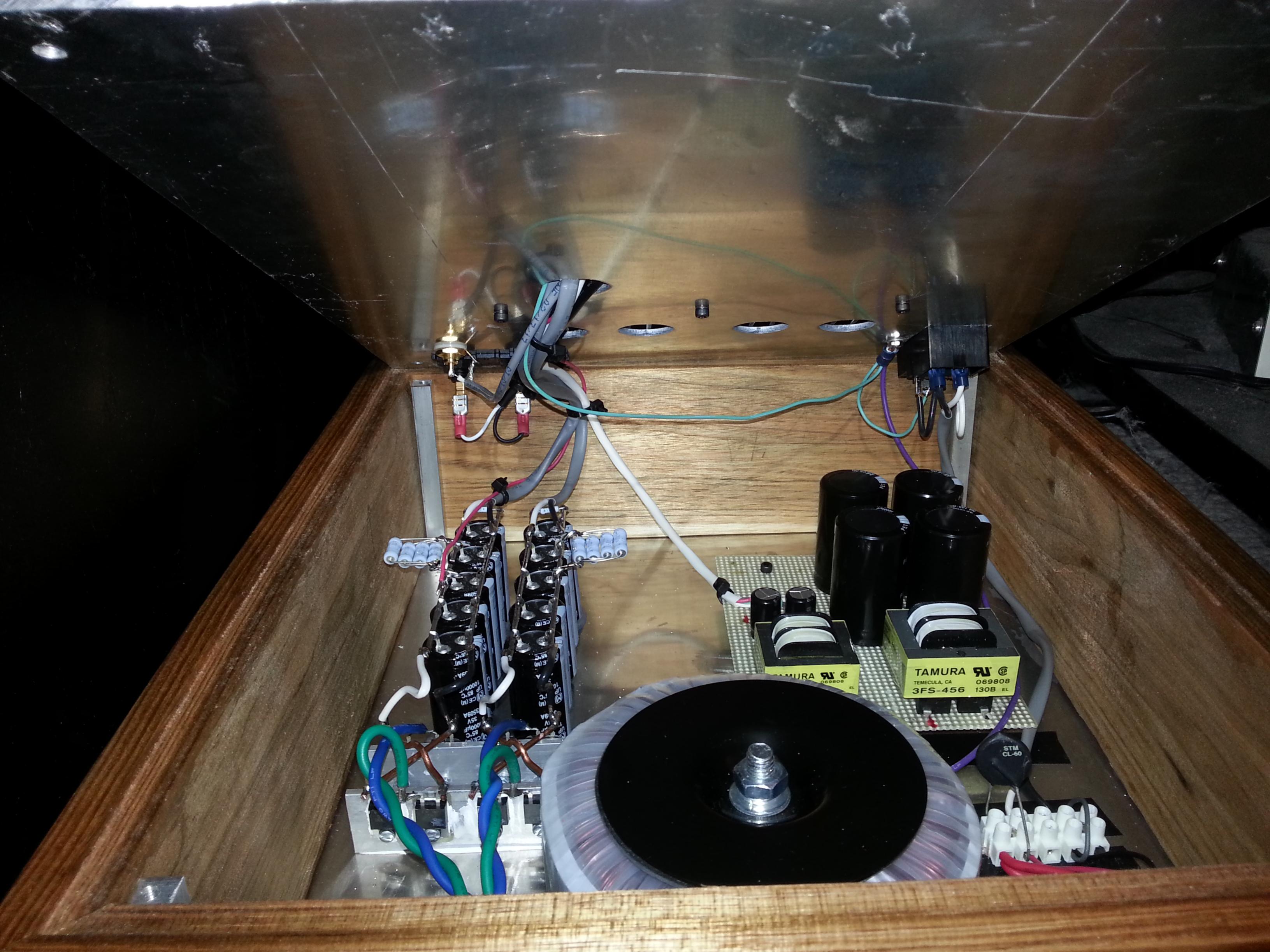

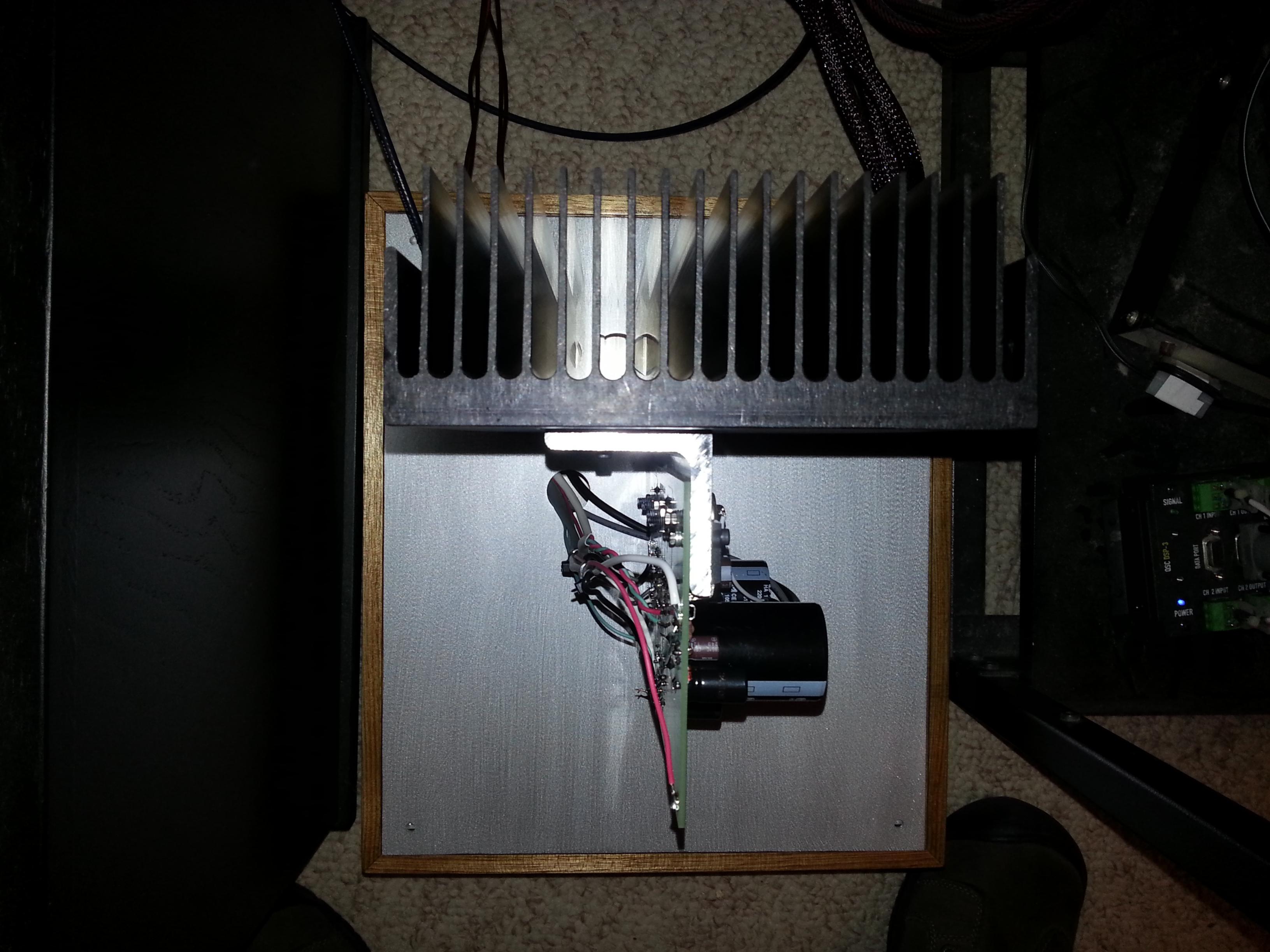

I finished my second channel and did a couple of hours of listening to the CSX1. This build uses the Permaneder boards; the boards worked flawlessly and were easy to implement using the Jensen transformers. While this is a new amp and needs breakin time, it has a harmonic signature similar to my 845 PP transformer coupled DHT amps, very open and airy. In comparison to my F6 (R100), it’s less controlled on the bottom and more pleasing to listen to overall. I’m using horns so I’m not driving it very hard, your mileage, with low efficiency speakers, may vary 🙂
