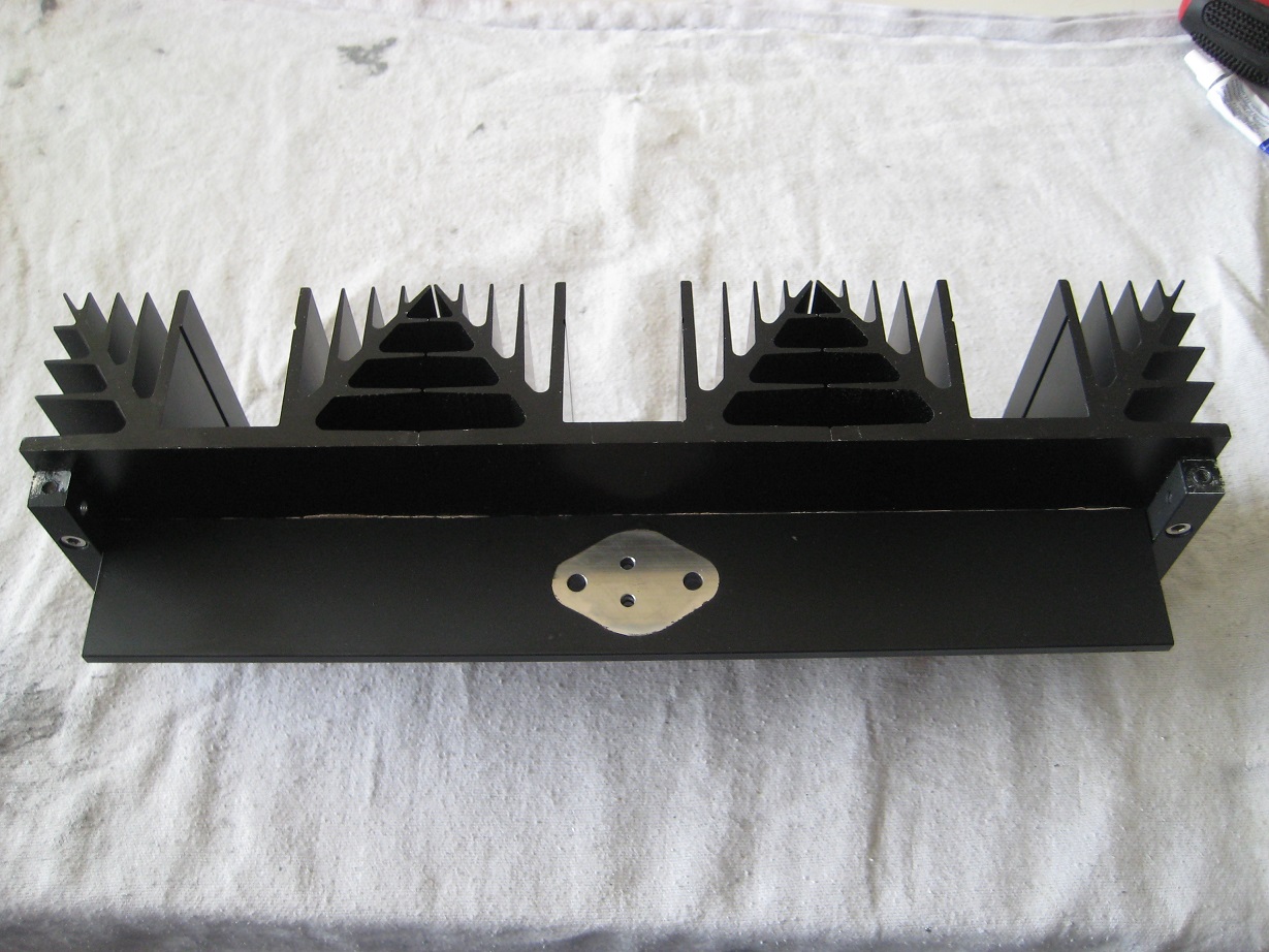

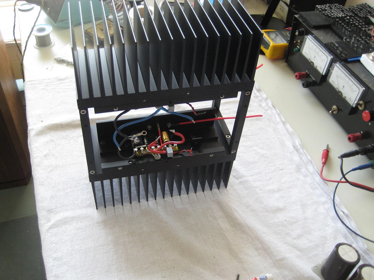

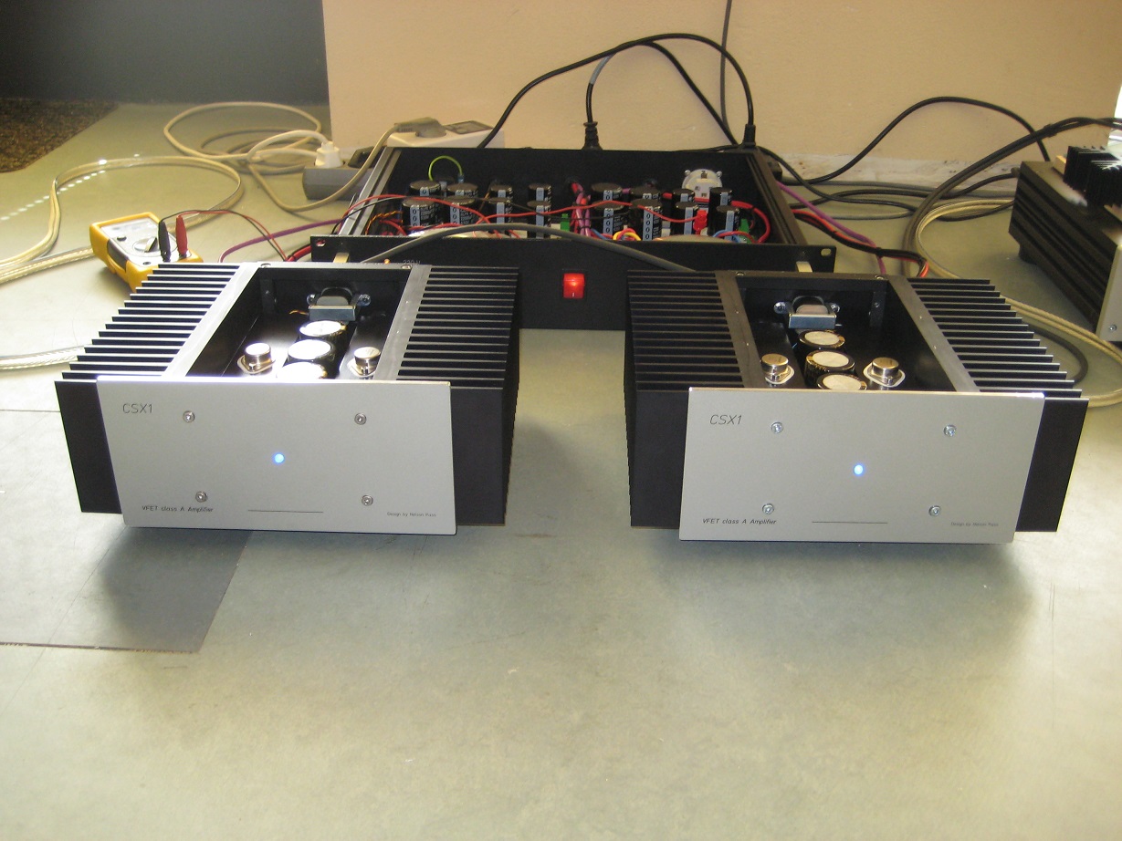

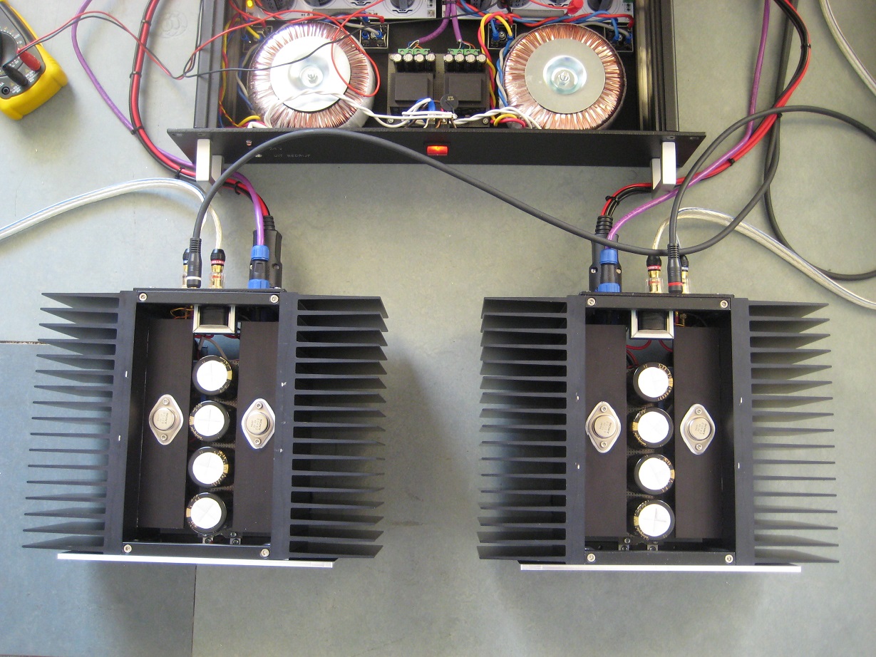

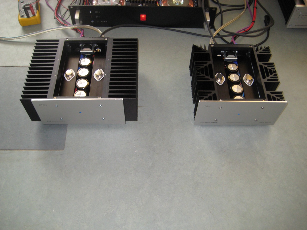

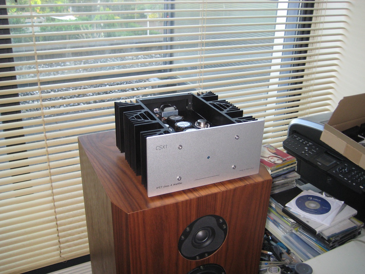

I'll post some pics of my CSX1 with new bigger heatsinks. Two SK88s and even 3 SK88s didn't do the job.
These Austerlitz KS 216 are expensive but excellent heatsinks. Baseplate 15mm, 0.4K/W a piece. Heatsinks now become max 46C and VFETs 61C on top. I'll settle for that.
