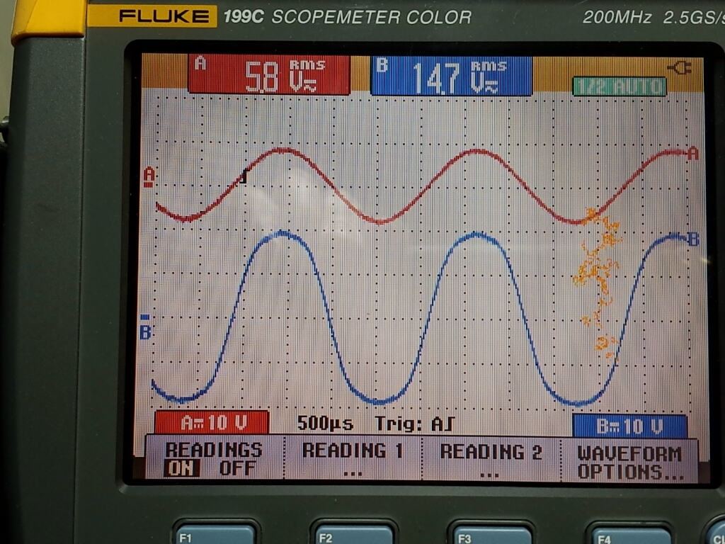

Walterw, i have done three circuits of this type and ever with voltages in this range. Try change transistors, or readjust all again from zero very slowly...
I used three sets of transistors, first was with KD33 and KF33 type and others with KE33. Try using other set of transistors.
I don't want to try another set....lots of work😀 Maybe the 2SJ28 is defective or out of spec ...
Maybe this explains my low gain ?
When you finish the other channel you can compare. If you can get an oscilloscope and simple function generator you can see how works. Have you many 2SJ28 and 2SK82?. Amplifier begin to distort equals between positive and negative power rail and round 17-18V, more or less. See the photo. There is not many elements that can fail.
Good luck
Good luck
Thanks Jama, I looked again, and I think I can replace the VFET's pretty simple. I'll let you know the results.
