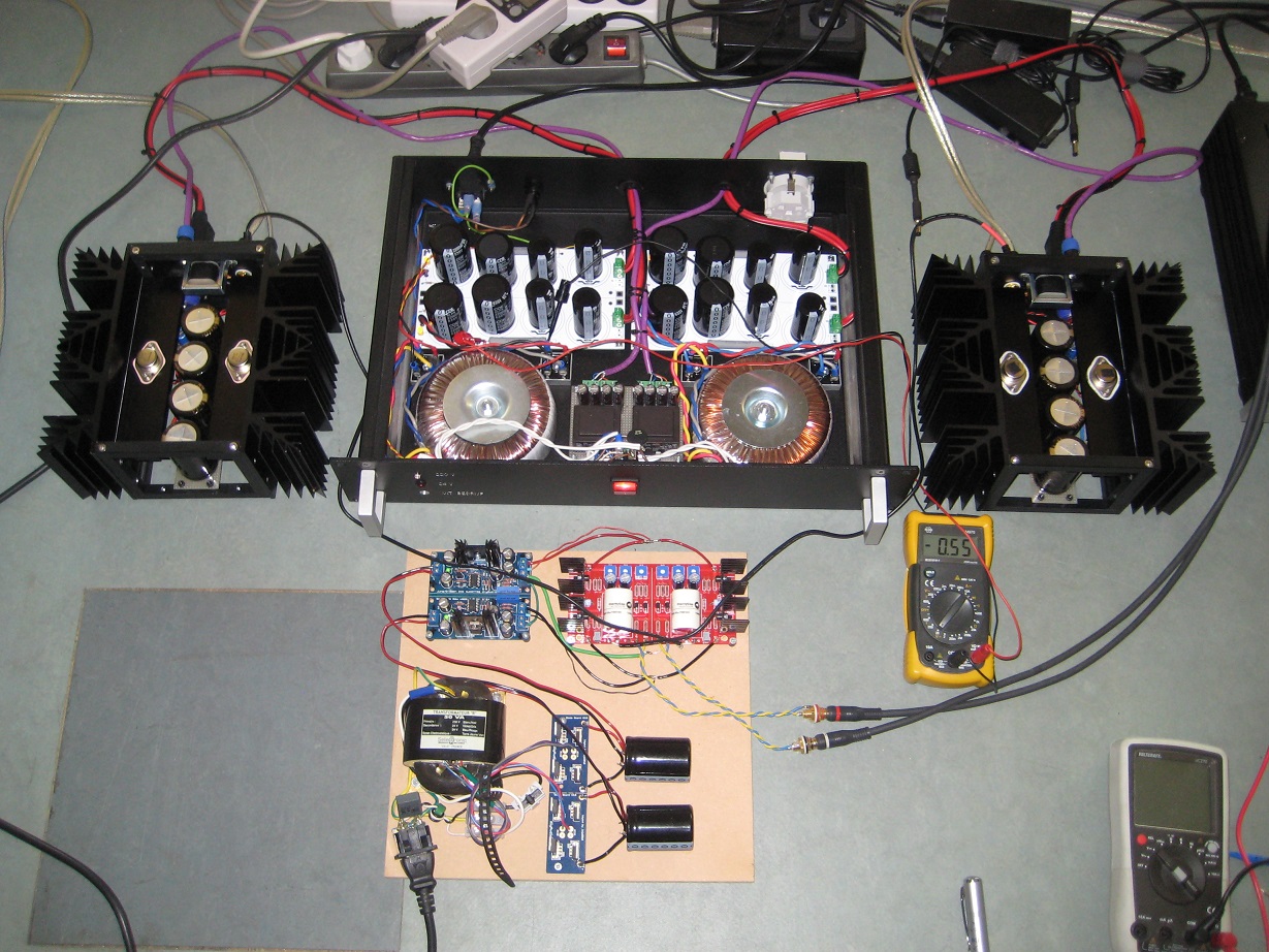

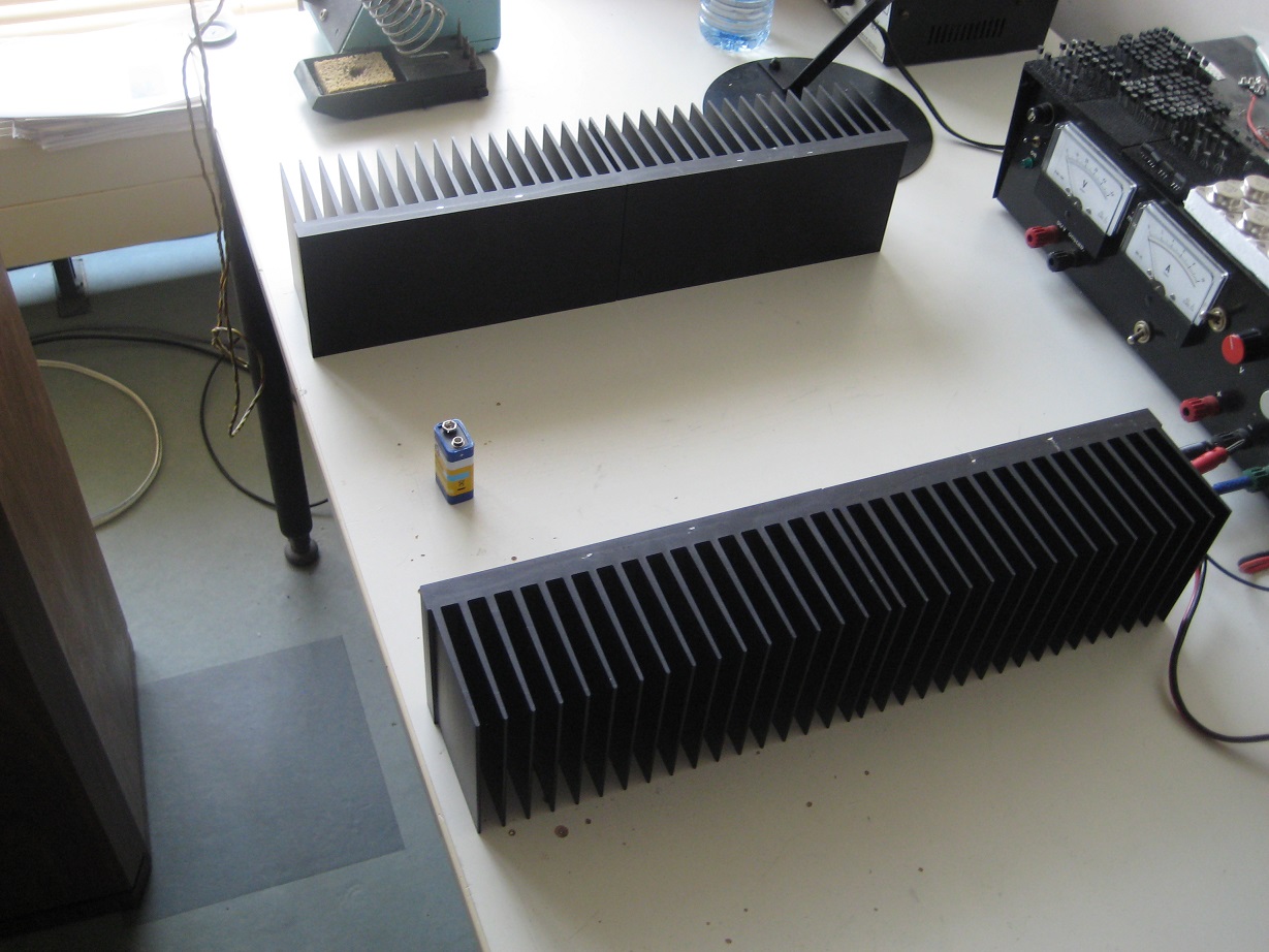

One channel per side. Imagine in the pic there are two units bound for one 3mmX30mmX200mm copper plate, with a kheratec between the Vfet and the copper plate This plates are common here on Europe like standard in construction of electrical distributors. They are really cheap.
RS sales SK88 in 8 € each. They are SK88 in 1000mm long, for industrial sales, is good because you can cut the size you need. Getting one of them you have enough for a 0,4 K/W with 20cm long. I tried in get here on europe but finally I can't.
Thanks dady, I understand. But for a final version I will use these heatsinks: they look even nicer.

Today I finished the second channel of the CSX1 and have been listening to it for two hours.
It sounds.... different....very, very detailed in the mids, big soundstage. Very good control and details of frequencies under 80Hz, amazing! It surprised me, a test tone with 34 Hz made my whole room shake....
I think this one is even more detailed than my Aleph J 😱 But I have to do 1 on 1 comparison.
Highs are not so pronounced, but they are there.
There is a lot of coloration, especially in the mids and with the BA3 as a preamp in front of it. Is that the third harmonic content I'm listening to?
The amp really has a sound of his own and is easy to listen to.
Gain is higher then I earlier reported. I removed the 220 Ohm output resistors of the DCB1 😛
The bias voltages from the second channel are 6.4 and 9.4Volt, totally different from the other channel. So the VFETs I have, vary a lot.
When more people are building this amp soon, I'm curious what others will report.
I listened to it with the DCB1 in front and sometimes with the 'BA-3 as a pre' in front. Speakers are big 4 Ohm three ways.
