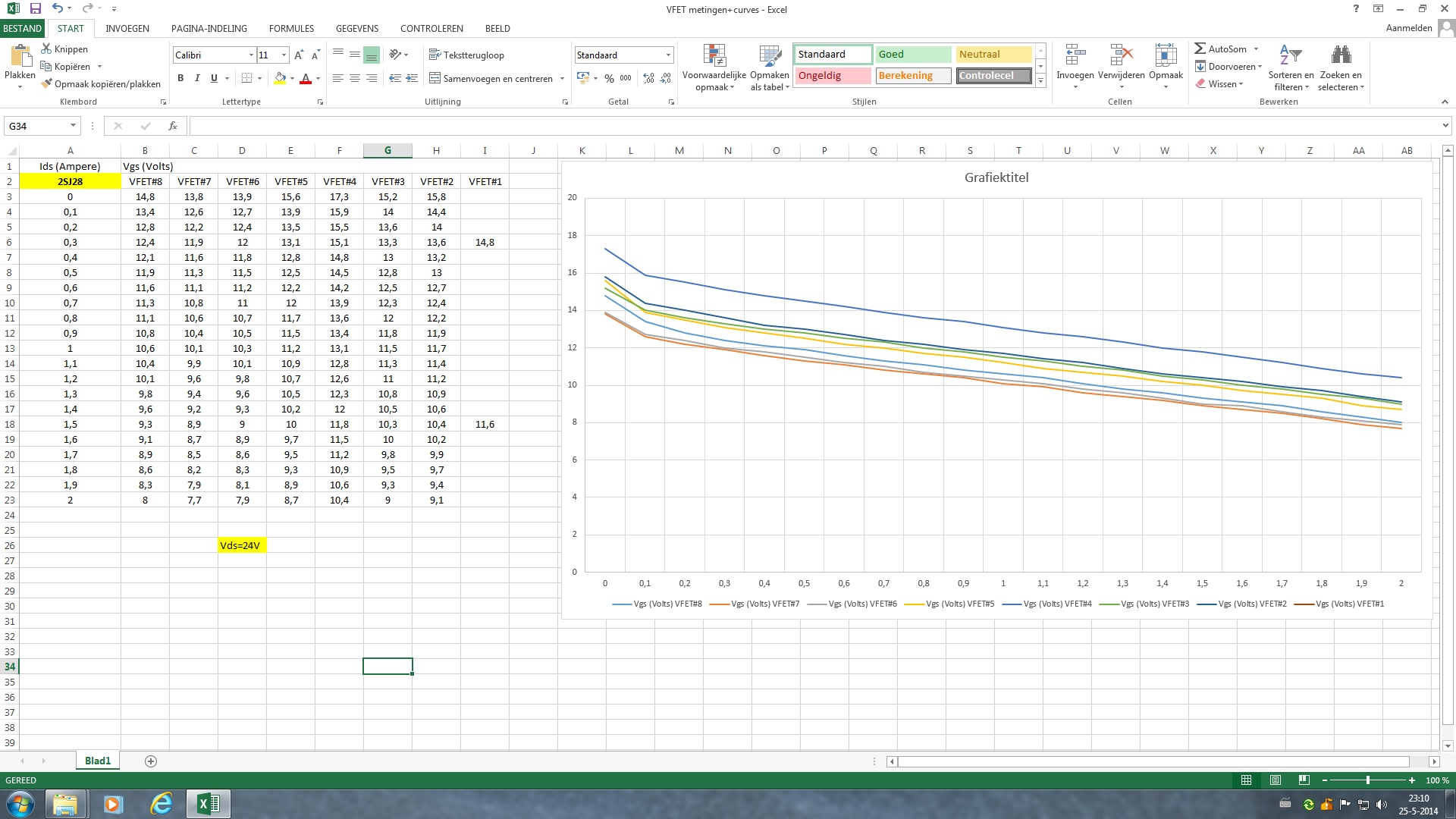

Today I measured my VFET's the 2SJ28 KE-33 @24V, and these are the results.
I will do the same for the 2SK's.
The one in my CSX1 with the strange, high bias voltage is the VFET#8, and it is almost the same as VFET#4. The voltages are higher but the curve and slope looks good.
Are they useful in the CSX1, or should I replace with another one?

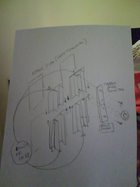

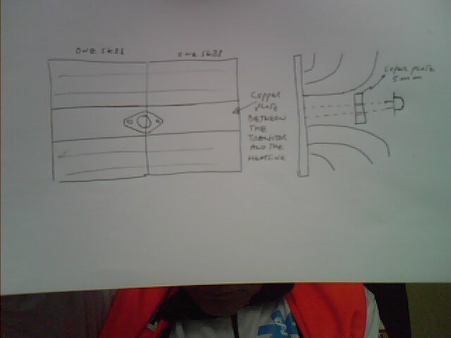

You have SK88, but connected with 5mm L aluminium one transistor for two heatsinks
You can put two sinks SK88 together, united by a transistor, so the transistor stay with one half in each. Furthermore interposing a copper plate 30mm wide by 5mm thick all along the two sinks (200m) this will improve the transfer of heat from the transistor to the plate and is about to be copper and bigger, will transfer faster and homogeneously temperature. The only drawback of this method is that you must completely change the mechanical structure of the amplifier.
The juncture Tº is 150ºC. Anyway the SK88 is recommended for TO3 but you not uses the normal way for the design of the design and actually the SK88 is one of the cheapest practical professional and handsome. Maybe you could make one amp with two Vfet for side spreading in the same number of heathsinks but with better transference, the other that you can do is putting the wings from to inside and put a fan inside from button to up.
Best Regards

Four SK88 for side and...
One channel per side. Imagine in the pic there are two units bound for one 3mmX30mmX200mm copper plate, with a kheratec between the Vfet and the copper plate This plates are common here on Europe like standard in construction of electrical distributors. They are really cheap.
RS sales SK88 in 8 € each. They are SK88 in 1000mm long, for industrial sales, is good because you can cut the size you need. Getting one of them you have enough for a 0,4 K/W with 20cm long. I tried in get here on europe but finally I can't.
