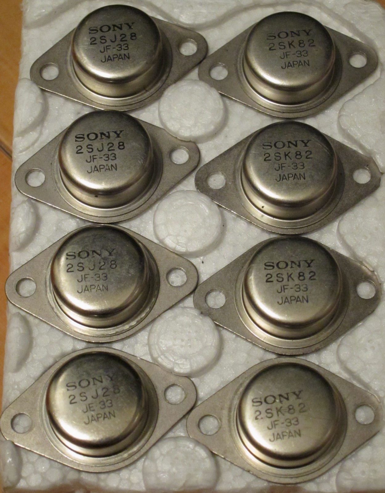

JE and JF parts
I would like to know if these JE and JF parts would work, and whether they will pair well with the KE and KF parts. 2 of the SJ28s are JE where the SK82s are JF, so I'm thinking of getting 2 pairs from CircuitDIY to match the JE/JF parts with KE/KF parts.
I will not build this amplifier anytime soon, as it's probably too complex for beginners like me (still working through Cordell's "Designing Audio Power Amplifier" book), but I'm stocking the parts first before they become unobtainium, so that I will have the parts to work with when I'm ready, probably in a few years time.

I am a beginner too. If you reproduce exactly the recommendations of the article, the same power supply, the same heat sink, If you follow the instructions on the starting the engine, tuning the bias, from low to high with care. Did you measure the Vfet with the multimeter? The first is: Between D and S must measure one ohm or less, inverting or not the same resistance, and with a diode probe, between G and D for one side, and between G and S must show the same measure like stupid and common diode. With this you can see if you have a Vfet in your hands.

Thanks, the test instructions are very helpful as I was trying to find ways to determine if they're authentic VFETs (got them from China, the source has so far been reliable but it's always better to check).
- Rds are measured to be between 0.5R to 1.0R, I got slight variations when measured from opposite directions, though I incline to think that's due to contact resistance (these transistors are quite old and have a thin layer of rust on their pins)
- For diode probe tests, Vf measured to between 0.43V to 0.49V, and like you described, values are the same from G to D or G to S.

You can use or pair them....Mr Pass Design does not need matched devices unless you parallel pairs.I would like to know if these JE and JF parts would work, and whether they will pair well with the KE and KF parts. 2 of the SJ28s are JE where the SK82s are JF, so I'm thinking of getting 2 pairs from CircuitDIY to match the JE/JF parts with KE/KF parts.
I HAVE MEASURED K60 VFET WITH jG 54 AND jf 24 AND THEY ARE PRETTY CLOSE Vgs...AS LONG AS THE LAST DIGIT OR RANK IS THE SAME..

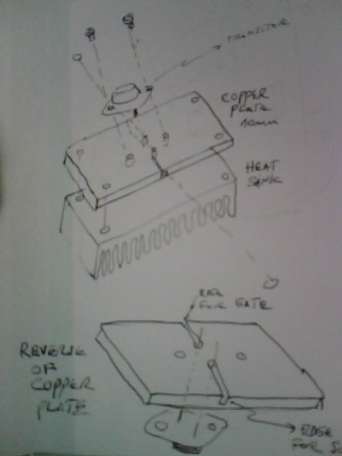

i know it will not be sexy but can't we use a piece of aluminium joint with the heatsink ( isolated by thermal pad) on the top of the 2SK82 to make a better heat transfer ?
if normal interface is substantial enough , not worth the fuss
if normal interface isn't substantial enough , make it properly

Don't Panic with the heat in the top of the transistor, the junction is glued in the plate that is used for stay intimately with the heat sink, I make a new draw that attached in this post.View attachment 423050

thanks , i will see the heat with my chassis , the summer arrived this week here with 38° celsius outdoor now , bad times for CLASS A 😀
