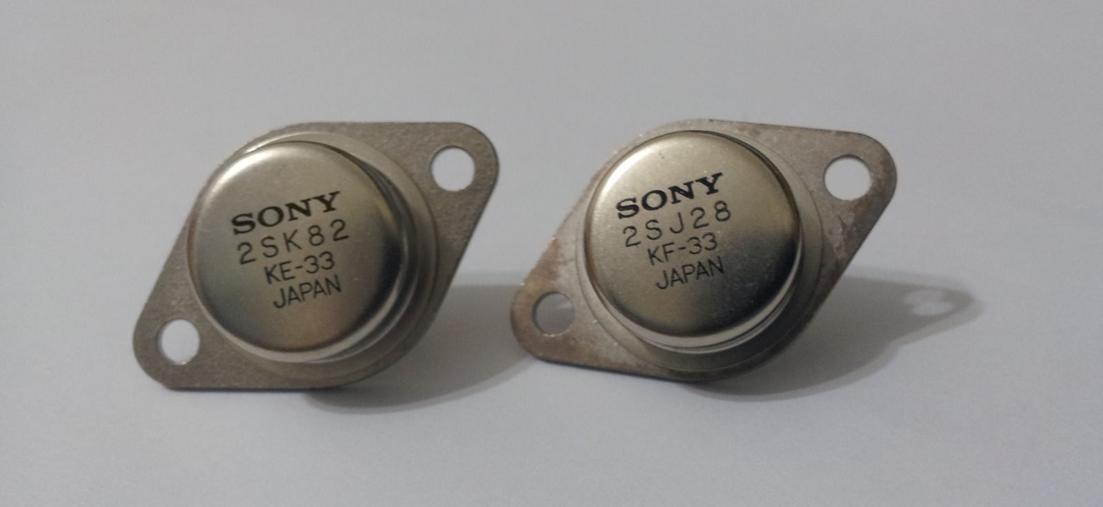

So it looks like Acronman only has pairs of 2SK82 KE-33 and 2SJ28 KF-33 left. I have not bought my 2 pairs yet (zero play money🙁) and I am just wondering if different ranked pairs will work with this design?
Have I missed the boat or will these still work?
Must I now beg some benevolent member who has extra for 2 pairs?😱🙁
Hey mac, what you think in make a tool for measure each vfet of the group follow by publications of the results and trying to close match them for the next project of Common drain?
I have four pairs. All KE series. But somebody with more experience could suggest some.
