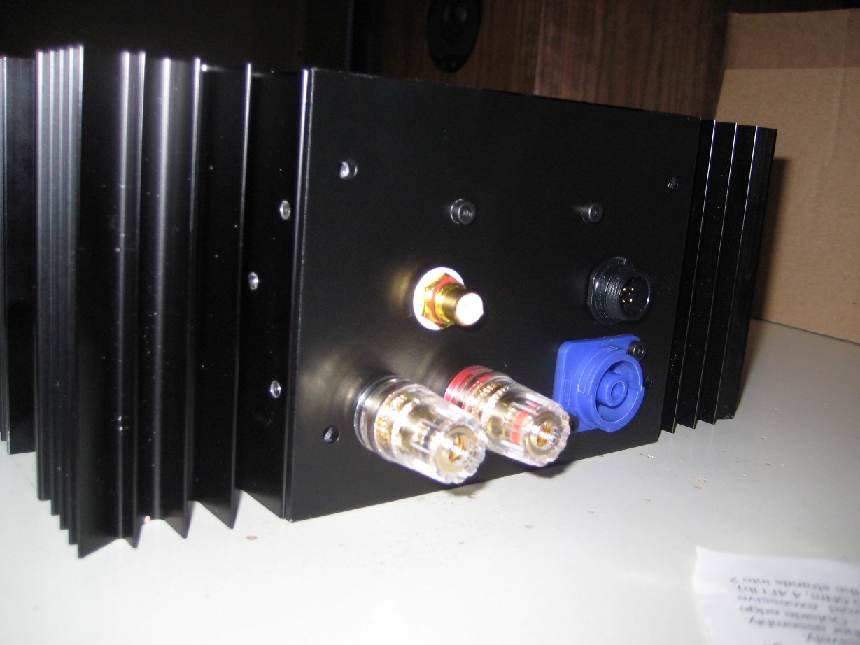

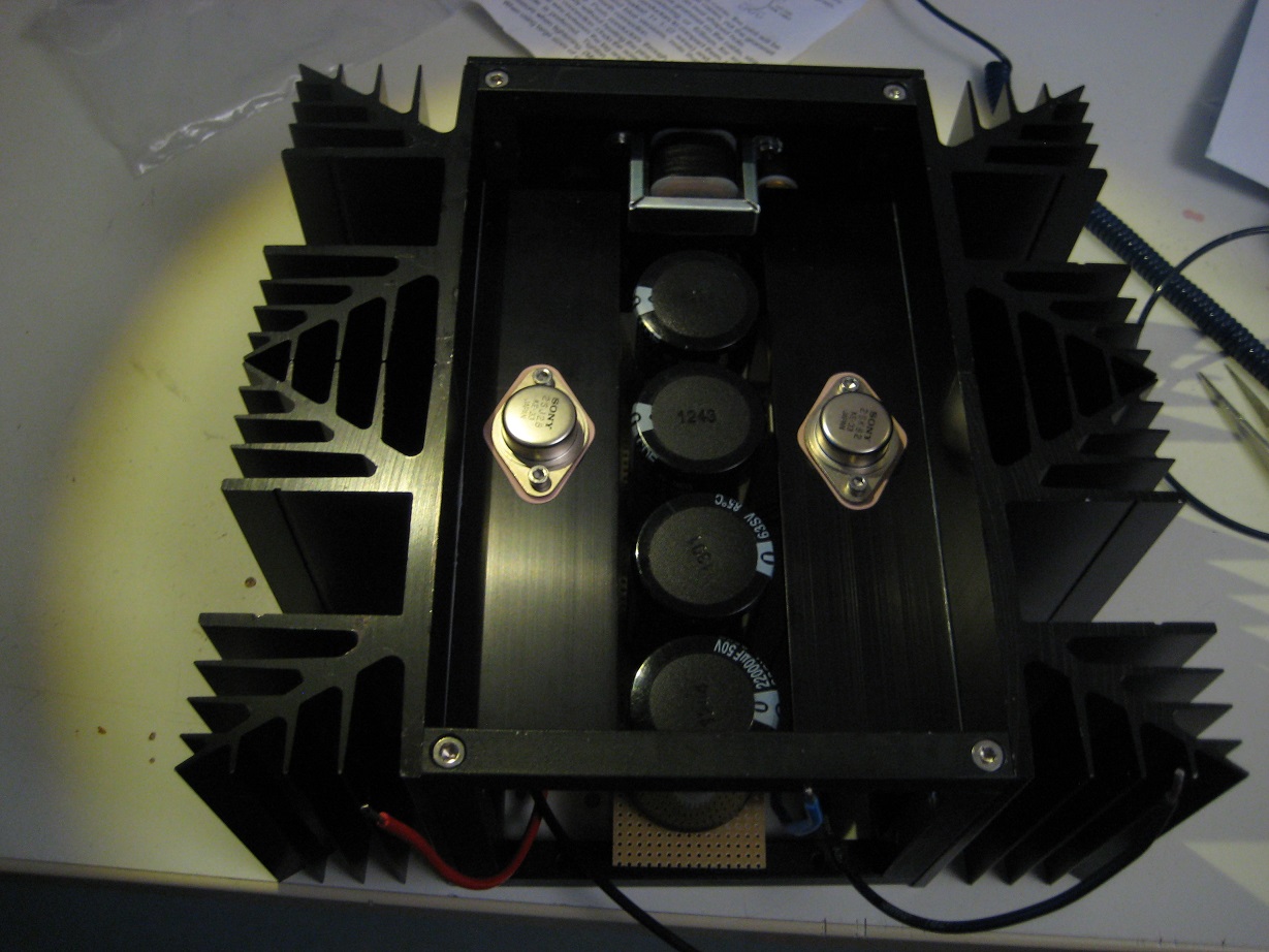

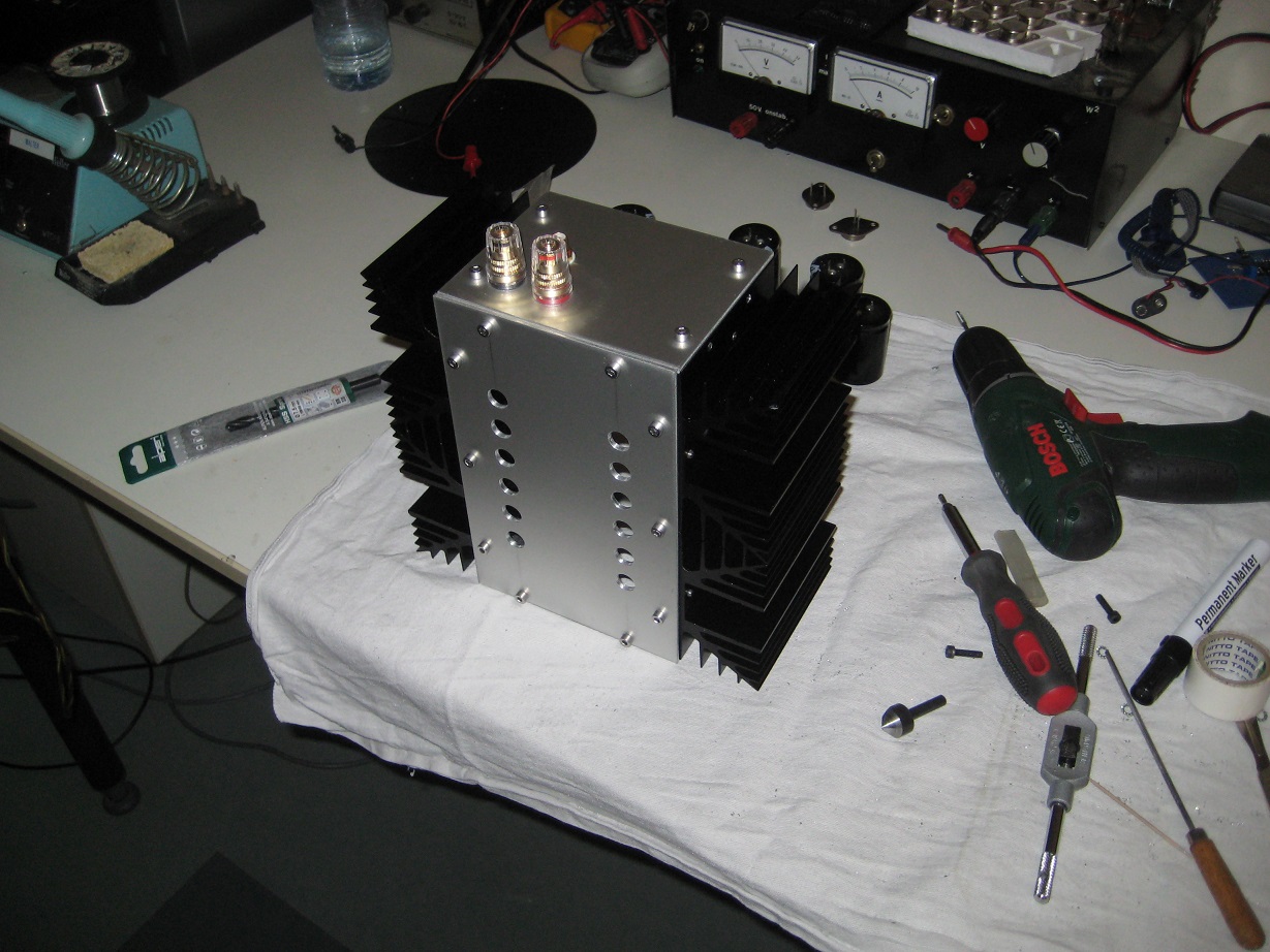

Almost one monoblock ready... see pics.
I tested the regulators positive and negative, and they seem to work fine, input around 35V, output at 2 Amp: 22.7 Volts ...bit low. Can I change the 3x 9V1 zeners to get a bit higher voltage.
At power up, the voltage slowly increases in about 6 seconds to full voltage.

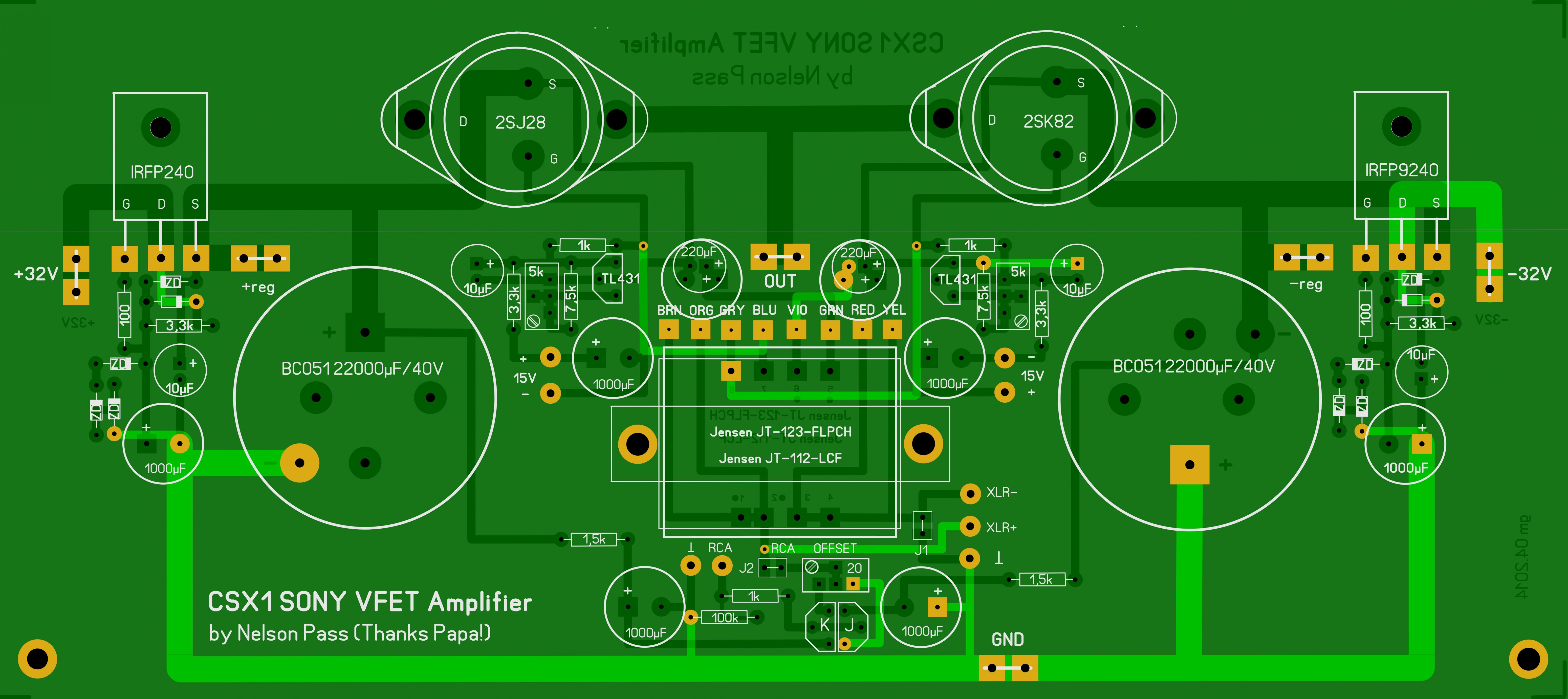

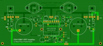

The actual price for a set (2 boards) will be around EUR 30 + shipping cost.

Yes. Not really necessay yet. The 2.2mm thick board is stiff enough.
Nice work. Pt 2, the Common Drain DIY version, is out for fab. I ordered
11 pairs of channels (I happen to have 11 pair of FW sinks drilled for 6 x TO-3)
Pt2 that is fabulous
Mr Pass for Common Drain Symmetric Vfet´s version how many pairs we need ?

I thought big caps after regulator could led to instability of the reg?

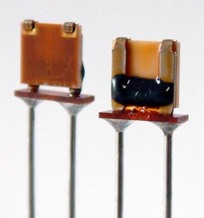

Thought about capacitors and resistors choice and wattage (biger)in signal path section....elna silmic, pio , teflon with naked z-foil , caddocs ?
http://www.vishaypg.com/docs/63140/var.pdf
Z-foil low noise Resistor
Maybe just diy with nice standard and tweek after ?

On proposed PCB 220uF cap in output stage maybe supplementary hole for little biger dimension be useful ?
true , when reg is based on NFB
this time , reg being simple follower and also of soft start type , decent cap bank after can't harm
Apparently also true of bipolars w/o NFB, although I have not personally seen it.
Fets, looks like you're safe...
